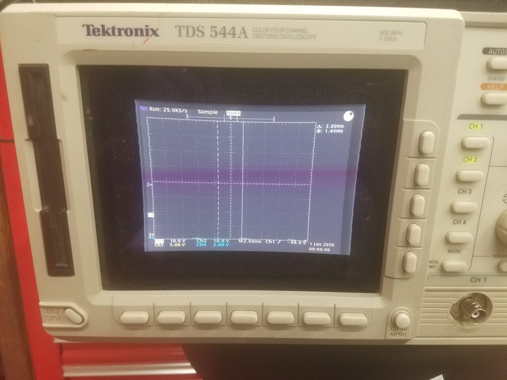

Turn it on odd the screen is shrunken..
Then went dim and now sounds like high voltage arc left hand corner? Thinking flyback?
I opened it up and disconnected the IDC for the CRT Board so I know it's in that can! Left Rear where she be arching..
I will open her up further tomorrow.

The 'A' series will almost surely need the caps changed and the
flybacks were known to go bad. You may be lucky when pulling
out the display board you will find a bad solder connection around
the flyback on the underside of the circuit board. The Nu-Scope
LCD upgrade seems nice, but I feel very overpriced. You can find
CRT driver boards on Ebay but beware of Chinese sellers. If they
sell you junk you have to pay to send it back which is more than
the purchase cost and then they won't refund your money anyway.
Parts from Test-Key are so overpriced it is nearly criminal!!!

Grinding and drilling on crack.  Then coat it with 2k glue.
I have repair  TDS744  flyback transformer with this methode.   It run stable.
Important: desolder all bad SMD eletrolytics, whatever it look good.  Washing of PCB is very neccesary, or  it break sometime down.  (i use dish wash detergent  & water)

A shrinking display can be caused by the EHT rising. It's possible that another failure caused excessive HV which shot through the insulation of the flyback and arced to the core.
The Dallas chips can be problematic to read in many programmers, but you shouldn't need to mess with those right now, IIRC the scope will boot up and work without at least one of them even there, aside from the clock they are used to store settings, reference waveforms, enabled options and other non-critical stuff.

I had a tv shop and I repair some fly back this way ,they didn't last too much 1-2 years,better procure another flyback.

Looking at that photo of the screen again, the fact that the image appears very bright and somewhat washed out also suggests the EHT has gone way high, I'm not familiar with how it is regulated in these monitors, thankfully I've never had to try to fix mine. Given the unusual NuColor display runs at a high field rate I'm wondering if the HV is separate circuit independent of the horizontal scan? If that's the case it might not be too hard to adapt it to use some other flyback transformer. I do love those NuColor displays, it's such a fascinating and unusual technology and it produces a very unique look, a sharp clear image as produced by a monochrome CRT with no screendoor effect of a shadow mask, yet in full color. There was only one other application I'm aware of where it was ever used, in a small studio broadcast monitor, I'd love to find one of those but they're quite rare.

Offline KG7AMVTopic starter
  • Posts: 379
  • Rhine_Labs
    • My Personal Blog
Re: TDS 544A Maybe Bad Flyback. (Crack Found) Need NVRAM Dumps..
« Reply #21 on: May 25, 2020, 11:16:33 am »
I think the boards are way to far gone!! Sad!!! But spent my budget and 3X's the amount of time allotted under the microscope!! Part Out the known Good stuff!!
