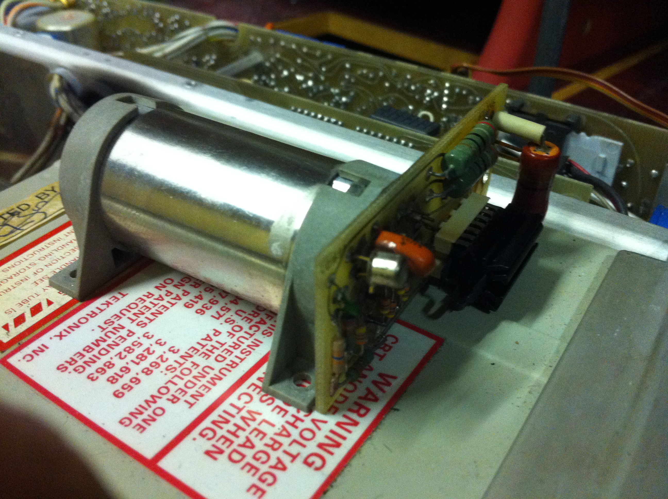

A couple of weeks ago I demonstrated how I repaired a 2445A that I had found. At the same time I also got hold of a 2445 which is the older brother of the 2445A. This one also includes option 5 (TV triggering) because it is from a television station.

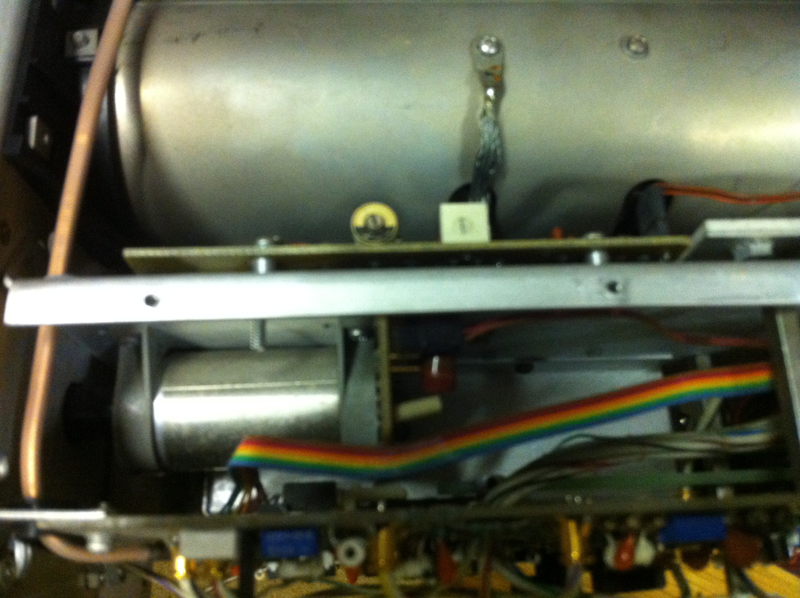

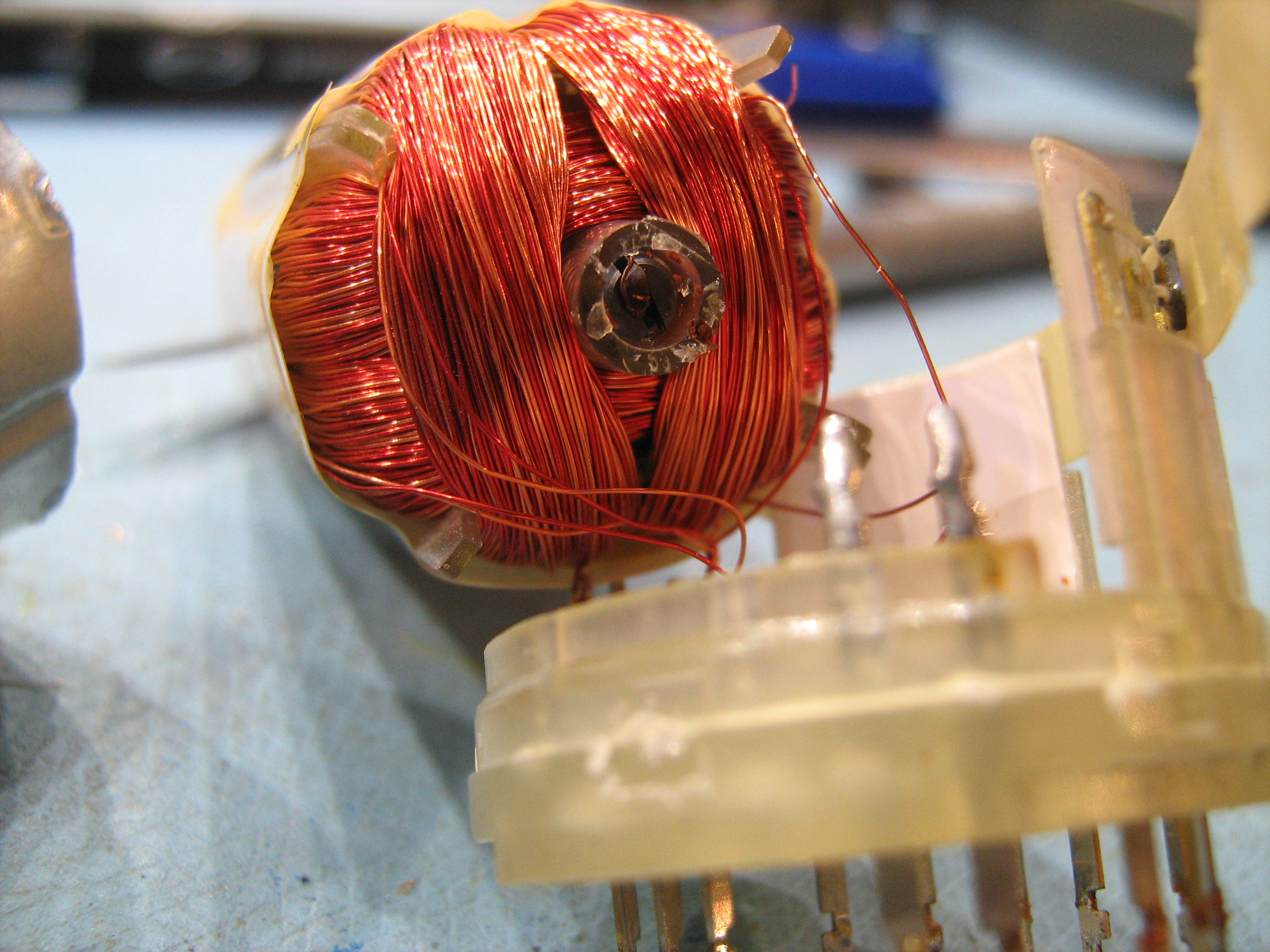

This 2445 powers up, but although there is a beam it is horribly scattered. The entire screen lights up dimly but it does respond to the intensity control. When I took the back off of it my heart sank when I discovered that the fan impeller would not turn indicating that the motor had seized. Unlike the 2445A, the 2445 does not employ a "PC" type fan. It uses a special type of brushless motor with hall effect sensors in it. The fan motor secured along with the capacitors on the power supply.
I got the fan assembly out.

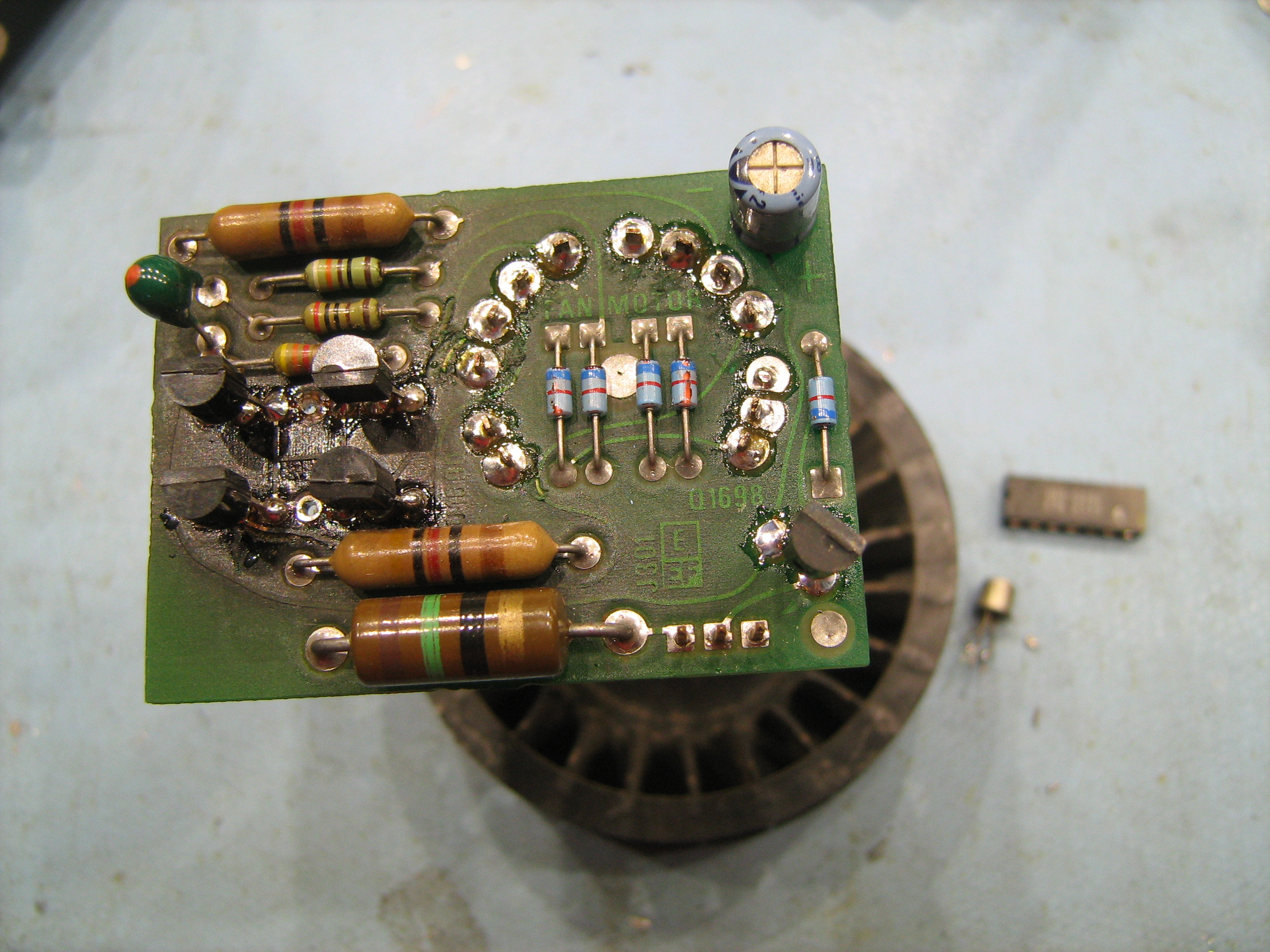

I then removed the motor and dismantled it.
Unfortunately, the shaft cannot be removed without unwinding the coils. I could have done it, but I knew of an easier way. Earlier in the week on my travels I had rememberd seeing a Tektronix 475 which seemingly had suffered a face plant at some point.
These use the same motor, so as this unit seemed to be loosing parts day by day, I revisited its last known location to see if the motor was still inside. I was lucky, it was still where I had last seen it and the fan motor was still inside.
So out it came.

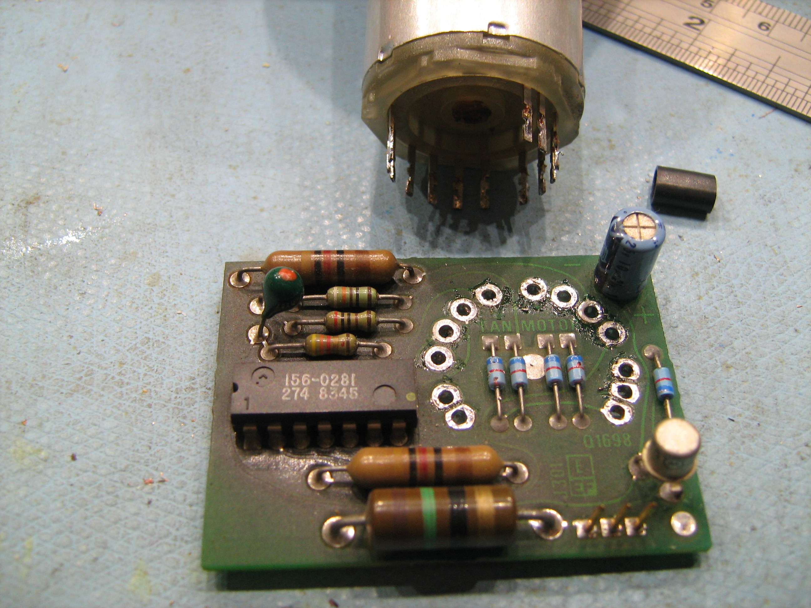

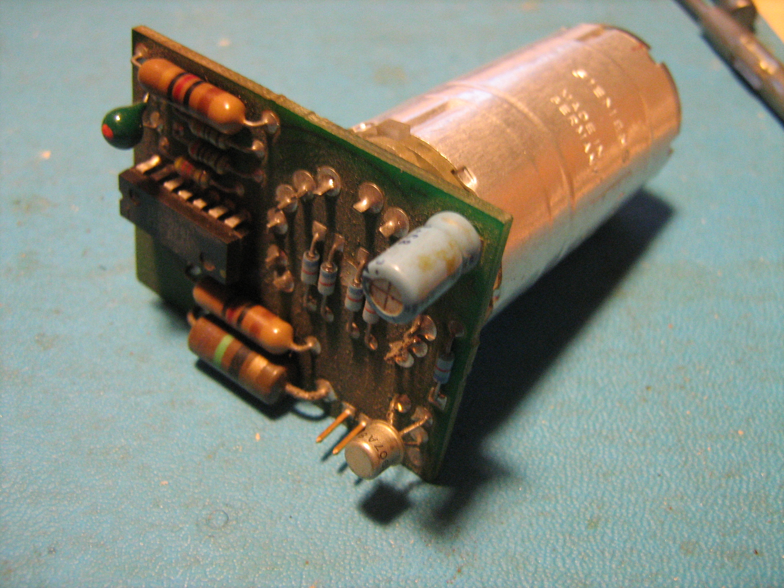

Back home again, I soldered the 475's motor in, but it would not turn. It transpired that the transistor array which is actually an MPQ2222 had one of it's transistors with an open junction and the 2N2907 can was also open circuit. the MPQ2222 had got really hot in its lifetime, probably more recently due to trying to turn a stalled motor. The heat had affected the PCB badly and although I was careful, I still lifted some tracks getting it out.
I replaced the 2N2907 with it's plastic counterpart and the MPQ2222 just got substituted with four PN2222's.
Once this was done the fan started turning.

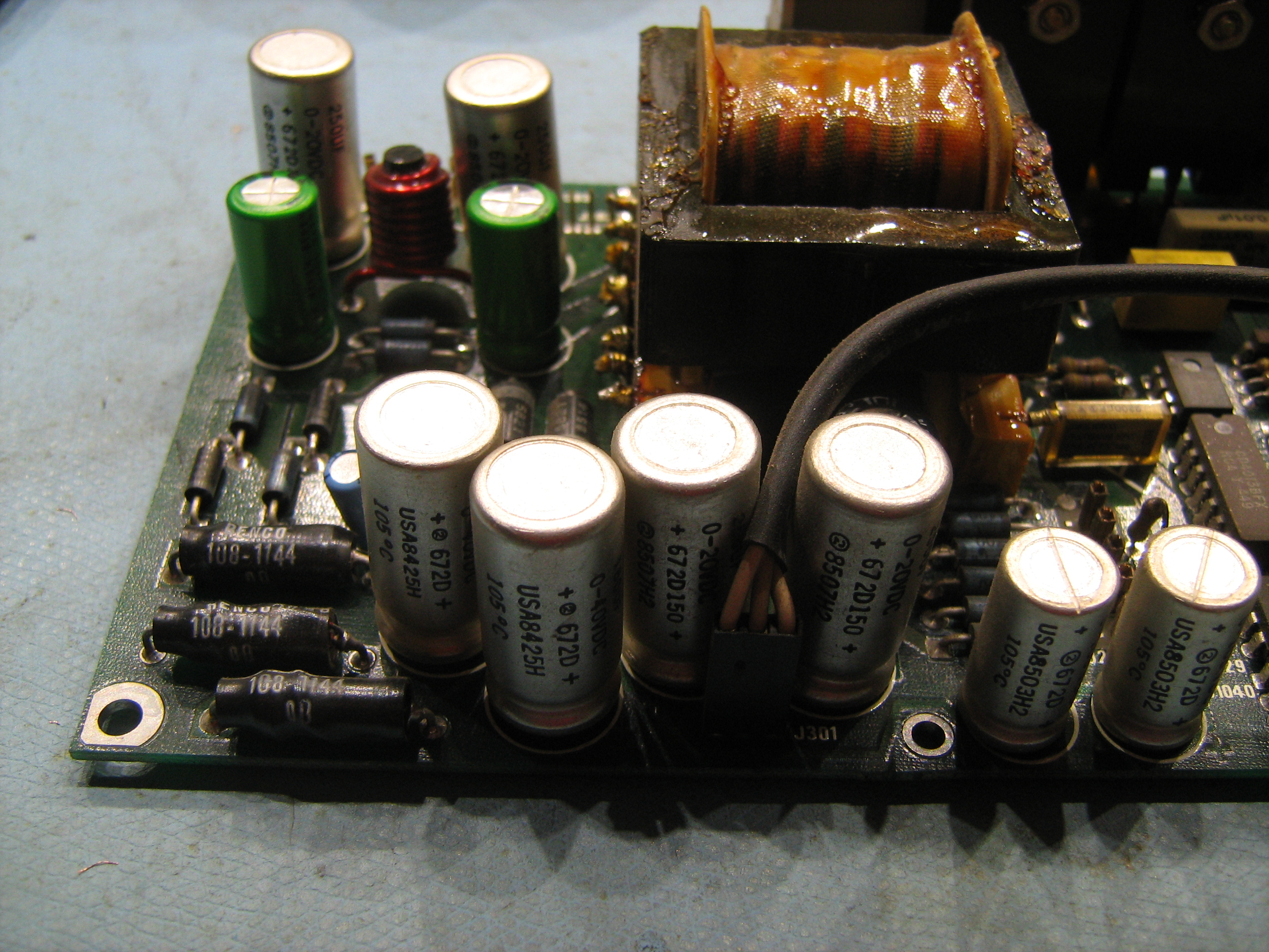

Next, whilst the power supply was out I inspected the capacitors. One of the input filter capacitors did not look too great, so it and it's brother were replaced.
I then swapped out all of the output capacitors. I already had these capacitors in stock from the 2445A repair.

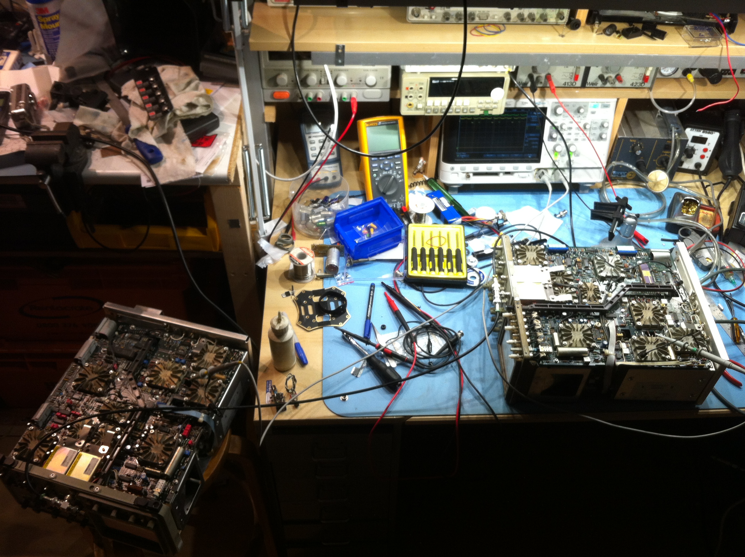

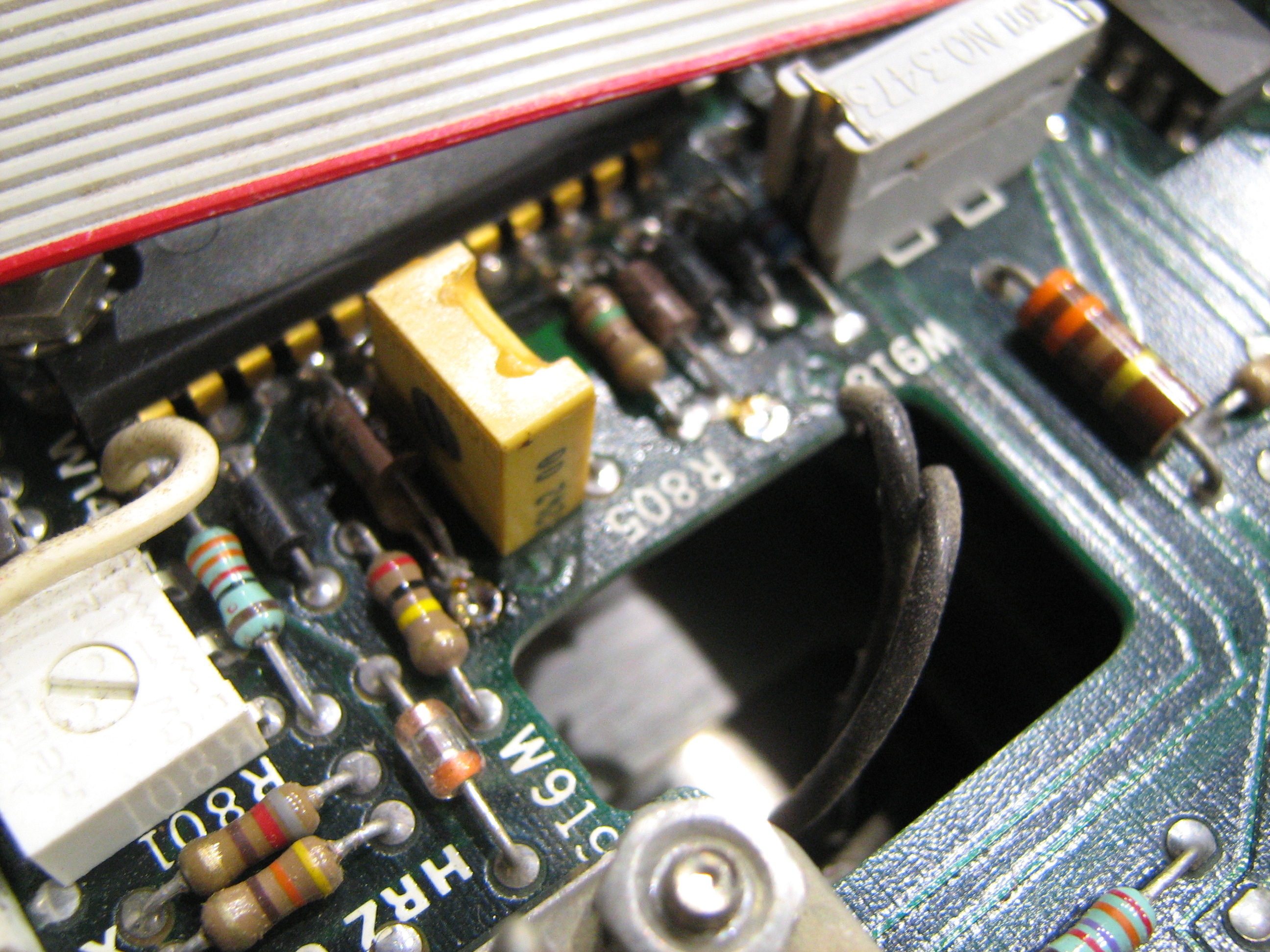

Fearing the worst I headed straight for the horizontal section. I set up the 2445A (which I still hadn't put back together at this time) with the same input signal to use as a reference when making measurements.

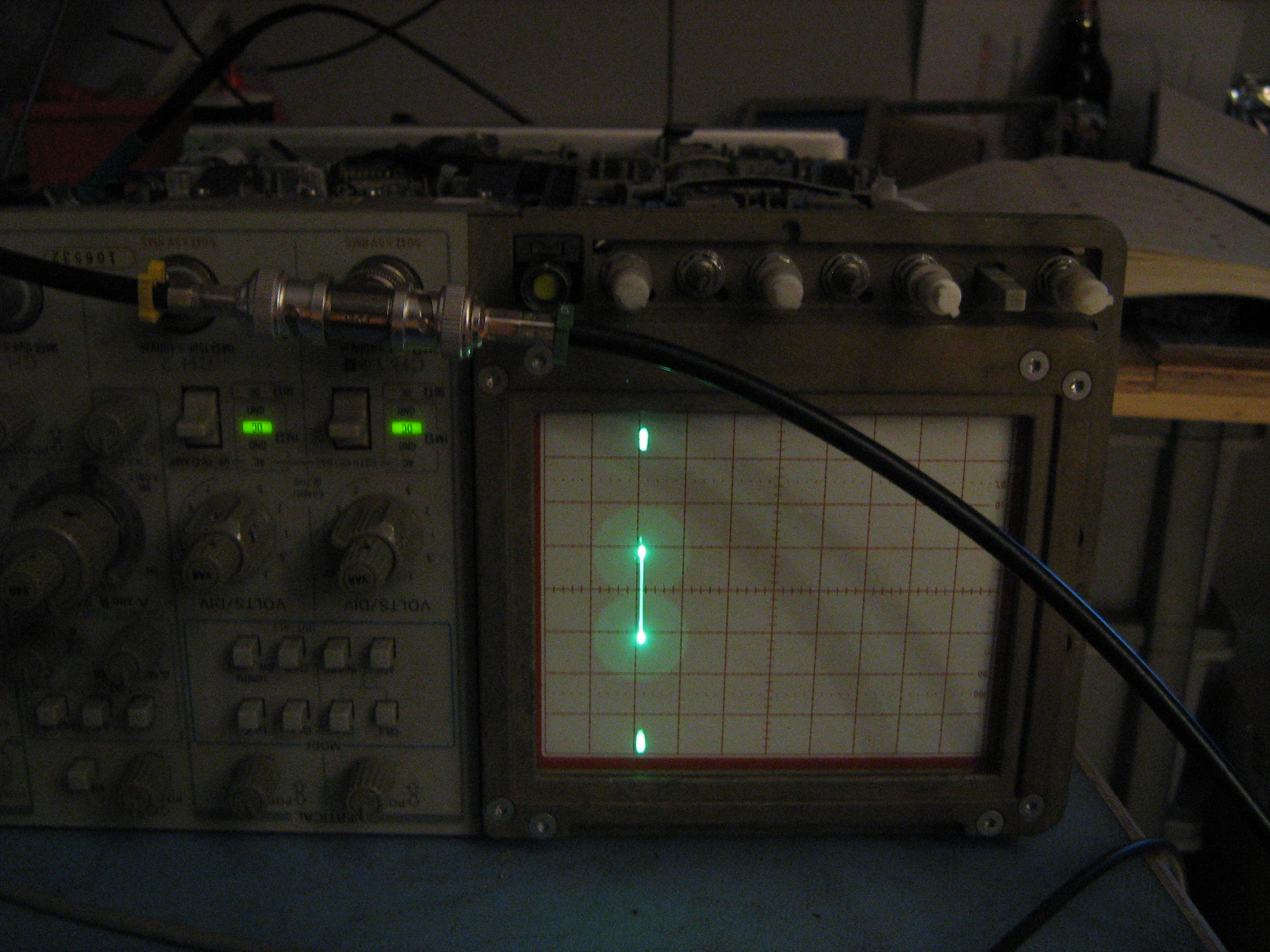

I could measure the horizontal signals all the way up to the ubiquitous U800 horizontal amplifier. The U800 drives the horizontal plates directly and one plate had no signal and the other had a signal but it was clipping and riding at about 40V instead of about 25V.
This is the very reason my heart sank when I first discovered that the fan had been stationary. The U800 is usually the first to "do one" when the ambient temperature gets too high.

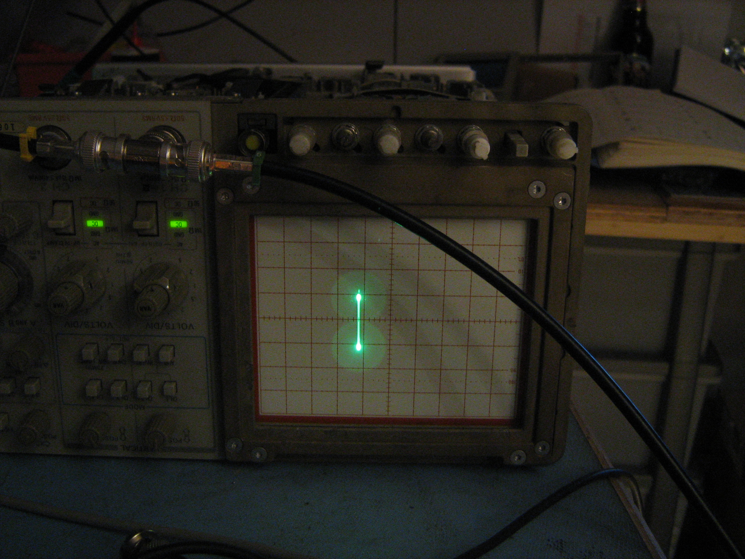

To prove my findings, I disconnected the horizontal plates and just let them flap about in the breeze to see if I could get the beam to strike the phosphor.
Success! We can now see the beam displaying the input signal from the generator only without any horizontal deflection of course.
Even the menus appear to work!

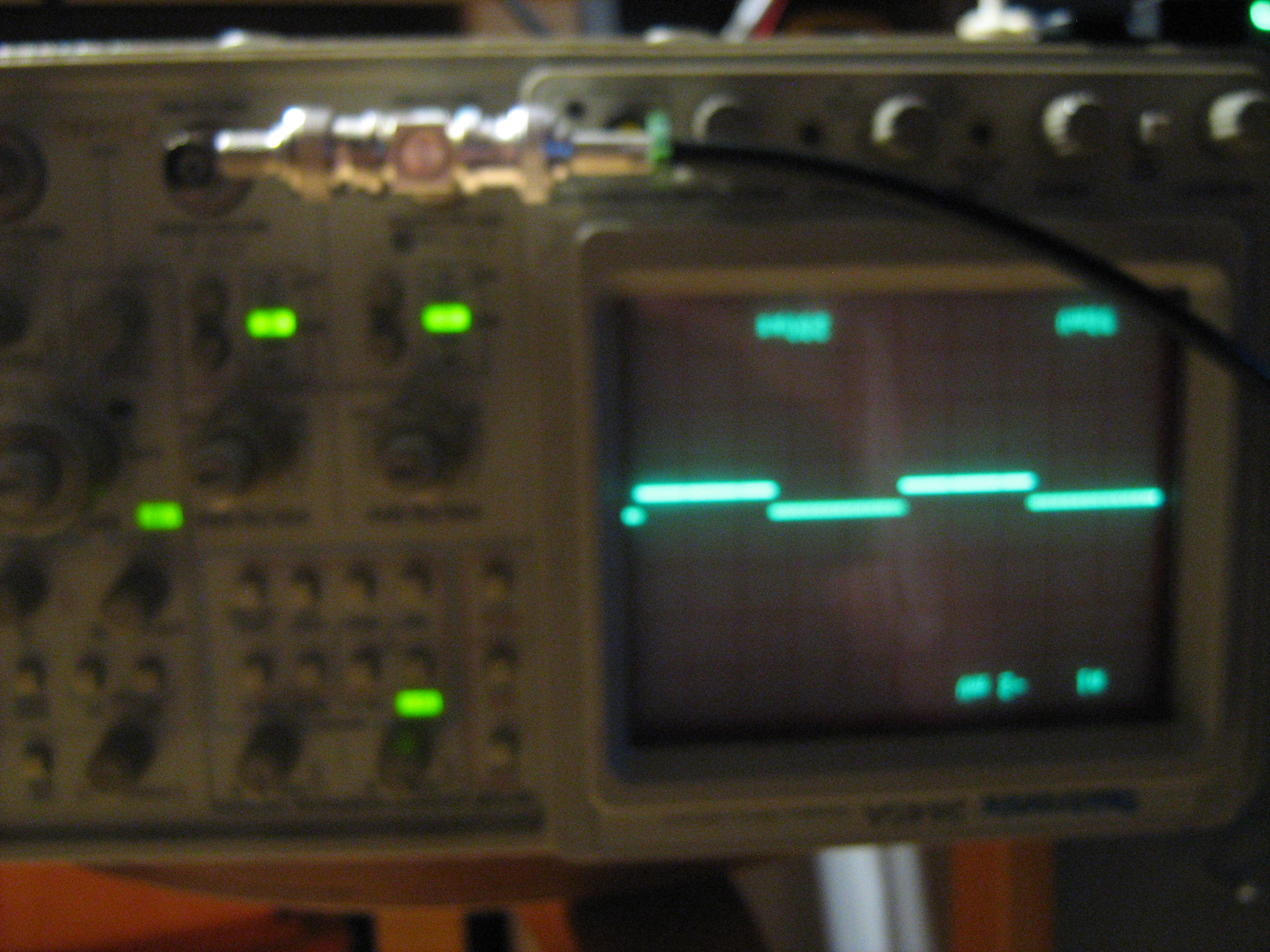

Here the 2445A is displaying the same signal as the 2445 is but with horizontal deflection (and some attenuation dialled in on it's V/Div selector).
The 2445 is displaying the voltage pretty accurately though which is good I suppose.
