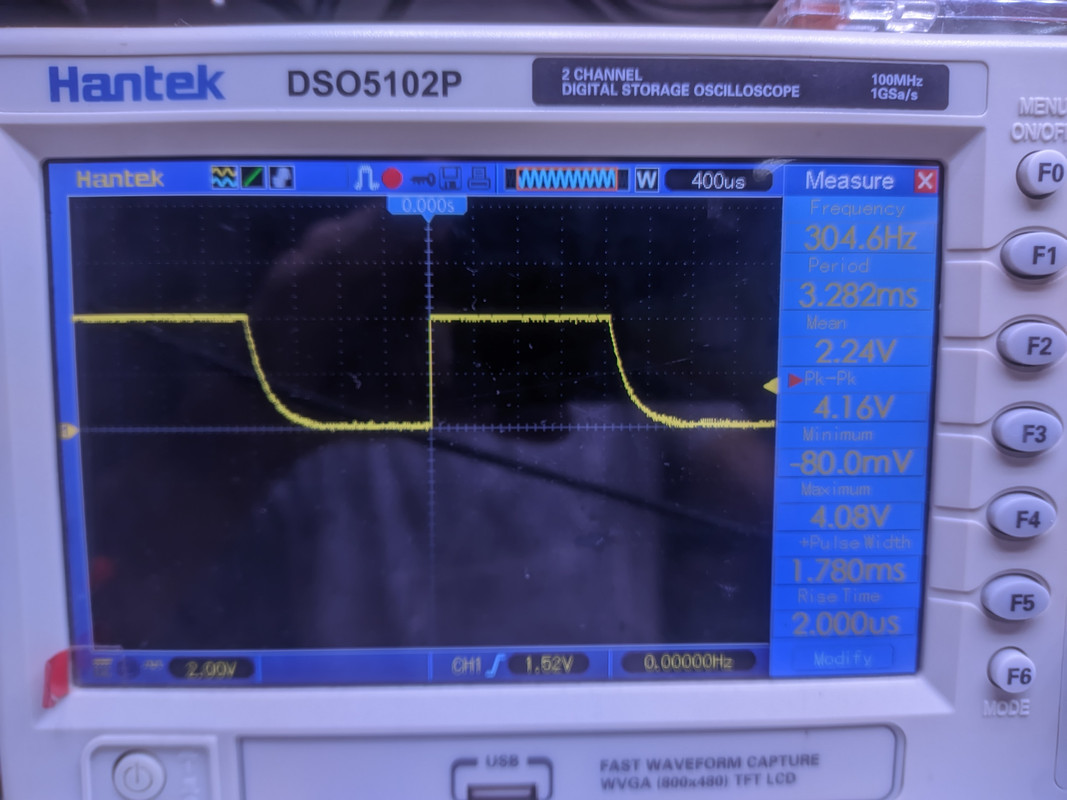

Edit 1: I tried moving the jumper to "DIAG" and measured the entire address bus.
All signals are "clean" square waves except D10 (Pin 19) which has a very high falling time.
With the jumper in the normal position, while all pins are outputting data, D10 appears to float around 5V.
I'm guessing it's the microprocessor's fault at this point. Can I replace it with any MC6802P?

Have no experience with repairing this scope, but I would say yes to your question about it being possible to swap the CPU as it does not have any ROM and therefor is not programmed. Just make sure to replace with one running at the same frequency.
That said, from your scope picture the pin is at 4V not 5V. That indeed does not sound correct.
You named it D10, but it is A10, that is an address line.
The CPU might be the issue, but also any other chip interfaced on that line.
If the CPU is socketed, and thus easy to remove, you could try measuring the address lines with a multimeter in diode mode and resistance mode. Check for similar values between the address line and GND, Vcc and other address lines. If A10 is substantially different you have a good indicator.
