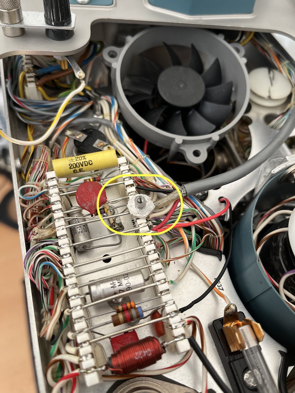

Indeed. I think I may have a clue: when I bought this oscilloscope, the fan wasn't spinning. Upon removing the rear panel, I noticed a screw was missing from the fan support. I suspect the previous owner tried to fix it and either a screw (or more likely the nut behind), felt inside. Since I carry this unit around, this metallic part could have moved and now be stuck somewhere making a contact to ground.
So I guess I'll have to disassemble the whole thing to understand what's going on...

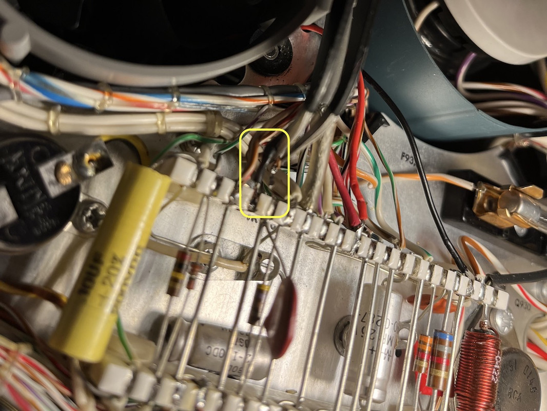

While disassembling the rear of the scope, something became loose and I heard a metallic piece dropping. A nut!
This missing nut should have alerted me when I replaced the fan...
Unfortunately the short is still there but I think I'm on something. Maybe the screw is down there also, shorting something.
Nothing seems to rattle so it's probably stuck somewhere, like the nut was.
The wires are insulated and the pins are in plain sight, so it must be making contact somewhere else. If you were a lost screw trying to wreck havoc in a scope, where would you hide?
Offline George Edmonds
  • Posts: 408
Re: Tektronix 453A, no trace and hard to find short
« Reply #4 on: March 20, 2023, 05:07:13 pm »
Hi
It looks like a screw on the opposite side of the tag strip to the nut
G Edmonds

« Reply #5 on: March 20, 2023, 08:31:12 pm »
Closer yet. I desoldered each of the eight -12V wire from the tag strip, and eventually found the culprit wire. No more short on the rail except for this wire.
This connects to pin AN on the A4 board. Now I'm puzzled because I don't see what could be causing a short on this wire.
More disassembling will be needed...

« Reply #7 on: March 23, 2023, 09:47:24 am »
Quick follow-up in case this could help someone in the future. I found the short: a washer was biting the -12V in a braid of wires. The braid was clamped just beside the screw, so I couldn't easily move it to see the stuck wire.
Also a coaxial ground braid was making slight contact with the power lamp and calibrator pins, pushing it away and adding a bit of kapton tape solved that last problem.
