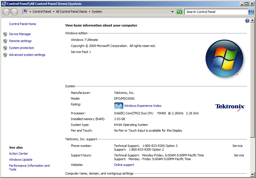

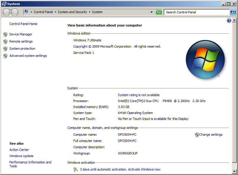

This scope comes with Windows 7 Ultimate edition.  The Windows license sticker on the back says "Windows 7 Ult EMB x32/x64" and has a typical Windows serial number.  Looking at the existing installation's computer properties, (i.e. right-click "This PC" in explorer and go to properties), it says that it is the 64-bit version of Windows 7 Ultimate.  The "EMB" on the sticker made me think that it was the embedded version of Windows 7 though.  I found an ISO image of Windows 7 embedded 64-bit, burned it to a DVD, attached an external DVD drive and a fresh hard drive.  When I installed, it would not accept the serial number from the sticker.  I tried again with the normal Windows 7 Ultimate 64-bit, and it did accept the serial number.  Based on this, I am under the belief that this scope runs the non-embedded/normal Windows 7.
So at this point, I have the scope booting up into a fresh Windows 7 and next is to install the TekScope software.  And I have not made any progress at all on that.

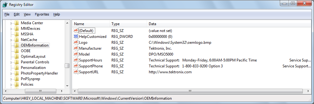

I am gathering that these various installers can't tell that it is a Tektronix scope.  Looking back at the system properties of the original hard drive, it was personalized with:
Manufacturer = Tektronix, Inc.
Model = DPO/MSO5000
as well as a Tektronix logo and support information.  Maybe the installers are checking for this information that would not be present in a vanilla Windows 7 installation?

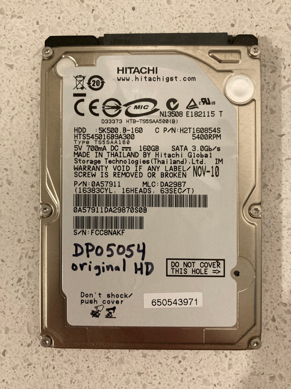

Can you show us a photo of the label of the HDD?
Can you dump the drive's 512-byte Identify Device data block using a tool such as CrystalDiskInfo? You need to select this option from the menu.
https://crystalmark.info/en/software/crystaldiskinfo/
It could be that the installer is looking for a Tek branded HDD. If this is the case, there are ways to make a non-Tek HDD look like a Tek HDD.

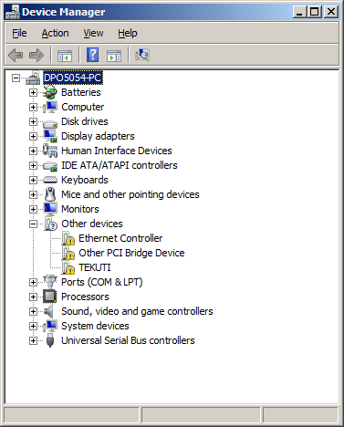

in device manager  do you have exclamation(s) mark
I am not able to upload images directly.  I am guessing it is because I am a new user here.  I used postimg.cc; let me know if there are any issues seeing the images.
I wrote with a sharpie on this HD so that I did not lose track of it.
Yes, there are devices with exclamation marks:
Opening each one, I find:
Ethernet Controller
Ven 8086
Dev 150C
Other PCI Bridge Device
Ven 1268
Dev 0201
TEKUTI
VID 0699
PID FFFE
Also, additional images.  Here is the system properties of the scope running from a clone of the original:
And here is the system properties of the scope running with the vanilla Windows 7 installation:

It appears to identify as a regular Hitachi HDD.
serial number:     101118PBPB18FCC8NAKF
firmware version:  PBBOC64G
model number:      Hitachi HTS545016B9A300<17 spaces>

 other exclamation mark  like pci device could be the bridge between the computer side and scope side ???
tek uti ???  never saw this one    could be,  touch panel or front panel ???
for the 7k series i restarted,  the mobo  as limitations on the size, not the brand ...   you need the power pc / VxWorks booting correctly in the settings,  if not tekscope crash or stall, and for sure the POWER PC  driver
tekscope will replace some files, but it as some limits,  as i saw  not all driver re-install themselves
IE: touch panel / front panel / gpib interface / and a few ...
i have some iso's of the 5k series  i could search  in them ...  not at home       ill update this thread   if i find them  later

I have a few updates on this.  I made a copy of the Windows/System32 folder from the original installation, and I was able to update the driver on each of the exclamation point devices on the vanilla windows 7 installation.  I browsed to the copied system32 folder and it was able to find all of them.
"Ethernet Controller" became:
Intel 82583 Gigabit Ethernet Controller
"Other PCI Bridge Device" became:
Tektronix Acquisition Interface
"TEKUTI" became:
Tektronix USB-THC Instrument
I also was able to extract the computer properties from the original installation.  This included some registry items and the image:
Unfortunately, even after all of these changes and rebooting, all of the installers still did not work.  They all still thought that it was not a Tektronix scope.

3. "DPO5054 Drivers.zip"
  3a. Unzip the file.
  3b. Open Device Manager and manually update the 3 unknown devices, browsing to the unzipped folder.

  4c. Open "OEM System Properties.reg".  This adds the OEM information to Windows System Properties.
  4d. Open "TekScope TDS5000 Identifier.reg".  This adds the identifier to the registry needed by the Tektronix installer.

as a follow up,   do you still  have errors in device manager ?
There are no errors in Device Manager at all now.

That looks promising.  The original hard drive was 160 GB, and the disc says "for 500 GB hard drives".  I could put in a 500GB hard drive but it makes me worry why it says that!  Are there ISOs of these discs anywhere?  I am guessing it is OK to share those because vanilla Windows 7 ISOs have been available for download directly from Microsoft.
