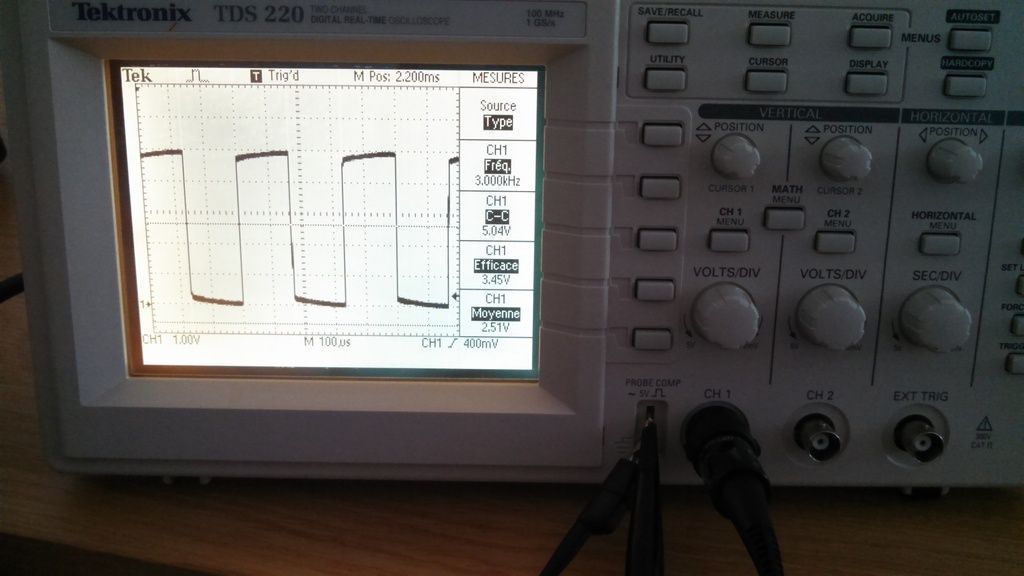

When powered up, it shows a message: CH1 CH2 Acquisition FAILED
The error log shows numerous errors "6 DI Line Trigger Diag failed":
Anyway, the scope seems to work correctly.
Something is strange, the Probe Comp. signal is at 3 kHz instead of 1 kHz:
The service manual is clear about the Probe Comp signal, it must be at 1 kHz:

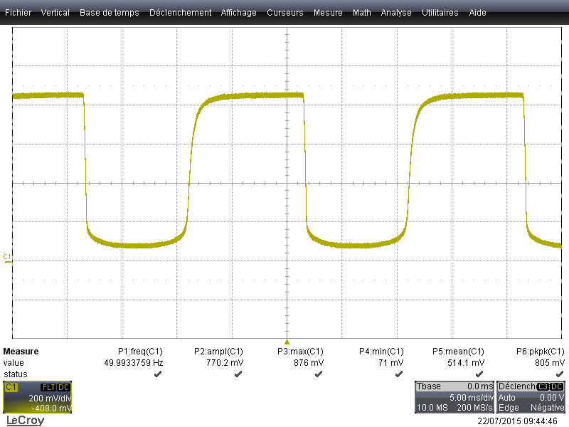

« Reply #6 on: July 28, 2015, 05:58:37 pm »
Yes you are right, the line trigger comes from the PSU.
I have probed the signal with an oscilloscope, without and with the mother board connected
Unloaded:
Loaded:
The line trigger signal is not within the specifications (1 V pkpk unloaded or 800 mV pkpk loaded). The manual says it must be from 1,4 V pkpk to 5 V pkpk.

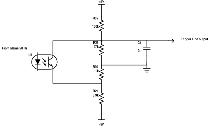

I have traced down the diagram of this part on the power supply:
When the Phototransistor is open, the voltage should not be higher than 1.063 V. When the phototransistor is closed, output voltage must be about -0.8 V (-1 V plus the 0.2 V Vce sat).

You've calculated that ok.
  • Posts: 29612
Re: Tektronix TDS 220 repair
« Reply #8 on: July 28, 2015, 07:31:15 pm »
This implies the Line trig signal is being loaded down OR the Phototransistor is faulty OR is not getting the required input signals.
You are narrowing down the likely fault nicely.  :-+

I'm wondering if the 100k is the only thing that actually pulls the transistor up to 5V, or should its destination act as a current source?

I have just tried to replace the R32 resistor by a 47k ohm to rise the top of the trigger line signal to about 1.8 V.
The oscilloscope always shouts a Line Trigger Diag fail!
The line trigger signal goes to the CPU board and disapear within the 4 layers of the PCB. It is very hard to trace and I suspect it goes directly to the acquisition ASIC.
So I think the service manual is wrong about the specifications, my line trigger signal is OK and the ASIC is fried.

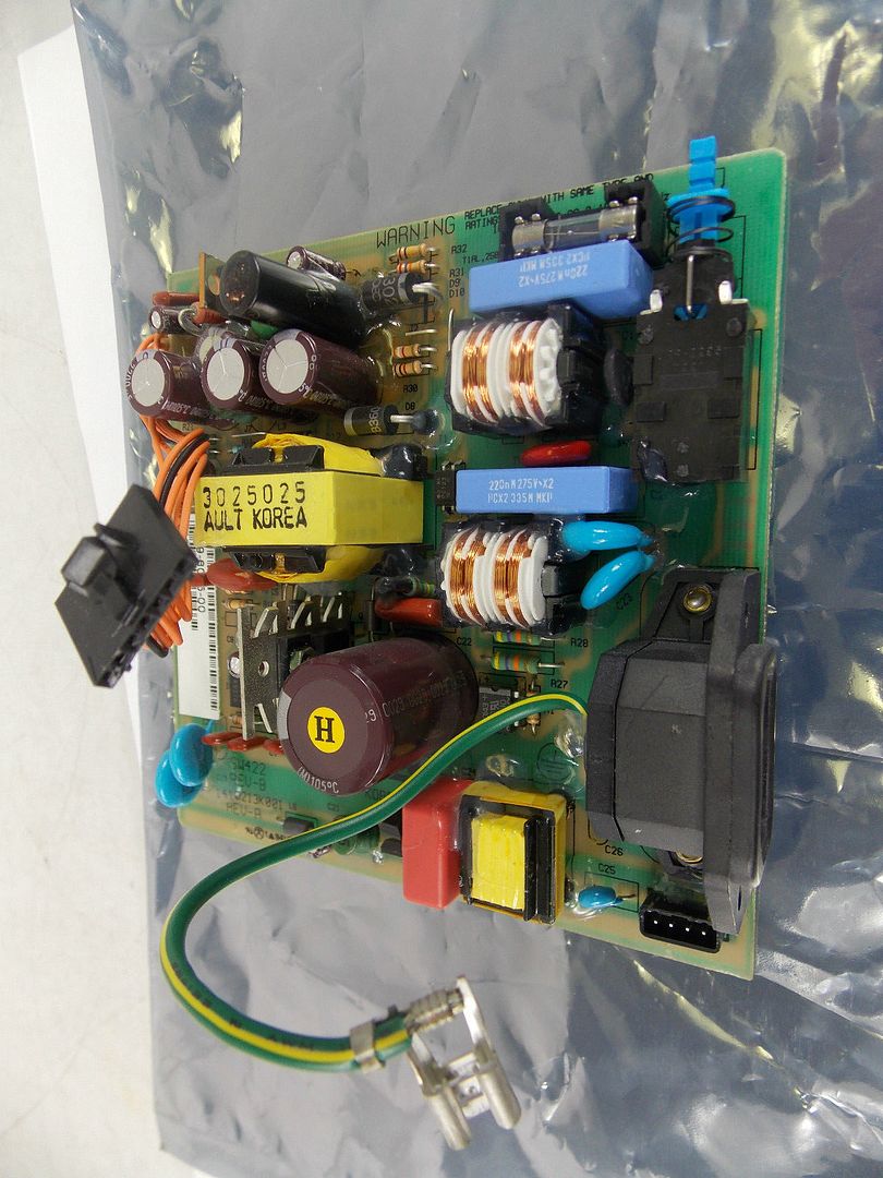

Please do someone have a high resolution picture of the PSU board or schematic? I have a broken diode on the -5V output but there is no reference on the diode.
  • Posts: 29612
« Reply #14 on: August 18, 2015, 07:43:55 pm »
Description, package?
A pic from you might help us identify this diode at a glance.  :-//

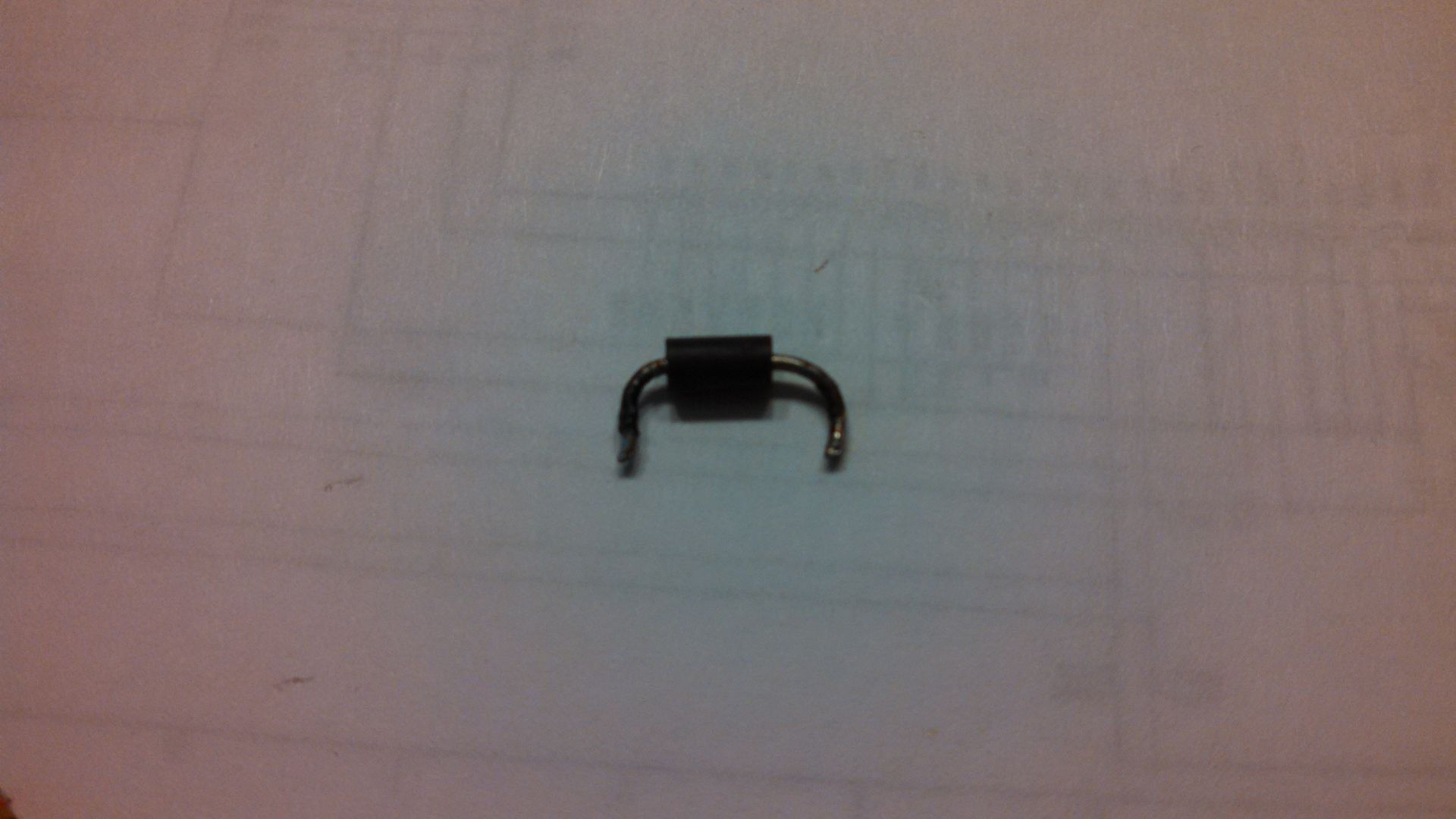

Here is a detailed picture of the diode and the PSU. The diode D10 don't have any marking, not even a mark on the cathode.
If someone have a Tek PSU from a TDS 210, 220 or 224,  PSU rev. D or higher it would be great to have some pictures to compare.

What does the diode do? If it is overvoltage protection it will likely be a 6V2 1W zener or a transient suppression diode of the same rating. If it is a rectifier diode a UF4004 diode will do as a replacement.
Offline sbeube02Topic starter
  • Posts: 30
Re: [PSU Pic. request] Tektronix TDS 220 repair
« Reply #21 on: August 21, 2015, 06:33:14 am »
This is just a rectifier diode.
I have googled for PSU pictures and found a picture of this diode on a PSU Rev. A
D10 looks to be a UF30xxx? I will try to get a replacement diode. It must be a fast rectifier diode, about 1A.

In the first picture I see a SB360 a 3A schottkey diode. Most likely it's after the transformer.
They are commonly schottkey diodes. If you substitute a UF 1A type (UF400X) or a 3A( UF540X) it's not going to last long. Just look at the originals of your board they are definitely 3A sized.
