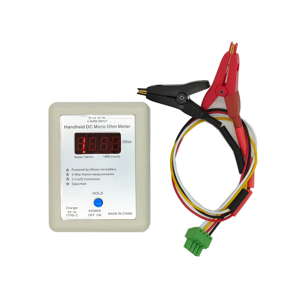

Hm, seems like people here are also divided between thermal imaging and resistance based methods :/
I have a Fluke 17B+, which is a 3 1/2 digit meter and kinda useless for anything <1Ohm. I have a Peak ESR meter that goes down to 0.01Ohm but is also limited by being 2-wire.
The shorty seems like a really neat device, but I'm not really up for a project like this. It involves an Arduino and I'd have to get a case for it etc., I'd rather just buy some kind of meter.

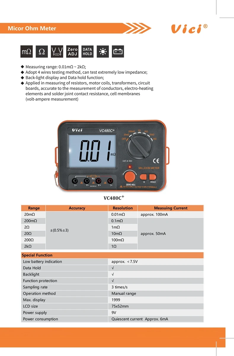

These Vici VC480C+ meters seem neat:
Specs: https://ae01.alicdn.com/kf/S591a11dab36649c0a22daf906bf89603w.jpg
There's also the YR2050:
The probes are kinda useless with both of them, not sure how cheap/available 4-wire sharp-tipped probes are. Here's a review of both devices from Learn Electronics Repair:
(Haven't watched it yet!) Edit: Just watched it. The Vici seems like a decent choice, too bad it's so bulky and the probes are also bulky :/
As far as thermal imagers the UNI-T ones seem good, but are somewhat expensive. There's the knock-off looking Noyafa NF-521 for ~150EUR:
The cheaper sub-100EUR options all look a bit useless.

I would still make my own set of probes, reusing a multimeter set of probes and adding 4-wire connection.
the provided kelvin probes are not ideal for short-circuit searching.

Those cheaper meters seem to be missing a zero/calibration function? Guess they would still be usable for short finding, we're only interested in the relative values...
Seems like making my own probes wouldn't be too hard, but I don't really know much about that, like how much error would be introduced by having the current source/voltage sensing wires joined earlier etc. Can't you just buy these probes? A quick search on AliExpress didn't give any results :/

Considering that those milliohm meters use a ~100mA current, would it be only safe to use it like in the video, directly across components that are either shorted or parallel to a short? I'm just thinking simply placing one probe on ground and then poking around the circuit would have quite some destructive potential with that kind of current.
the shorty-with-display illustrated here sends around 35mA of current on the probes, but at a few millivolts only.
I use it often and never destroyed a device under test with it.

Seems like the VICI is a bit more aggressive then:
That seems enough to blow up an LED? ;-)
How does the milivolts thing work? I would've expected these are constant current sources and hence the voltage is a function of the resistance encountered?
