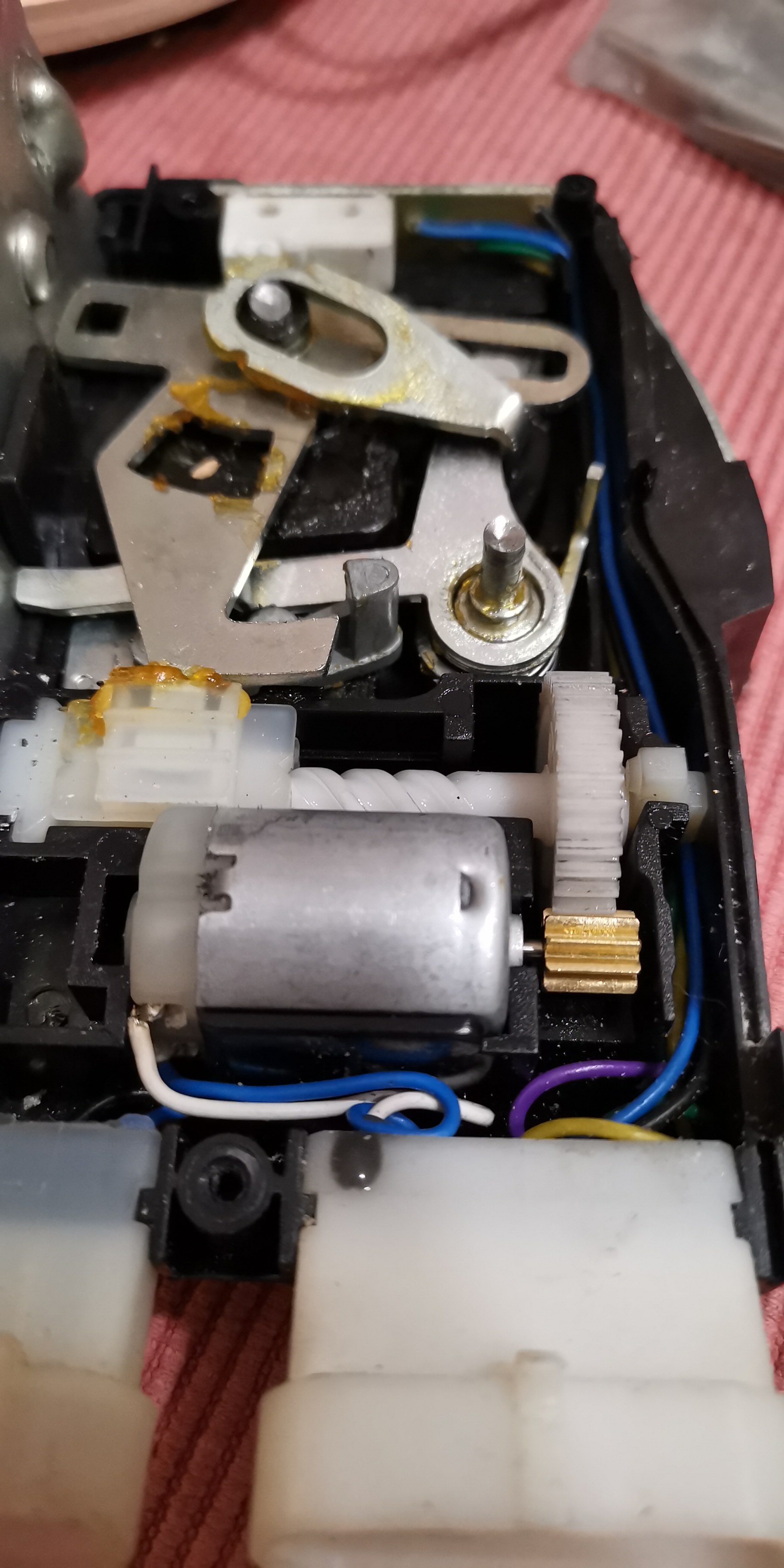

My car is well known for its cursed door locks, the dreaded Mabuchi FC-280 motors die every 2-5 years.
Although it's a bit random, some doors will fail a lot faster than others after replacing the motor, although they all do the same work.
I blame it to Aliexpress quality but still better to change $4 twice than $150 in a new lock.
I already fixed them several times, but eventually any of the 4 doors will break again.
Then it's a f** mess, as the car tries to open the doors, one or more won't do so it'll close back.
You might fight it but after several tries the system will shutoff the remote for a while.
Of course I just ended using the feecking key, but it's a shame in winter with the wind, rain and all that, you want to get in/out fast! :-DD
So I've been doing some research trying to find a compact brushless solution fitting inside the lock itself, needing minimal modification.
Picturses of the door lock internals and the stupid motor:
It moves a reduction gear that later spins a worm gear, so it requires very little torque.
The central locking simply switches the polarity of the motor pins to close or open the lock.

The contactor contaminates/clogs up and no longer makes good contact.
Sometimes it arces and destroyes the motor, but so far I only saw that once, most simply had a thick layer of dirt.
I think the problem is caused by the short working cycles, the motor startup current is high, the brushes erode faster, but the motor never has a good spin to clean the dust/crap.
It's just 1/2 second, stop, 1/2second, stop...
« Last Edit: June 07, 2023, 11:07:56 pm by DavidAlfa »

Why? It's the only failure in this locks. Every one I fixed looked brand new inside, full of fresh grease, no wear, perfect gears, nothing else than the motor.
By removing the mechanical contacts, should finally last forever.

I already said, the rotor contacts end with a layer of dirt.
No damage, it's like hard, dark paint.
There's no grease entering the motor, so it must be the carbon brushes, adding the fact the motor only rotates maybe 50 turns every time.
