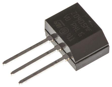

Got a vacuum here a German bosch gas 50 professional with pic16c621a-041/p airflow-vacuum sensor and electromagnetic dedusting function.
The brains are running (the pic). Still need to test the other sensors but a chip is exploded I did not see this at first because it was covered in epoxy resin..
Seems gate of this transistor that is blown probably NPN that enables electromagnetic dedusting function gate is connected to PIC on pin 7(RB1) and 8(RB2) bridged for probably slightly higher pull-up signal? Datasheet says "Input/output pin. Internal software programmable weak pull-up".
Anyways I carefully took apart whats left of the chip. I can't find anything on digikey or google. Probably my mistake or maybe it is impossible to find out again because there is no BOM available and the board came with epoxy on a few parts from the factory so no way of finding the chip numbers unless you get the resin remove first...
Here is a picture of it.
As far as i can make up of whats left of the laser engraving.
Any ideas to what this can be?
I would figure I first try to get my hands on this transistor if not possible, then I need to look for a replacement board or Frankenstein is together... (last option)

It's either a lo-sat PNP transistor or a P-channel MOSFET with BCE or GDS pinout.

The packaging reminds me of the ancient BC147/148/149 series, although the pinout does not match (neither the probable age of the equipment).

This is a relatively new product. So the old BC147 are out. The case is similar, but this are definitely more modern parts. I would also expect higher power, as for low power they would have used SMD.  It is odd to see a so many THT parts, but this could help with the heat.  So as others have already noted more like a power part.  To switch the cleaning part, this would need quite some power - it is just a simple electromagnet, more build to a cost and not for efficiency.  Are there really 24 V ? , the power may be directly mains.

Unless I'm cross-eyed, the emitter of the transistor is connected to the Vdd supply of the PIC, so it is switching 5V, not 24V.
Edit: Now I'm confused. The TO-220 packaged device is an FT1214MH, which is a TRIAC.
https://alltransistors.com/scr/view.php?pdf=FT1214MH
So is the mystery part also a TRIAC???

What L and N are? 220V? Or 24Vac?
L seems to go to GND through the switch??
Also L goes to the pin near the misterious component, through what is seems a current transformer, so it must be AC.
Maybe a BTA600 triac was there.

https://mastergrad.com/forums/t136782-stroitelnyy-pylesos-interskol-pu-32-1200-nebolshoy-obzor-glazami-polzovatelya/?page=2&order=desc
Z0410MF, STMicroelectronics, TRIAC, 600V, Gate Trigger 1.3V, 4A, TO202-3:
https://docs.rs-online.com/576f/0900766b80ed29f8.pdf
https://media.mastergrad.com/thumbnails/forum_post_attachment/46/da/7c/46da7c753e60897277a99a0abb129412.jpeg
https://s3-eu-west-1.amazonaws.com/enrgtech-images/full/70f1a4326f86fa289925729610415e80bdafb680.jpg
Well, damn got to admit that was amazing! :clap:
Only thing missing is bypass smd capasitor on the backside of the pcb, and V7 Z0410MF, great! So the failure point was the Z0410MF shorted and it pop'd also the smd bypass capacitor.

https://www.interskol.ru/storage/docs/products/PU_20.1000_32.1200345.1400_s_blokom_upr._.pdf
V7 = Triac Z 0410 MF 4A 600V 25mA
C6 = CHIP-C 22nF/10% X7R 0805 50V

Can confirm, tried to replace
V7 and C6 (22nF, yes) both correct even from diffrent version PCB (smaller vacuum) parts ARE in fact the same. Still didn't work somehow. Ordered a brand new board from Bosch and tossed the doomed one, will install and test. The only thing that was different was C6 wasn't 0805 but think it was 1206 or 1806 don't know about tolerances (caliper measurement 3mm~ in lenght). Yes I just took the hot air gun at the new board and took it off to verify. No warranty anyways I am the warranty.. Will update on what was the issue, I hope the coils are still fine.
Edit:
It's so wierd I can't find the problem I measured all parts.
Rotary wiper switch works, mains switch works all components none is shorted. But I do see changes in the design. They removed the 24vdc speaker control and sense, and removed the potentiometer just jumped and changed some resistor value. Will try this on the old board, want to know what the issue is. The new board works, and behaves different, still yet unable to find it. Maybe dead zener diode? I can't test it.
I found out it switches on the manual cleaning function (that the Triac is used for) when PIC detects R plane shorted by pull down resistors (560k Ohms 5%) to PIC pic16c621a-041/p pin 9 and 10. Dead PIC maybe??
Edit2:
I fixed the old board but had to modify it, remove components and replace values, never would have guessed this if Bosch never sent me the updated PCB.
Here are the changes I made to repair the old board.
