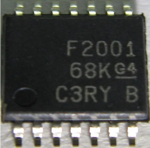

Two of them are legible. The third appears to have no markings. There was a layer of some type of glue dabbed on the top of each one that I carefully scraped off.
F2001
08KG4
ATHNO
(HTSSOP14 ic chip? or IC MCU 16BIT 1K FLASH 14-TSSOP? ---- Brown-out Detect/Reset POR PWM WDT)
D413A
BA1219
(P-Channel MOSFET Transistor)
The third one has 8 pins and looks like a timer. IDK what it actually is though.

« Reply #3 on: May 18, 2023, 08:31:19 pm »
AOD413A 40V P-Channel MOSFET:
http://aosmd.com/pdfs/datasheet/AOD413A.pdf
MSP430F2001 16MHz MCU with 1KB Flash, 128B SRAM, timer, comparator:
https://www.ti.com/product/MSP430F2001
https://ae01.alicdn.com/kf/HTB1FpgOsxWYBuNjy1zkq6xGGpXa6/50-MSP430F2001IPWR-F2001-MSP430F2001-TSSOP14.jpg (photo)
Maybe this application note would help to visualise the circuit? There is a "Block Level Schematic" on page 3.
Li-Ion Battery Charger Solution Using an MSP430 MCU (Rev. B):
https://www.ti.com/lit/pdf/slaa287
