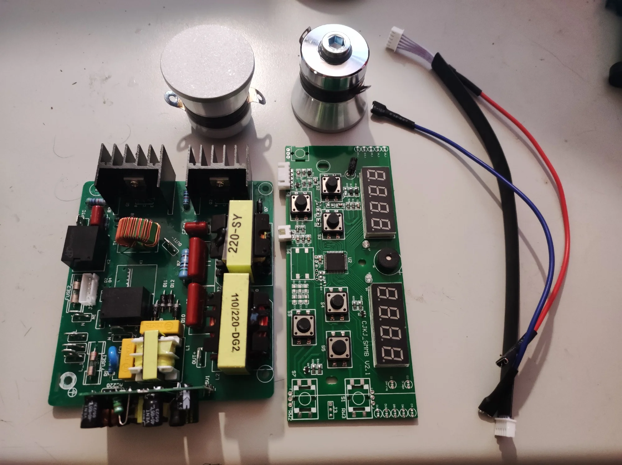

Hi. I'm trying to repair my ultrasonic cleaner that had a short on a output transistor. Its a pair of MJE13009, from Fairshield. Also a bridge rectifier was shorted, flyback diode and fuse. I bought everything and replaced. Worked fine, but the transistors were heating up so fast, like in matter of one minute was about 80 to 100C on their dissipators.
I found a similar schematic of the circuit driver from a Hackaday project, but there some diferences:
• All component numbers are different on the board, but same values.
• A resistor does not exist, R4, is just a jumper.
• R7 on my board is connected between Base and Collector, not Base and Emitter.
• My transistors are 13009, not 13007.
Its about it, the rest is about the same so far I can tell.
The transistor I bought seems fake, but I tried buying for other places, and they seem about same fake. I took a photo from they:
Left is the originals from the board, that worked for years, on the right are the fake ones.
So, what can I do? I'm a little lost on this. It seems that somewhat its very hard to find original transistors nowdays. What you guys suggest? Thanks for the attetion.

Set up the circuit on fakes and when it works normally install ST13007(9) from ST Microelectronics or MJE13007(9) from ON Semiconductor.
Online wraper
  • Posts: 17822
  • Country: lv
Re: Ultrasonic driver and fake transistors...
« Reply #2 on: June 04, 2024, 08:29:10 pm »
Transistors on the left are not Fairchild but something that tries to look somewhat similar. Transistors of the right have almost proper Fairchild logo, look 100% fake though. Also marking on the left suggests FJP13009, not MJE13009. Marking on the right suggests MJE13009. Although they're the same thing, ON/Fairchild does not seem to produce MJE anymore.

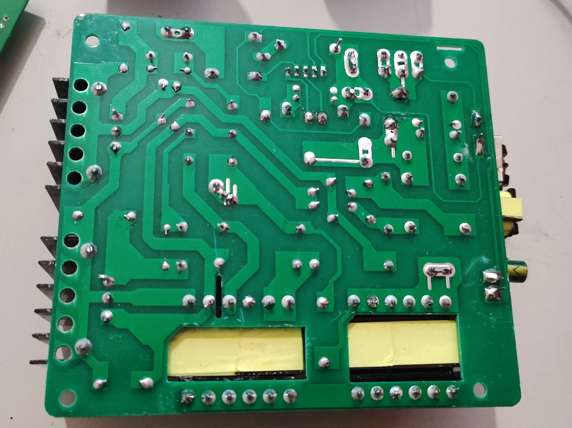

Offline coquinhoTopic starter
  • Posts: 16
  • Country: br
« Reply #8 on: June 08, 2024, 08:58:06 am »
I think that a least on my board, its just a inductor, the transformers is just like the ones on this picture of a driver board:
