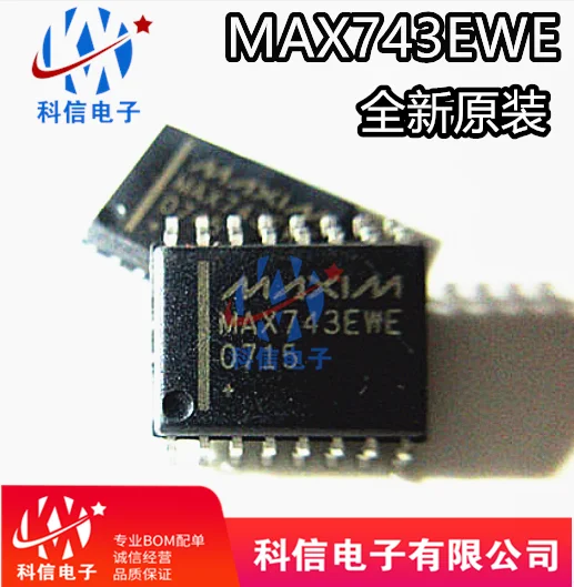

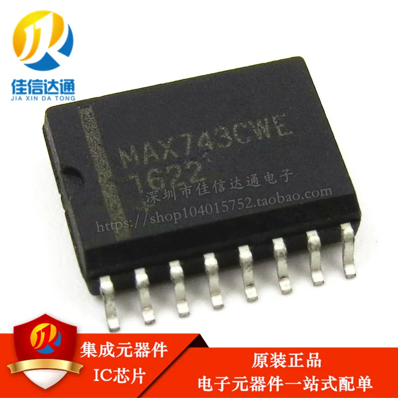

After compare with the datesheet, MAX743 is the right chip.
Thanks alot for your great help!
The following users thanked this post: BreakingOhmsLaw
Offline teatimeTopic starter
  • Posts: 29
  • Country: cn
Re: unknown DC-DC chip of SI-9110 differential probe
« Reply #7 on: April 20, 2024, 01:08:06 am »
After remove the chip, then I draw this schematic, it's right.
The chip MAX743 is the chip I needed.
