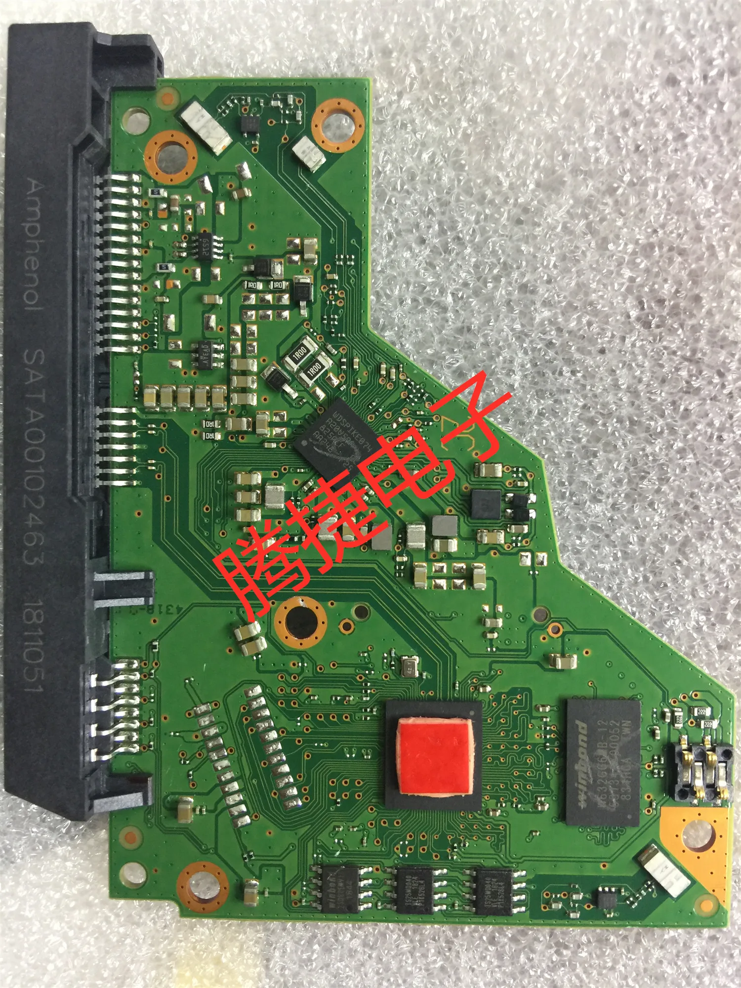

This PCB ...
https://ae01.alicdn.com/kf/Hd2161dd55b72428e93a18cf6c1d1b5848/WD-hard-drive-WD20EZAZ-PCB-2060-810011-001-REV-P1-P2-unlock-PCB-board-Decrypt-PCB.jpg
... has a dual channel 5V/12V current limit switch at the SATA power connector, marking "6512".
I suspect that it is electrically and functionally compatible with the following part.
MP5094, Monolithic Power, dual channel 5V/12V current limit switch, marking AYUy, TSOT23-8:
https://www.monolithicpower.com/en/documentview/productdocument/index/version/2/document_type/Datasheet/lang/en/sku/MP5094/document_id/4894/
I'd like to add the mystery part to my database. Can anyone help me to identify it?
Edit:
Here is another compatible part.
STEF512GR, STMicroelectronics, Dual electronic fuse for 5V (3A) and 12V (4A) rails, marking H512, TSOT23-8L:
https://www.st.com/resource/en/datasheet/stef512gr.pdf
