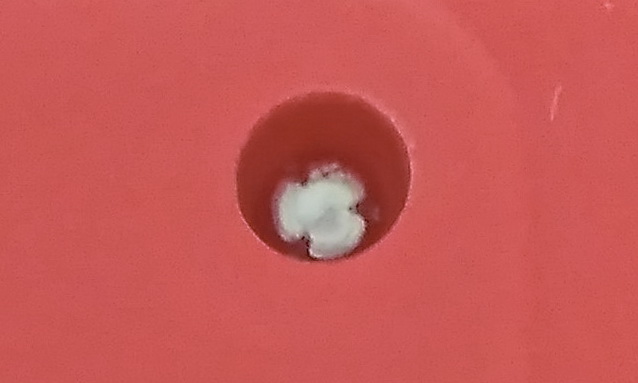

I am trying to open a power strip to replace the cable and it has some of the weirdest security screws I've seen.
No bit from my collection is compatible.
Have you seen anything like that?
Thanks.

« Reply #1 on: October 17, 2022, 08:08:07 am »
Not exactly this one, but I've seen similar "screw heads" that weren't screws at all. Just a pin with some thread-alike (but not a real thread) shapes pushed into the plastic, and not intended to be opened.

« Reply #2 on: October 17, 2022, 08:14:48 am »
I hope its not one of them..
Is there an easy way to remove them if they are pins?

« Reply #3 on: October 17, 2022, 08:23:25 am »
I would either drill a larger hole around them to be able to grab them with a pair of needle nose pliers, or take a thin drill bit around the diameter of the pin/screw, and drill through them.
After I'm done, replace with a slightly thicker screw.

« Reply #4 on: October 17, 2022, 08:40:02 am »
They are actually screws!  Never seen ones like that before.
The must be the securitest security screws around...  :-)
I drilled a hole on the opposite side of the screw until I reached its head and then
hammered it out.  I will use m3 bolts and nuts instead of them.
Does a compatible bit actually exists for them ???   ???

« Reply #5 on: October 17, 2022, 08:49:20 am »
Looks like some monstrosity that you 3d print a head for, to avoid buying for single use.

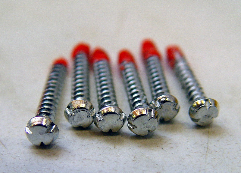

A left hand drill bit and/or easy out makes short work of those. The hard way is to grind a flat blade screwdriver to fit in 2 of the slots and wind it out carefully.

I believe they're Tri-Groove (aka T-Groove) screws, which are common enough that their bits seem readily available.

« Reply #10 on: October 17, 2022, 09:28:11 am »
I think you are right!  Thanks.
https://www.losspreventionfasteners.com/store/products/t-groove-tamper-proof-bolts/
I have to find a socket for these, just in case...

Not sure that their bits are readily available though and they sell for crazy prices.
