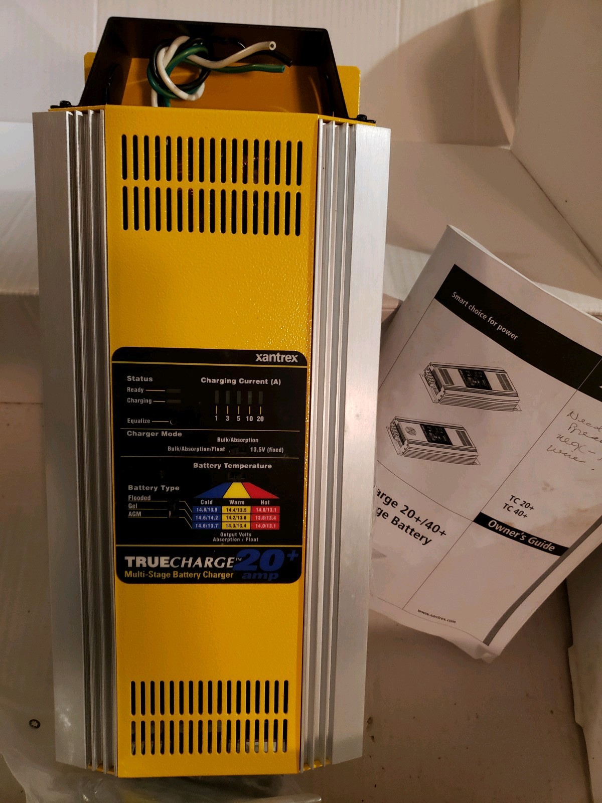

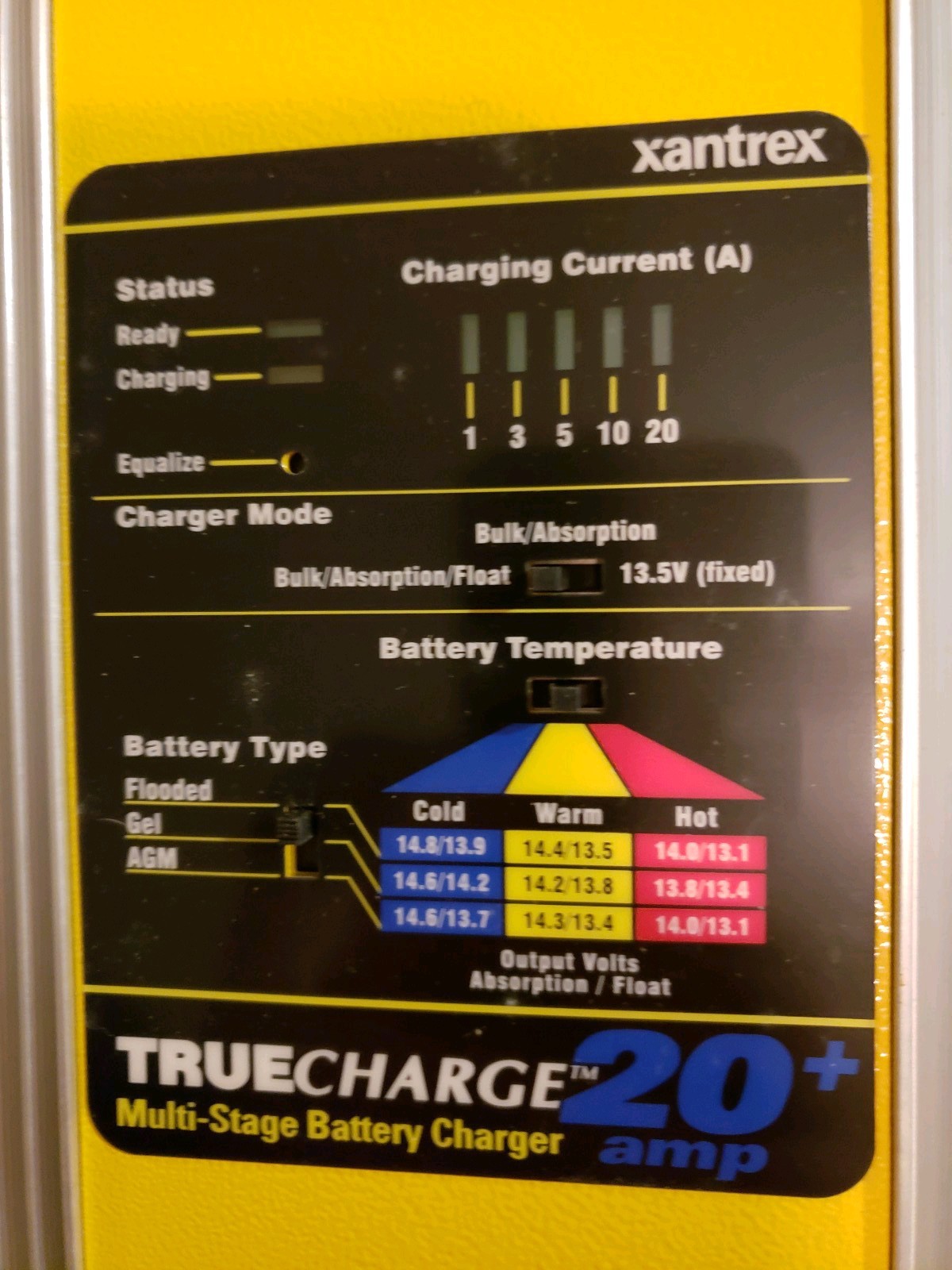

I found a used Truecharge2 20 amp on ebay As-is untested for a $100.00 (including shipping).
It's capable of charging three batteries  simultaneously at different rates depending on the state of charge of each battery. Battery types AGM, Flooded, GEL and Lead Calc (calcium)
It was listed as "For parts or not working "
Seller Notes:    “There are some signs of wear/scratches. The battery charger remains untested for working condition, which is why it is AS IS for parts or repair. The item is being sold as is, no returns, for parts or repair.”

I did come across an Xantrex Truecharge 20+ for $75.00. Described as " Never installed. Comes in original box with manual."
 It's the old version of Truecharge that was replaced by the Truecharge2. Instead of using a fan appears to use large heat sinks.
http://www.xantrex.com/documents/Discontinued-Products/DataSheet/DS20060712JS_Truecharge2040.pdf
https://i.ebayimg.com/images/g/xQkAAOSw~sJcJmgW/s-l1600.jpg
