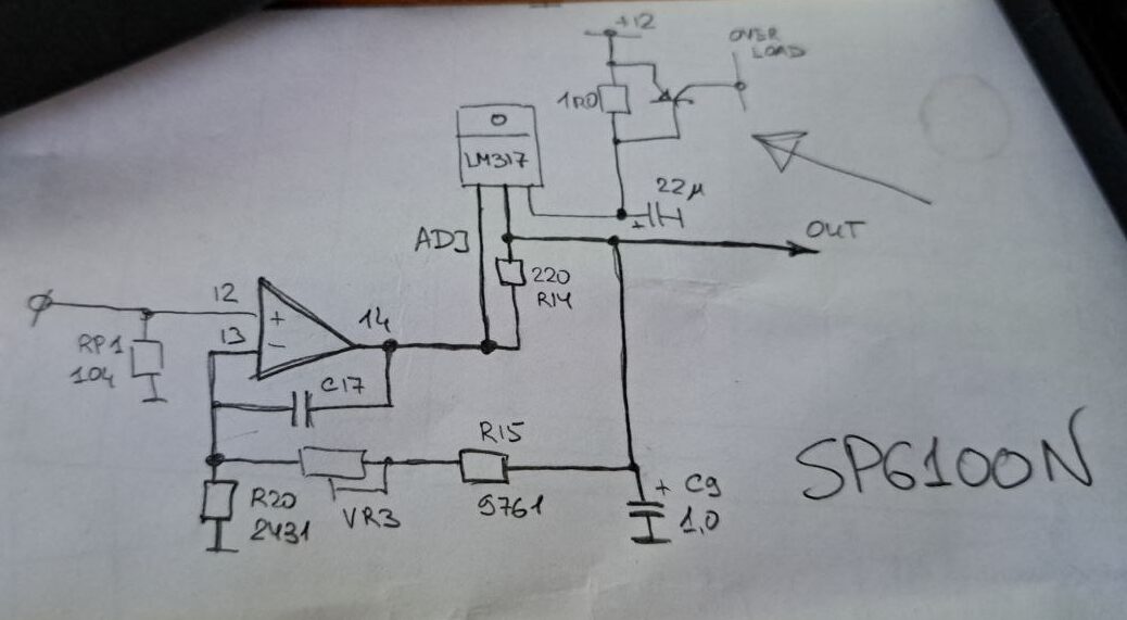

Hi all,
Needed some help in troubleshooting programmer error. This is a genuine Xeltek SP6100N that was purchased from China which the seller/xeltek china now not seem to be willing to support. This is a 5 months old unit, used to work fine and last week start giving corrupted reading/writing. Not 100% corruption, but only about 10% of the data is corrupted. Chip being programmed is hn27c256 and M48Z35Y-70PC1.
Previously Xeltek US was kind enough to supply me with a self diagnostic program. And when I run the SP6K_ST algorithm (the self diag) It will show failure during calibrate portion. This is where I am supposed to measure the voltage output of pin 1,2, 23,25, and 47,48. Pin 1,2 and 23 are good, pin 25 and 47 gives 0v (looks like some dead transistor somewhere) and pin 48 gives somewhat double the voltage it should have ( 1 test should have 5V and it gives ~8V, and the other with 1.8v setpoint it gives 3.4V ).
Anyone kind enough to have any troubleshooting or schematic for me to start poking the internal of this programmer ?

You should have some dual / tri state logic ic's chips and maybe diodes  near the main socket
Ask Xeltek for a schematic under non disclosure, never saw any schematics or leaked infos from them.
example of an tl866 : http://www.obdii365.com/upload/pro/mini-pro-tl866-schematic-diagram.pdf
But an china Xeltek ???  Xeltek is an american company ??   sorry  but  it may be not a genuine product after all  ?? where did you bought it ??
If you have failed calibration or tests,  as you wrote :  maybe you have some voltages switching problems thru some transistors and or "switch" ic's ...
You'll have to take or show us some pictures ???  take any chip markings and search the specs, unless there all "buffed"  do some reverse schematics yourself ??

Have you actually checked the voltages?
I had a SP6000 come in the the 1.8V was way off
Pin1 12V
Pin 25 3.3V
Pin 48 1.8V
Pin 24 GND

ultrasmurf, Not sure if post is still relevant. But Check out Q4,5 &6 on the PSU Board
We had a forum member have a similar issue and was a burnt transistor Q 4 and 6 were dead not Burnt.
Schematic Drawn By a Group Member.
