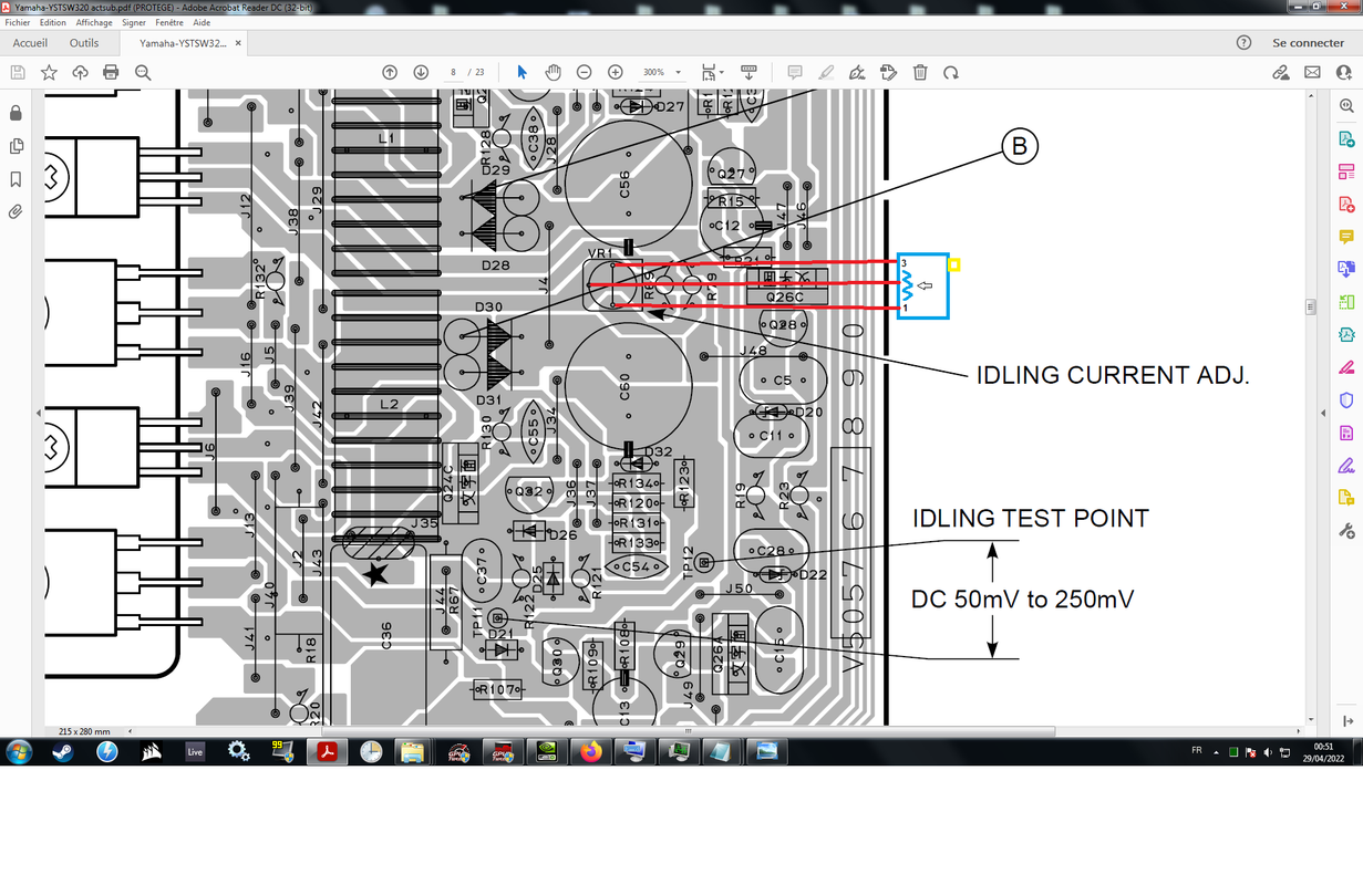

I have a Yamaha YST-SW320 which is a 250 watts powered subwoofer , I want to change the pot that serves as an idling current adjustment , the thing is the 1 turn pot that is already there ( which is a flat horizontal type of pot ) always change its value due to vibrations inside the speaker cabinet , I bought some Vishay 25 turn vertical pot to avoid this problem , i need some advice to mount this in a correct manner , here is a screencap of the schematic :
The pot is named VR1 on the schematic , so my question is what is the correct way of mounting the new pot ? Do I need to solder the pin 1 of the new pot after R79 ? Or the pin 1 should go before R69 ? It seems like the wiper is shorted either with pin 1 or pin 3 like in this picture :
Thank you for your help .

i would just lock the original pre-set with some Loctite SF7400. if it was mine

25 turn pot does not sound like a good idea as a bias pot.
As others said locktite.
Jeff

Ok guys , but as Jeff eelcr says why this is not a good idea with the 25 turns pot if it has the same resistance value (here 470 ohm trim pot ) and superior wattage rating (flat pot is 0.25 watts Vishay is 0.5 watts ) , do they have a different behavior as a bias pot except for the number of turns? I just try to understand why ? Thanks !

Old pot is 3 pin, new pot is 3 pins. What is causing confusion?

If bias is off you might have to take to long adjusting a 25 turn pot (overkill for sure)
also wire wound?  There are some adjustment disadvantages to hi turn pots having to
do with the contact point of the wiper at some positions.
 What it will do in your unit I do not know as you have them you can try it, the resistor
part goes across the two points and the wiper goes to the center hole, the PCB is most
likely already connected to one of the other points but check anyway.

Yes the new ones are 3 pin pot , if the bias is off i can just measure what is the actual resistance value of the flat pot between the wiper and the pin that is connected with it and adjust to the same value with the 25 turn one before soldering it and fire it up; this can be a good start , and i know it's overkill but the shop where i got them , i got a discount coupon around so i got them for nothing in terms of price , they have only 1 turn pot and 25 turn , and my bad it is some Cermet trim pot not Vishay.
Here is the pdf for @Jeff eelcr just in case :
https://cdn-reichelt.de/documents/datenblatt/B300/3296-SERIES_ENG_TDS.pdf
So the good way to solder the new one is like this right ? :
Or the opposite , pin 1 and wiper connected together , and pin 3 solo ?
Thanks
Alex.

Either way will work but to be correct short wiper and 3
measure 1-3 turn clockwise does reading go up?
If so correct if not reverse.
Jeff

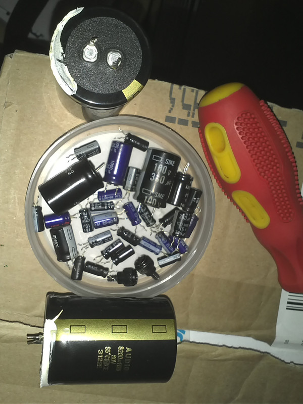

Ok , for more precision the sub is a second hand i got it from a guy that toasted the woofer , also the bridge diode was toasted too don't know the reason why but i replaced all the elecrolytics capacitors at least a good part of it especially from the main power board and some around the bridge diode :
The big caps were the most pricey , 8200 uf 80 V ,  38 $ each  :wtf: bought them directly from a yamaha service repair , put some rtv-167 under them  , for the bridge diode i used a sony equivalent , at first it was an unbranded thing .

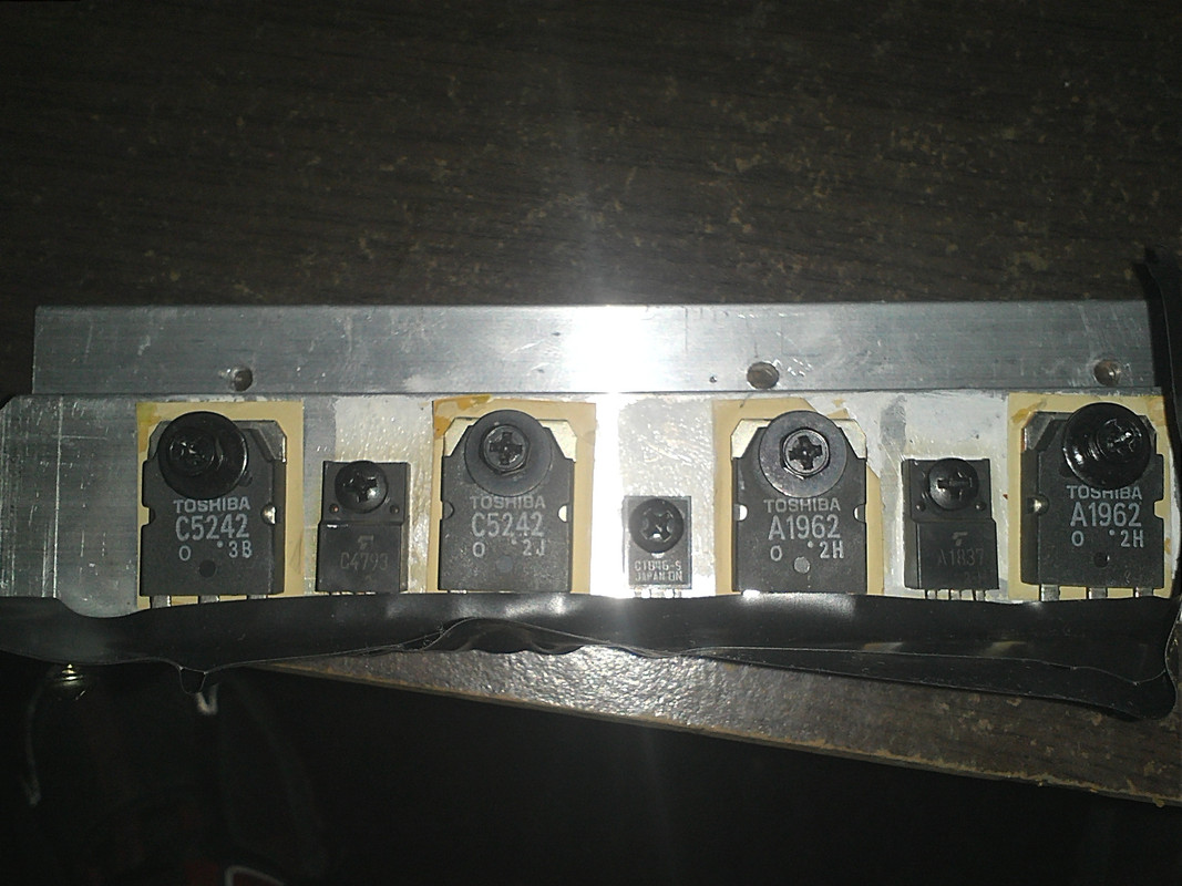

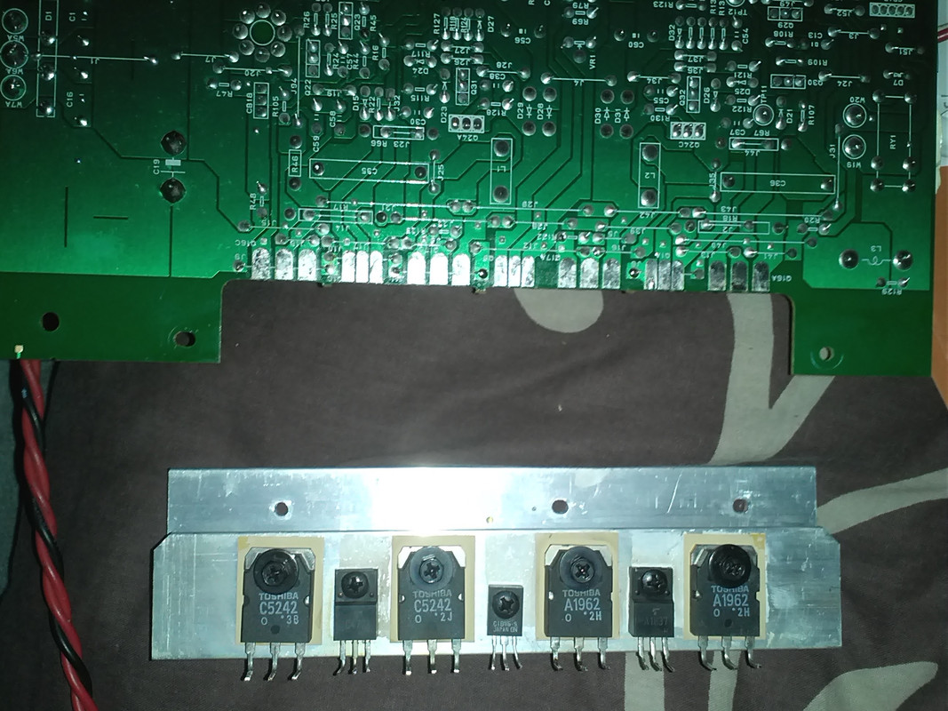

Then i replaced all the silicon insulation thermal pads behind the transistors here is before after for you to see :
This was before , and after :
I got lucky because non of them was toasted , but just in case i ordered a bunch of them cause now they are discontinued products  :palm:
And then the trickiest part was to find a woofer replacement , the original one had a Protection grill on top of it , so you could barely see what was behind (cone or suspension ) and with their weird impedance , 6 ohm , it's not so common , i finally bought a woofer from an yst-sw 315 (brand new boxed ) , which has the same power rating and same impedance but a higher stiffness , i destroyed the old woofer by cutting the grill , the suspension and the spider and yes the voice coil was toasted , i mean like really toasted . Anyway, this thing sounds great for the price i managed to get it .

Alex note the O on all the outputs, your replacements should also.
Jeff

Yes , O version has higher DC Collector/Base Gain hFE and DC current gain hFE value , in my replacement parts there are some O and some are R so i'll keep that in mind not to solder the R version if something go wrong in the future .
