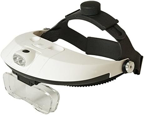

On the other hand there are cheap head-worn magnifiers slightly different from the above design, with multiple lenses included and the ability to use two lenses together, at a greatly reduced price. At first I had my mind made up, aiming for the Donegan Optivisor, but then I came across a video by Adama Savage (from the TV-show "Mythbusters):
Adam Savage's Favorite Tools: Wearable Magnifiers!
... where he highly recommends the 101Color Head Mount Magnifier Glasses with Detachable Ultra Bright LED Head Lamp - 5 Interchangeable Lenses: 1.0X, 1.5X, 2.0X, 2.5X, 3.5X Magnification (Amazon.com). I've found similar magnifiers (and I believe also the exact same model) at Ali Express as well.
(image source: Amazon.com)
Another video praises a similar type of cheap headband magnifier:
Clayton Darwin: Best Magnifiers for Electronics (and Old Eyes, Crafts, Etc.).
Obviously they aren't for professional use, and there's no way the optics can be on par with something like the Donegan Optivisor, but will it be good enough for the occasional use for an electronics hobbyist?
Apart from saving a few bucks on not getting the Donegan Optivisor, what I like about them is that they come with multiple lenses (Donegan's only comes with one, and although you can buy extra ones separately it makes us hard to decide up front which strength I'd need when there's nowhere locally I can actually try them out).
I also like its ability to combine two lenses, which the Donegan can't.
Finally the built-in lamp looks useful (but I wouldn't get one of those Ali Express ones with a built-in rechargeable battery -I've heard of cheap, exploding batteries before, and I'd avoid having that risk close to my face and instead have one relying on regular batteries).
