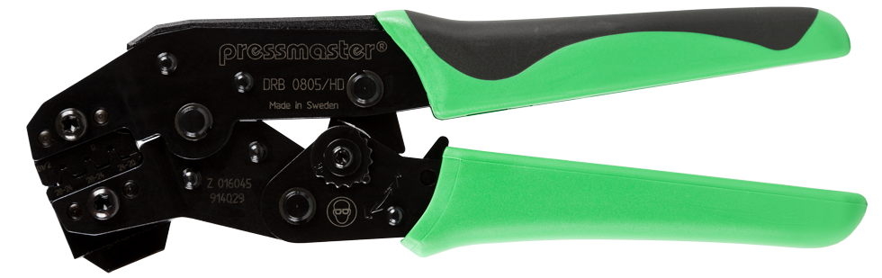

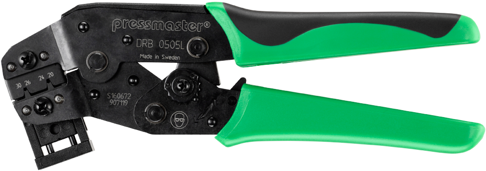

Surfing around I have come to the conclusion that Pressmaster are/were likely the original OEM for Molex's tools and likely some Xcelite crimpers that I favour
https://www.pressmaster.se/wp-content/uploads/2015/01/DRB-0805-HD_980.png
https://www.pressmaster.se/wp-content/uploads/2013/05/DRB0505L_00012.png
Yep, that's well-known. But not terribly relevant here, as they violate the "affordable" constraint of this discussion. ;)
(WEZAG and Sargent are other big ODM crimper manufacturers.)
