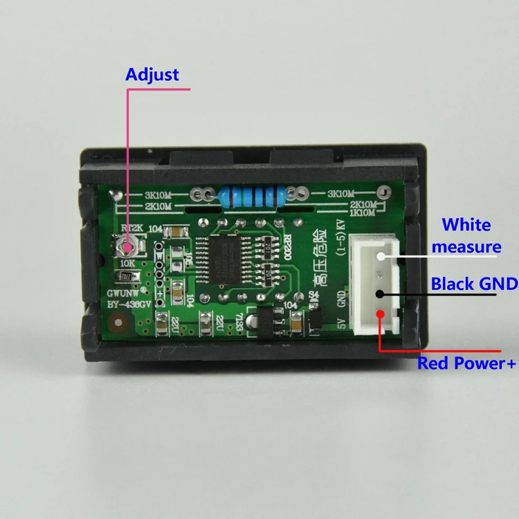

Hi everyone,
I've recently stumbled upon high voltage panel meters like this one for instance (picture linked below). There are three versions rated 1, 2 and 3kV. (The silk screen even states 5kV). The meter uses a 3-wire JST connector, 2 wires are used for the 5V supply the third is supposed to be the sense wire. The insulation on most JST cables I've seen is only rated for 300V, I also have my doubts that the connector is safe at 3kV. Is this dodgy or am I missing something?
Cheers Traceless.

The connector looks like is from the XH(originally JST) series, which is rated for 250V - so the answer is NO.

No expert, but you may also look at:
- voltage rating of the resistor(s)
- electrical isolation between high voltage and the
  5-12V supply (maybe not a problem using a 9V
  battery)

What specs?  Do they give any?

That looks quite questionable to me. I suppose that if they removed one of the pins, then in theory they are juuuuust barely meeting the 1mm/kV rule of thumb, but that makes no allowances for any contamination, humidity, or anything.
Well they kinda give some specs below the picture you have "Customer reviews" and right next to it "Specifications", not that it helps much but here is what the specification box says.
Yeah that was my thought as well. Originally I was actually more worried about the JST-cable than the connector TBH. Somehow the voltage source needs to be connected to the port. I guess you could put additional heatshrink around at least that should only break down at 600V+. However if Zoli is correct the connector seems to be the weak link indeed with a 250V rating.
