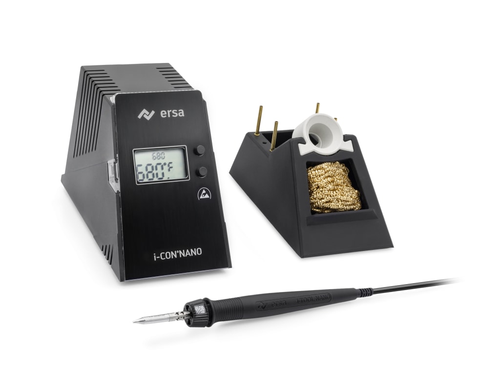

Previous discussions here suggest the Ersa i-con Nano over other brands and models. On Ersa's website there's an i-Con Nano Mk2 which I assume is a replacement for the (non Mk2 version).
(image source for 'Nano Mk2': Tequipment)
(image source for original Nano: Amazon.com)
I have no experience with either, and according to the specs they're pretty much the same (correct me if I'm wrong) except for perhaps a new 'tip & turn' tip changing feature. If I can choose between the two (old model and the new 'Mk2'), are there any downsides or improvements I should consider? Do they both accept the same tips?
From the two photos above it seems the older model has a backlit LCD display which the Mk2 doesn't. Is that correct?

Don’t read anything into that contradiction; it’s just Ersa’s long-term inability to decide how they want to market the wattage.
I’ve complained about Ersa’s inconsistent power ratings for the better part of a decade now, e.g. https://www.eevblog.com/forum/reviews/ersa-i-con2v-hands-on-teardown-and-mini-review/msg1178220/#msg1178220
Anyway, as someone who has a Mk1 i-Con nano at home, used Mk1 i-Con 1 and 2 at my previous workplace, and chose a Mk2 i-Con 2V for my current workplace: they’re all good.
There is no hardware difference between Mk1 and Mk2 stations other than the color of the front panel. (The station firmware doesn’t even say Mk2 on the display.) They are completely forwards and backwards compatible with the handpieces. (Ersa says this, but I have tested it: the regular (not nano) iTool Mk1 and Mk2 handpieces both work perfectly on both Mk1 and Mk2 stations. They show up on the screen as simply iTool.) I assume this is the case with the nano, too, but I have no way to test it.
I would definitely go for the Mk2 because the bayonet-lock tips (series 142) are much easier to switch than the screw-lock series 102, and additionally, they are actually cheaper! With the 102, you really have to spend another 6 euro to buy a collar for each tip, so the price of a tip is really its retail price plus 6 euro. The 142 tips have the locking collar permanently attached, but perversely, often cost a bit less than the 102 tip (without the collar!!).
You cannot mix tip generations; a Mk2 handpiece must use 142 tips, a Mk1 handpiece must use 102 tips.
Ersa claims the Mk2 have 20% better performance than Mk1 due to improved heater and tip design; that may be so, but in normal everyday use I can’t tell the difference — both perform well.
The i-Con nano does not have a backlight, which actually annoys me enough at home that I added my own backlight to it. This, and the rear-mounted power switch, annoy me just enough that in retrospect, I wish I’d just bought an i-Con 1 instead. (I also prefer the rotary encoder for setting temperature rather than buttons, but that’s a matter of taste.)
Good to know in case I come across a cheap "old stock" Mk1 Nano, or a used one.
I personally prefer the original front panel; the Mk2 appears "cheaper" made, and I don't understand why they even kept the up/down buttons black -almost like they wanted to camouflage them.
Irritating about the missing backlight.
How did you add a backlight to it?
Is it a matter of just opening it up, disconnecting the existing LCD's cable and attach a new pin-pin compatible LCD which does have a built-in backlight?
I suppose it's more of an irritation the more frequently you use it, but for occasional hobby use it's probably OK (even though I'm sure the manufacturer could easily have solved both issues without much increase in cost).
I prefer the silver fronts, too, but in the end it makes no functional difference whatsoever.
I installed some 3mm white LEDs with series resistors to side-light the LCD. Because it was still under warranty at the time -- and because I didn't have another soldering station handy anyway -- I just press-fit the wires into some convenient vias or something. It's not super bright. I should probably redo it now that the warranty is over, soldered in with brighter LEDs, or maybe I can even find a backlight module that would fit.
The LCD in the nano/pico is a custom LCD, with pins, soldered into the PCB. There is no such thing as a pin-compatible replacement. (I vaguely recall that maybe there were even PCB pads for a backlight. It's possible they envisioned it but then left it out.)
