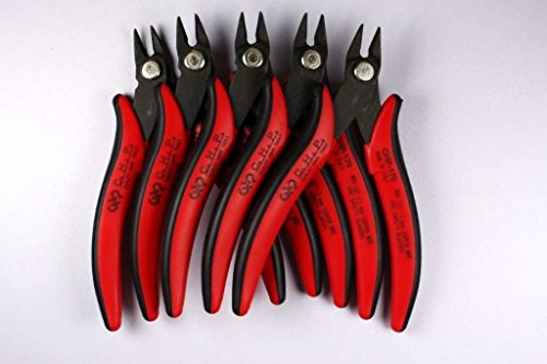

I bought the Hakko CHP Micro Cutter from Amazon last year.  $30 for 5 pcs.  So far, the first one is still doing pretty well.  I could recommend them.  I don't consider myself a heavy user though so your mileage may vary.
https://www.amazon.com/Hakko-CHP-Micro-Cutter-Clean/dp/B0063GL7UM
The following users thanked this post: analogueAdder
I got a free pair of the Hakko side cutters. I tried them and realized I much preferred the Harbor Freight ones, believe it or not. I use them about once a month when I can't find the Harbor Freight cutters on my messy bench.
Maybe because they were free?  Kidding! ;D
But I guess still for the price, the Hakko's are hard to beat!  And I found out that it's even cheaper if you buy them individually @ $4.47 a piece! |O
https://www.amazon.com/Hakko-CHP-170-Stand-off-Construction-21-Degree/dp/B00FZPDG1K?th=1

Hakko sidecutters are actually made by Piergiacomi http://www.piergiacomi.com/piergiacomi/
On the first sight they look and work good, however steel used is rather soft. If you try cutting anything other than pure copper wires, cutting edge will become dull and bent in instant.
