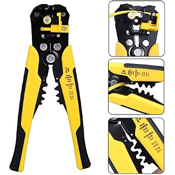

I have a "K.Y.P." automatic cable stripper, like this:
They are also branded as C.K, Stanley, Irwin, and Gardner Bender. (and I found "Högert" and "Toolzone" branded pieces during my image search.) All these tools are identical except for the color.
It works pretty well on typical NM-B type jacketed cable. You can also use it to strip the wires, however I prefer using an Ideal Stripmaster to do that.
The cable stripper does not work on UF-B direct burial cable, because that does not use a loose jacket, but a rubber extrusion that surrounds the wires. To dress the wires you need to use a penknife (in the US, we call them X-Actos). You can also use the penknife to cut NM-B jacket, as long as you are careful not to nick the wire insulation. In some situations this is more convenient because the K.Y.P. tool is 10" long and requires more working space.

As for the previous post, I have a pair of automatic cable strippers like those made yellow ones made by Vise Grip and use them for everything from 10 gauge to as fine as 28 gauge with zero issues or damage to the conductor. They're especially nice when stripping solid conductor wire.
