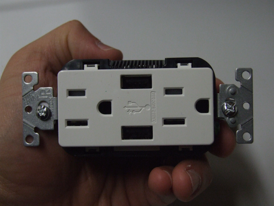

The other day I decided to get one of these USB wall adapters from a reputable brand (Leviton T5632) and take a look inside its guts before installing it.
I was glad to see the quality and the build were very reasonable for its price (US$24.00 in the local store).
Faceplate
Another shot of the faceplate

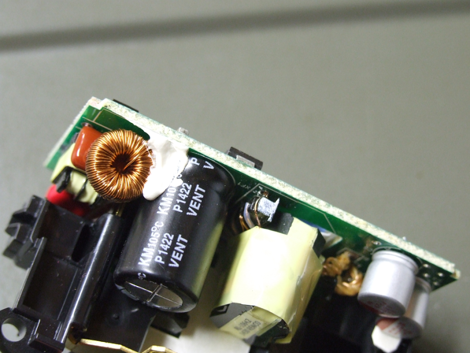

Filter inductor, main cap (Capxon, but at least it is 105C), flyback transformer and DC filter caps (not sure about their brand)
Another view with filter caps, flyback transformer, main cap and inductor filter

These things should never be manufactured. Sockets are 40 years plus old in houses over here. I wouldnt want to leave something like that on 24/7. Plus they aren't meant to last year's. Crapxon caps lol! Also a stray AC wire comes lose and touches a USB shield?  Primary and secondary sides not spaced enough either and AC input close to USB port. No fast blow fuse that I can see either.
In the photo of the main board there's a yellow fuse mounted in the rectangular cutout (LittleFuse 3A).  Can't see the other markings, though.  Could be a slo-blo, but at least it's fused.
