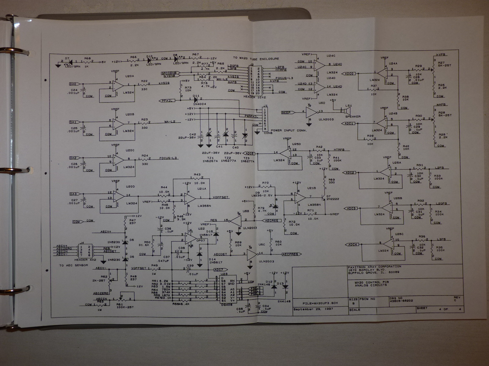

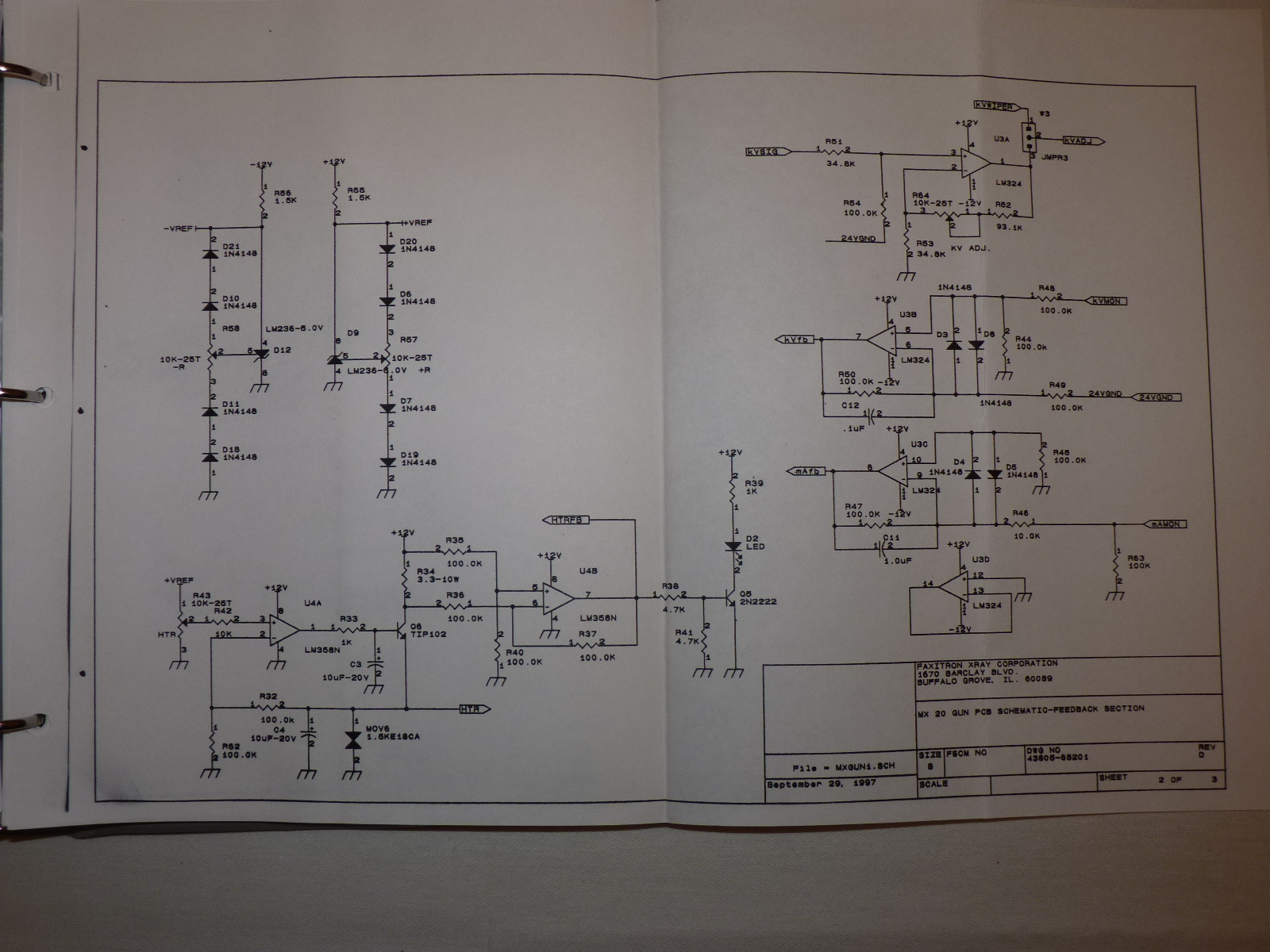

« Reply #82 on: November 23, 2022, 08:55:24 pm »
I queried Gamma High Voltage and the current monitoring is a 1kOhm resistor + capacitor + 2 Diodes placed across GND and HV return. So a negative voltage is expected. This is also confirmed by the schematic having an inverting amplifier (-10x) on mA feedback.
I believe the oscillation is actually occuring in that case and not just a readout bug. Once I have the chance I'll probe the current setpoint and see if it's oscillating as well.

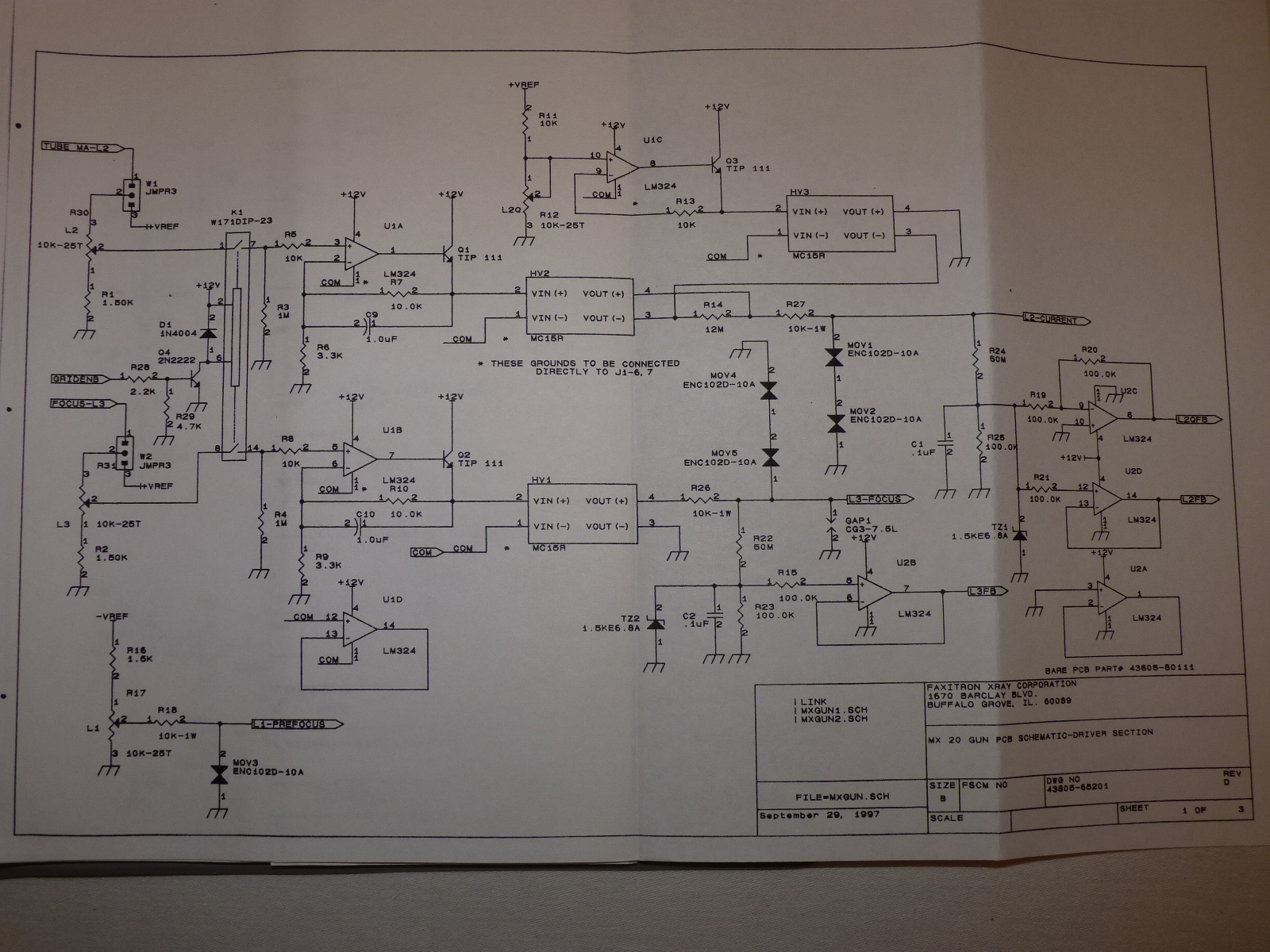

Offline KaneTW
  • Posts: 811
Re: Faxitron MX-20 Reverse engineering (with some good results)
« Reply #83 on: November 24, 2022, 06:58:42 pm »

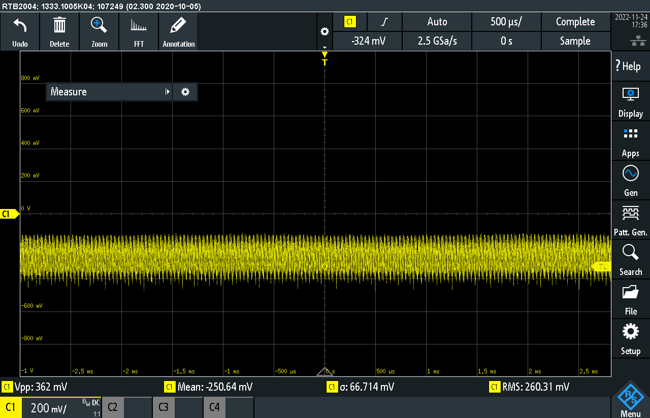

I've probed the current monitor with my scope and the it looks like EMI to me. I've debugged further and noticed a peculiarity.
There's a reed relay (Fraser, can I post the schematic?) K1 that ultimately switches the L2-Current an L3-Focus outputs. It does so via switching the wiper output from the L2/L3 pot to an opamp.
The voltage before the relay is nominal. The voltage after the relay is much higher -- I've measured:
Wiper: 1.31V, node after relay (R5/R3) 3.3V
then 1.47V -> 5.26V, then 1.56V -> 6.08V
The inverting output is at most 2.3V, so the opamp goes to its max possible output of 10.5V pretty quick, which corresponds to about 9.2V on the BJT emitter that is upconverted to the tube control voltage.
I need to take out the gun board and probe some more, but it's a huge pain to reach the bottom srcrews...
Offline Fraser
  • Posts: 13480
« Reply #84 on: November 24, 2022, 07:05:59 pm »
No objection to showing the schematics.
I will look in the service manual to see if there is anything in there to assist you.

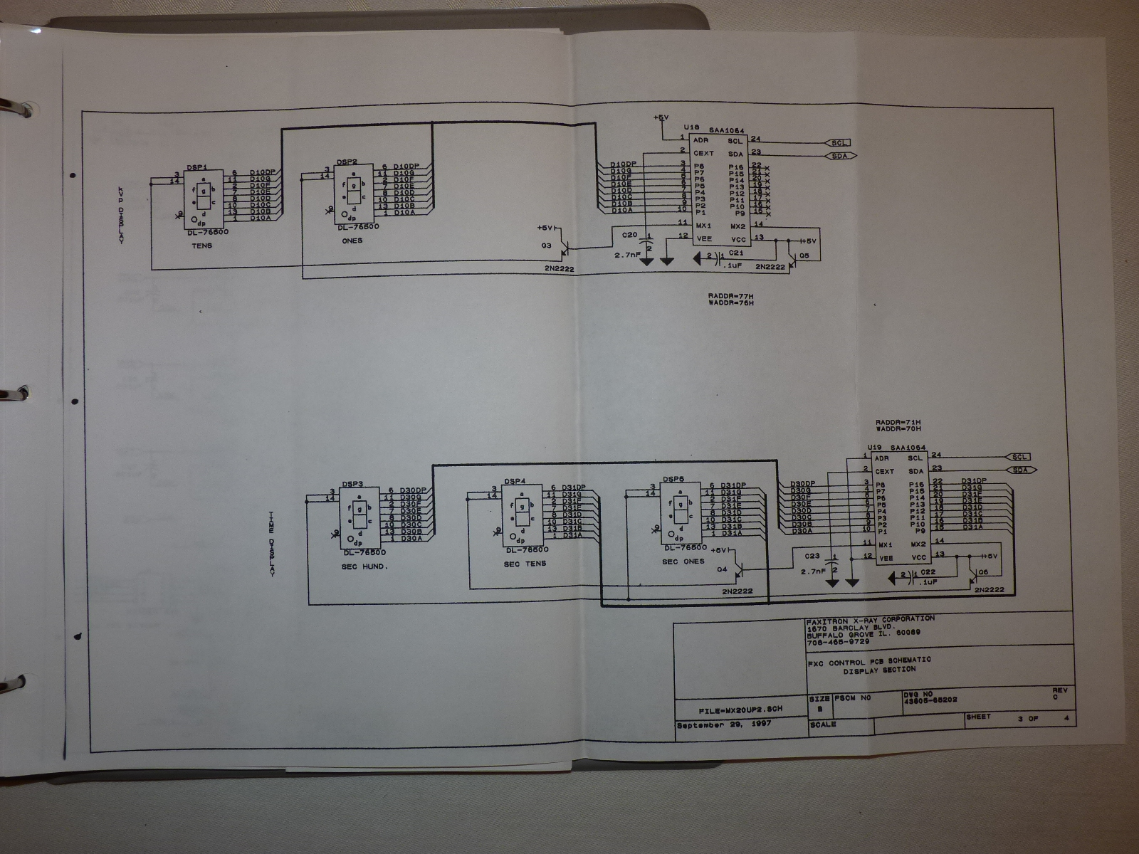

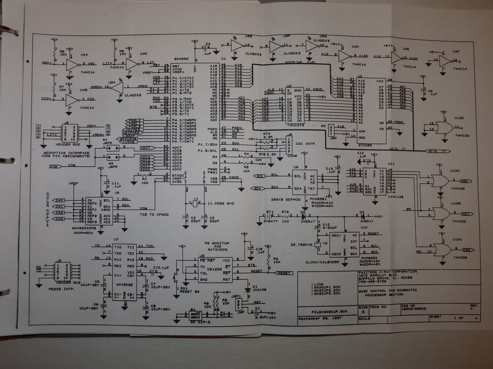

Here's the set of links:
Gun board: https://i.kane.cx/dFTeBu https://i.kane.cx/8JmAtu https://i.kane.cx/xvgpbQ
Controller board: https://i.kane.cx/H7T6TI https://i.kane.cx/GmY9hV https://i.kane.cx/VGPG0v https://i.kane.cx/TGXgZR

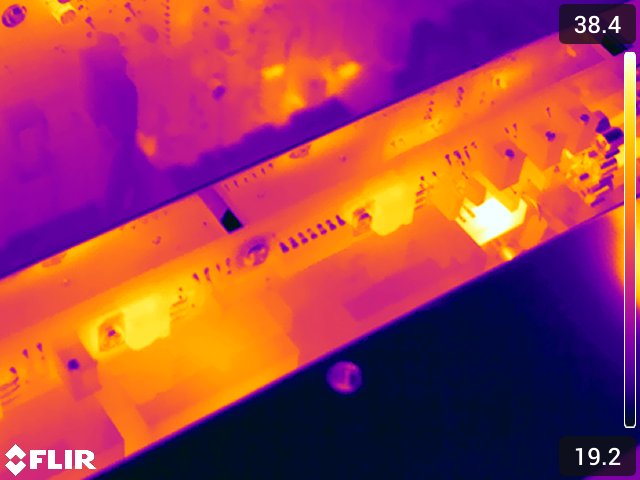

Gun board annotated with measurements:
Thermal cam shot:
The component getting hot is the reed relay K1. The temperature did not noticeably change whether it was on or off.

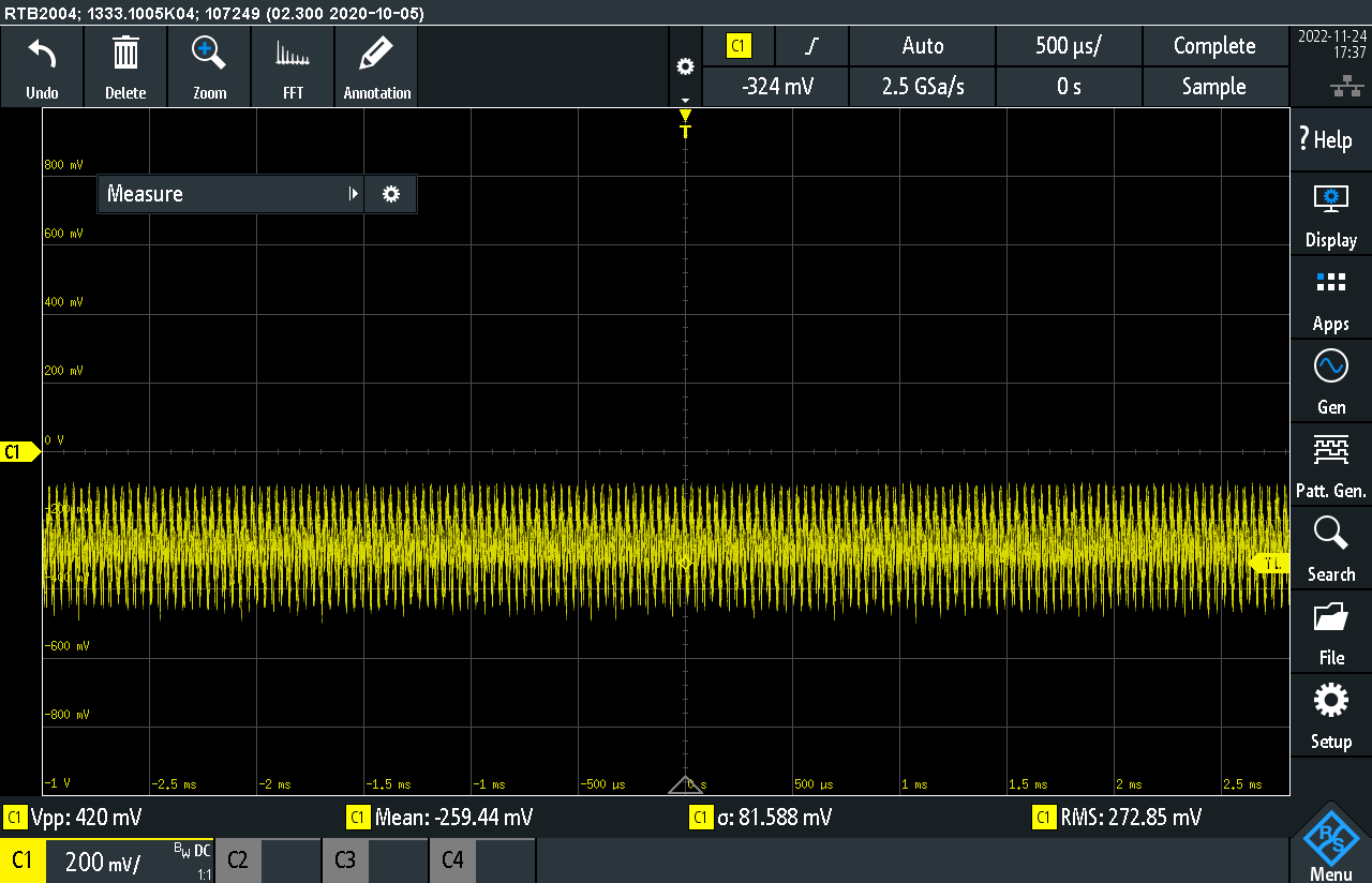

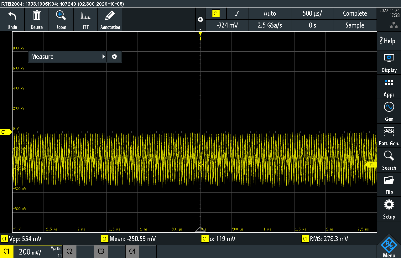

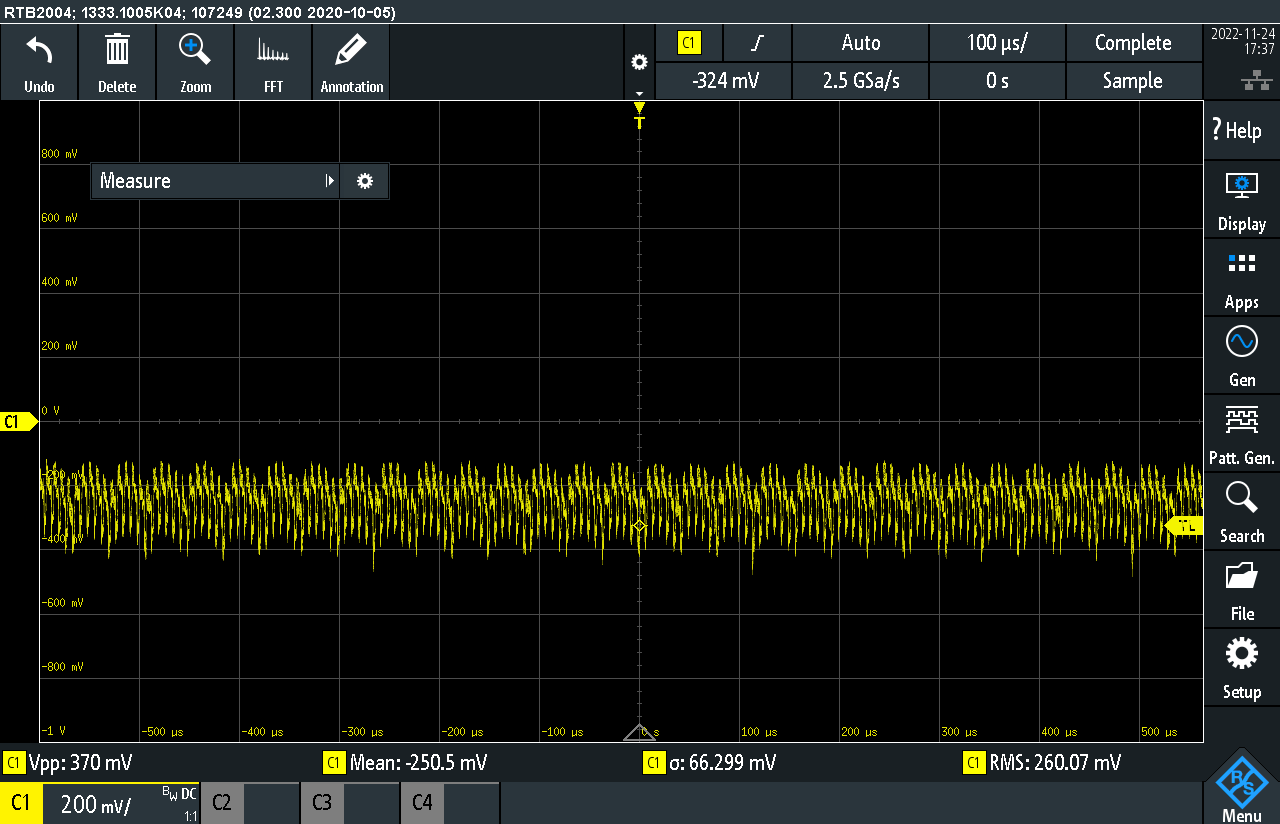

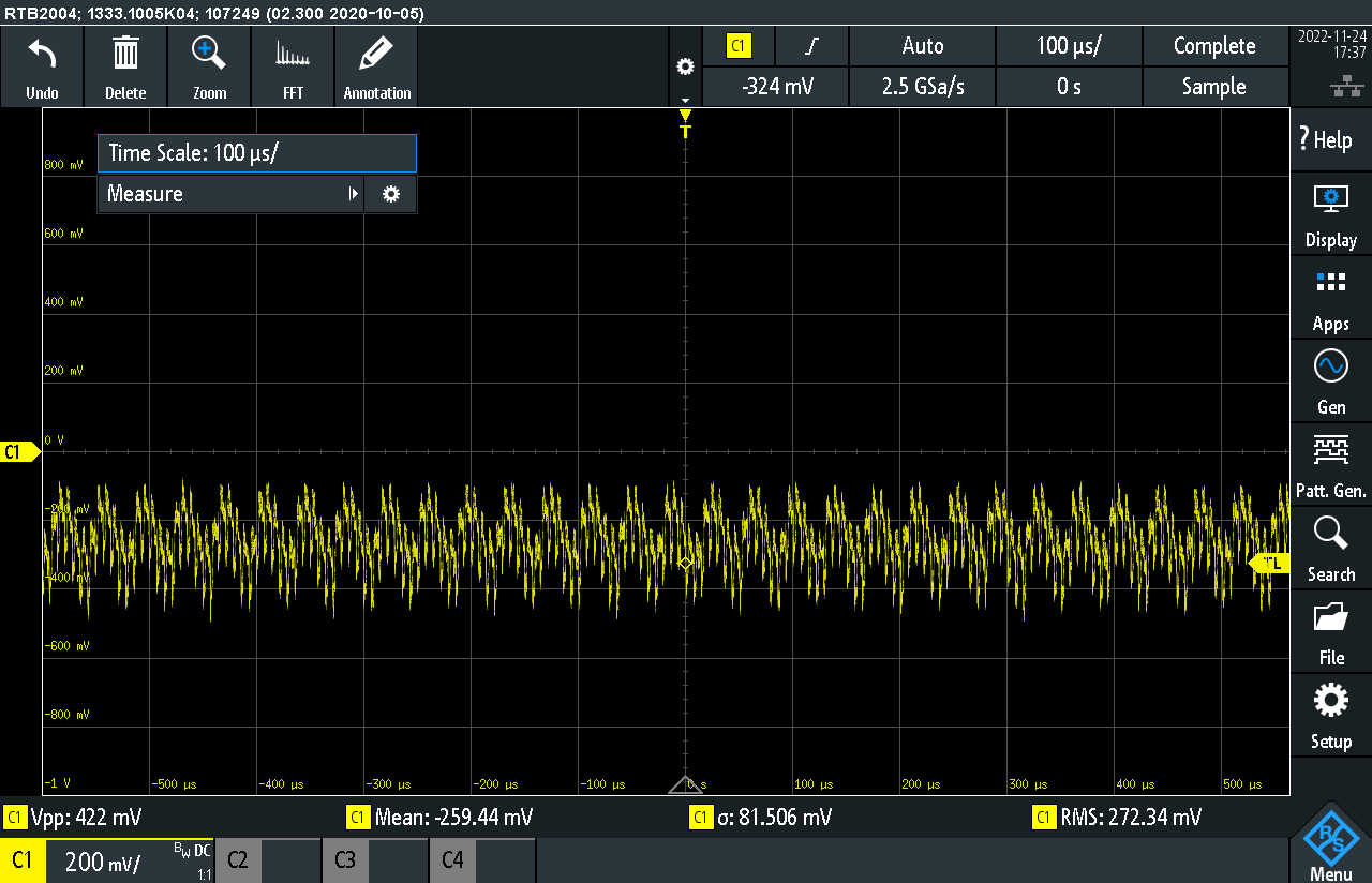

Some scope shots of the mA current output:
10kV: https://i.kane.cx/Mh6Z1i https://i.kane.cx/qQl6TF
20kV: https://i.kane.cx/FQfNOj https://i.kane.cx/3cXARo
35kV: https://i.kane.cx/s8l59J https://i.kane.cx/gcR71o
The high frequency content is always present and I'm pretty sure it's just EMI/bad probing (the current output port only fits a multimeter lead). The ~25kHz content however is increasing with increased kV, so something's weird there. Note that the average remains roughly constant at -250mV.

« Reply #86 on: November 29, 2022, 01:08:21 am »
After some debugging I noticed that L2Q was set to a way higher value than the manual specified, around -280V. It does claim that you need to follow the tube test sheet but I adjusted it to -200 or so and got closer to the 0.3mA of current that it should have. Still can't go above it (so really bad SNR at lower voltages) but that's good enough for me since I image at max voltage.
