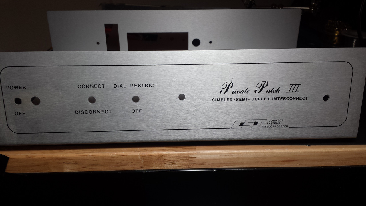

I have an aluminum chassis with an etched face. What are my options to cover up or remove the etching? I'm repurposing the chassis for another project and I'd like to remove the lettering on the faceplate. Is it possible to paint over the etching without the lines bleeding through? Any ideas or tips would be appreciated.
TIA

This is one of those pictures is worth a thousand words thing, rather than taking the effort of throwing out ideas that aren't going to work in your situation.

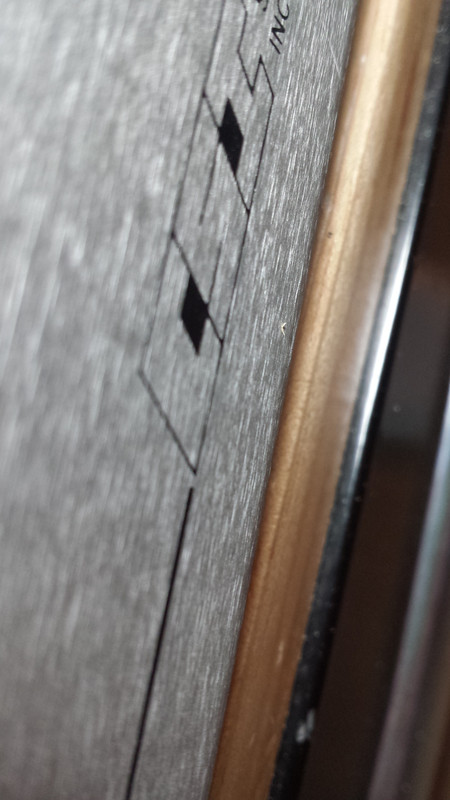

Here are the pics that i've posted on another forum. There has been some debate on whether or not it's anodized or polished. I did some digging online on how to test for each surface....
"An anodized surface will show essentially infinite ohms" and "if there is continuity, there is no coating"
Also...
"Scrape a penny across an unobtrusive portion of the metal.If the penny is able to scratch the finish, the material is polished aluminum. If the penny leaves a streak of copper on the item, then the surface is harder than the copper and the piece has been anodized."
The results of these tests were that the penny did not leave copper, only a scratch. Continuity and an ohm reading other than infinite required swapping my 'needle point' leads for a set of thicker alligator clip leads. A small amount of pressure had to be put on the test points in order to get these results. I still don't know if I should use the caustic removal approach or just sand it. Any thoughts?

Sandpaper. 220 then 400. I would use the aforementioned sponge or just a  finger-platen and focus on the lettering. Like painting, you want to blend it in over a larger area. Then paper over a large diameter dowel or a Bic lighter to blend in the edges without rounding them over.
400 grit is fast, it hides imperfections, and it looks amazing on most metals.

The caustic solution can etch aluminum quite easy, but the printed labels my protect the surface.  I would go for sanding with relatively fine paper. Before that one could try to remove the paint part with acetone or maybe heat.
The bubbling during NaOH etching are mainly hydrogen. The nasty smell / fog is likely aerosol forming, that can be a problem.
A difficulty is that if the etching is fast, the solution will heat up quite a bit and than get even faster and hotter. So once fast it is hard to control. There is also some non soluble residue (e.g. mixed Al-Na-OH) and often uneven etching. The usual aluminum is not pure but one of many different alloys. So not at aluminum behaves the same.
Sometimes on can just flip over the front-panel, having the old label on the inside.

I picked up some 400 through 3000 grit increments and some polish. I want to see my reflection after it's done. Should I worry about sealing the surface? The unit will be indoors most of it's life.
Offline KL27x
  • Posts: 4108
Re: Refinish options for etched aluminium?
« Reply #8 on: April 05, 2020, 06:00:29 pm »
No, I wouldn't bother sealing it. A thin layer of aluminum oxide will form, but it will be largely invisible.
If you want a mirror, that's easy on aluminum. I would only bother with 1000 grit paper, then switch to a piece of leather and some buffing compounds. You want a couple different kinds for speed, ideally. A coarser black one and the fine green stuff. And if you have rubber gloves, this is the time to wear them, else your hands will be black for the next 30 hours.
But you will still need at least 400 if not 220 grit, in my estimation, to efficiently dig the etching out and to get it blended in. Do that part right, then you can worry about how mirrory you want it. Aluminum polishes up like lightning.
If you want a perfectly flat mirror, then you would probably need to lap it.
