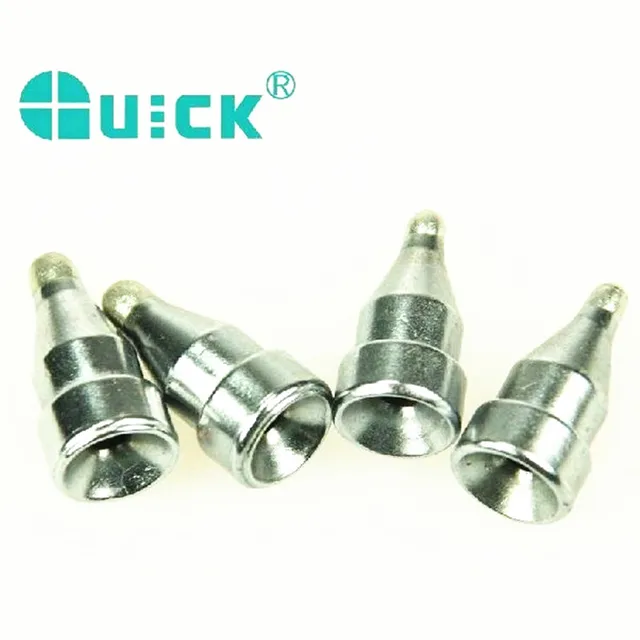

How does the nozzles last?
I see that internal parts are not plated at all.
Compared to QUICK 201B
Now compared to the SORNY ROONG INDUSTRIAL SL-928 that has visible stainless or whatever tube inside the above two are total crap IMHO. But the SL-928 cost 305.63 € that is 3.5x more then ZD915 clones. For some reason the replacement pump is sold at 140Eur. Now it's that good or that overpriced :) And I cant find any reviews of SL-928
And then there is AOYUE 477++
http://www.aoyue.eu/media/catalog/product/cache/1/image/265x265/eb14cea36dacc593d5a676650b3d0309/9/1/91417_1.jpg
