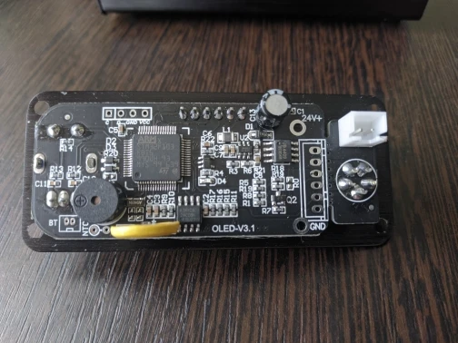

David, i tried to install the firmware without any success, as noted i have HW: 2.0 SW: 2.09 1,3 oled KSGER

Weren't you already using this firmware?
Maybe your stm32 is actually 64KB only?
Post pictures of the errors and your board.

Forget the upgrade messages, those were stlink related. I have no board errors, its just that when i install the firmware the screen is dead.
My stm32 is 128KB, i have the black board -- im not sure about this, i need to confirm
STM32CubeProgrammer says i have the 128kb version (can this be trusted?) searching for the datasheet there are 2 versions available (64kb and 128kb)
the stm32 model is stm32101 rbt6 (Excuse the confusion, i thought by the review i had the one i said, but its this one)
And no, i wasn't using the firmware.

Offline DavidAlfa
  • Posts: 6885
Re: CFW for KSGER/Quicko STM32 Soldering Stations
« Reply #1633 on: August 10, 2021, 11:55:13 am »
You should flash ksger v3 fw. Ksger versions are confusing, because the mix hw/sw v2/v3 versions.
If you read the readme... It clearly states to not flash based on the version reported by the original firmware, instead, compare your actual board with the pictures.
First of all, make a complete flash erase to ensure it lets you to do so.

« Reply #1634 on: August 10, 2021, 12:09:31 pm »

« Reply #1635 on: August 10, 2021, 12:32:46 pm »
Will try this now, thanks
Flashed, now its working as it should. How dumb am i:palm:
Now putting it at 450 celsius i get 250 celsius
