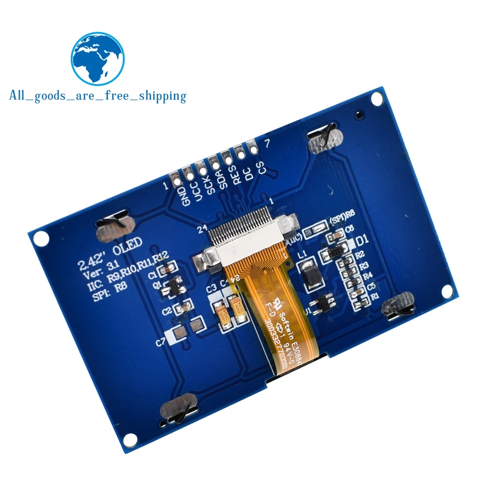

David, thanks! Didn't expect you to answer this. I used the firmware from the KSGER_V2_I2C_Timing_Test archive. The image has improved slightly. Then I installed pull-up resistors for SDA and SCK, with a nominal value of 2k2. In the display itself, 4k7 resistors were already installed, I did not remove them.
The image is now stable, but sometimes there are slight glitches. This can be seen in the video when the soldering iron cools down in sleep mode. For example, at a temperature of 179 and 100 degrees.

« Reply #2257 on: October 13, 2021, 06:12:23 pm »
Leave the standard resistors for now, I want to make it work without modifications.
Can you post pictures of the connections?

Take a picture from the rear of the oled module and the current connection in main board.
Could be any little thing...

Attaching photo. The display is switched to the I2C mode:
  • 0 Ohm resistor moved from position R8 to R11 (connects pull-up resistor R7 to SDA)
  • installed resistors 4k7 in positions R9, R10, R12
  • removed linear stabilizer Q1 3.3 Volts, replaced by a jumper
  • installed tantalum capacitor 4.7 uF in position C7
« Last Edit: October 13, 2021, 11:26:56 pm by Polf »

« Reply #2264 on: October 13, 2021, 11:02:28 pm »
What about the DC pin? Should be connected to gnd, not floating.
That display has very weird gnd traces. The gnd plane is connected only in the pads where the oled is hold, then everything else is routed to gnd using thin traces.

I tried all the firmware, the display does not work normally. But even the firmware from the github works with 2k2 resistors. DC is connected to the ground.

Try also 1K or 470ohm resistors, it won't cause any harm.

With 2k2 resistors in SDA and SCK, the following firmware works fine:
