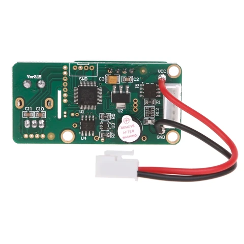

Hello,
I have a KSGER V2.1S board, very similar to the one pictured on github:
It's currently wired to a T12 Handle, but I bought a C245 handle and would like to use it.
I've browsed all the pages of this thread, but I'm Very confused about how should I wire it...
Some posts mention a jumper/resistor to be removed, does this PCB need the modification?
Where is the Jumper? And I've also read that instead of removing the Jumper a 1MOhm resistor should be inserted, is it correct?
And how should I wire the handle?
There are 3 wires: Green,Blue and RED (going from the tip to the tail of the cartridge),
Are these GND, Sensor and +Voltage (the T12 uses these colors) or GND, +Voltage and Sensor?

Not very straightforward in this board!

« Reply #4344 on: February 09, 2025, 03:41:09 am »
Ive got the ksger board as shown in the image, cant seem to find the resistor draining the battery but the battery is always dead so i assume its there, the github also mentions this is a bad LDO design board, could someone explain the best fix for my situatuion? I plan on desoldering the batttery and using the connector bottom left instead aswell as replacing the MM32 with a genuine one i have flashed the cfw onto.
Im also wondering what the input voltage for these units are? Ive seen people use these with milwaukee batterys etc.
Also any ideas what connector i would need bottom left? Its not a JST ph2.0
Cheers  :)
« Last Edit: February 09, 2025, 04:04:52 am by Norto »

« Reply #4345 on: February 10, 2025, 11:20:05 pm »
12-24V will be fine, but the heating power will drop to 50% at 18V and 25% at 12V.
Probably the battery just died. Just fancy and not really needed. You could fit a 1-farad super capacitor which charges from 3.3V through a diode, use low leakage type, should hold for weeks.
As long as the LDO doesn't give problems, don't worry and  just use it as-is, if the station starts to reboot randomly then it's probably the regulador overheating.
There're several solutions in GitHub.
« Last Edit: February 10, 2025, 11:23:21 pm by DavidAlfa »
