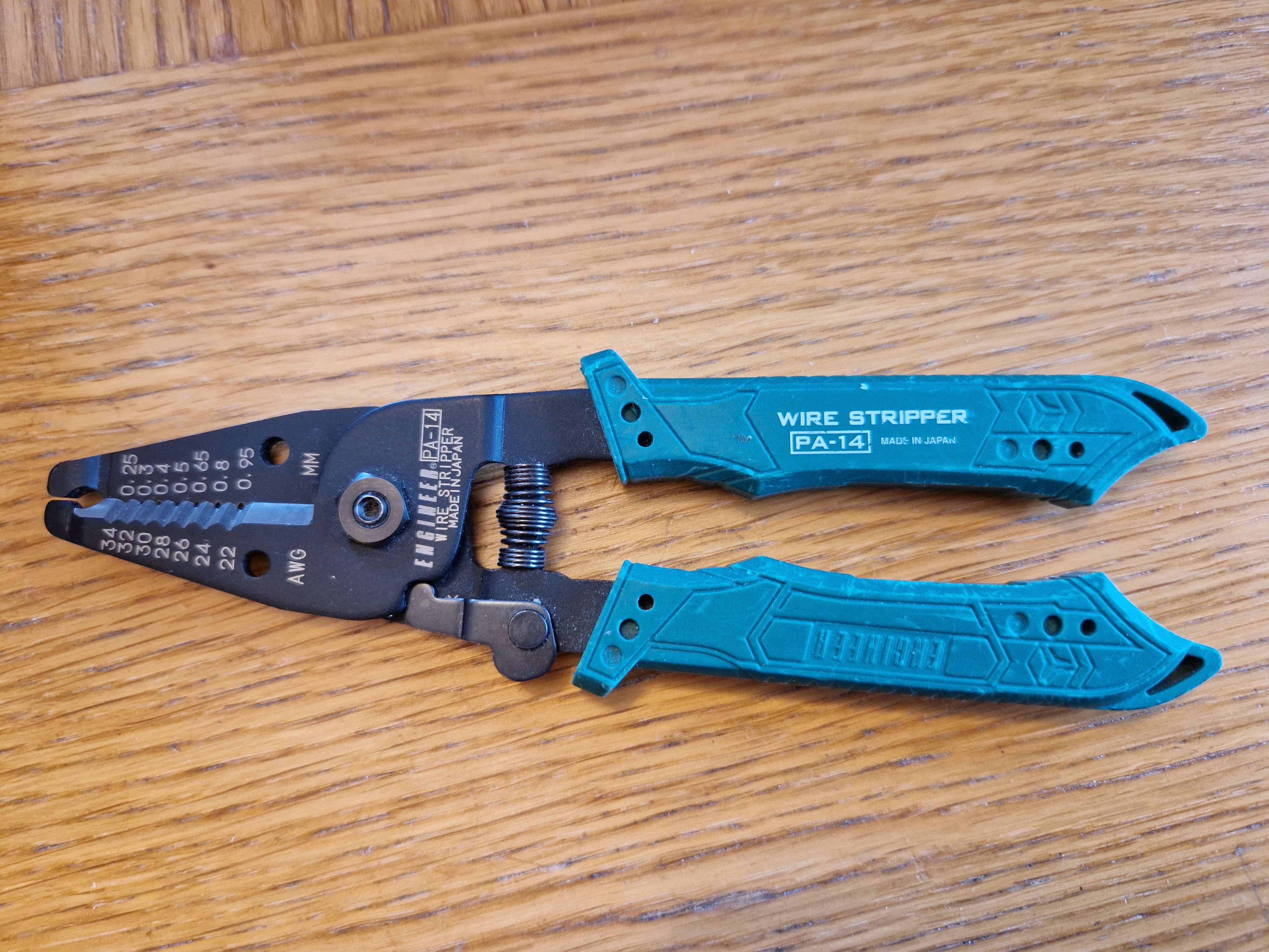

Offline unseenninja
  • Posts: 101
Re: Suggestion for wire stripper for small gauges
« Reply #119 on: November 05, 2024, 01:00:04 pm »
My weapon of choice for fine wires. Engineer PA-14. Goes from 34 AWG to 22 AWG. Sharp and accurate. Available on Amazon.
