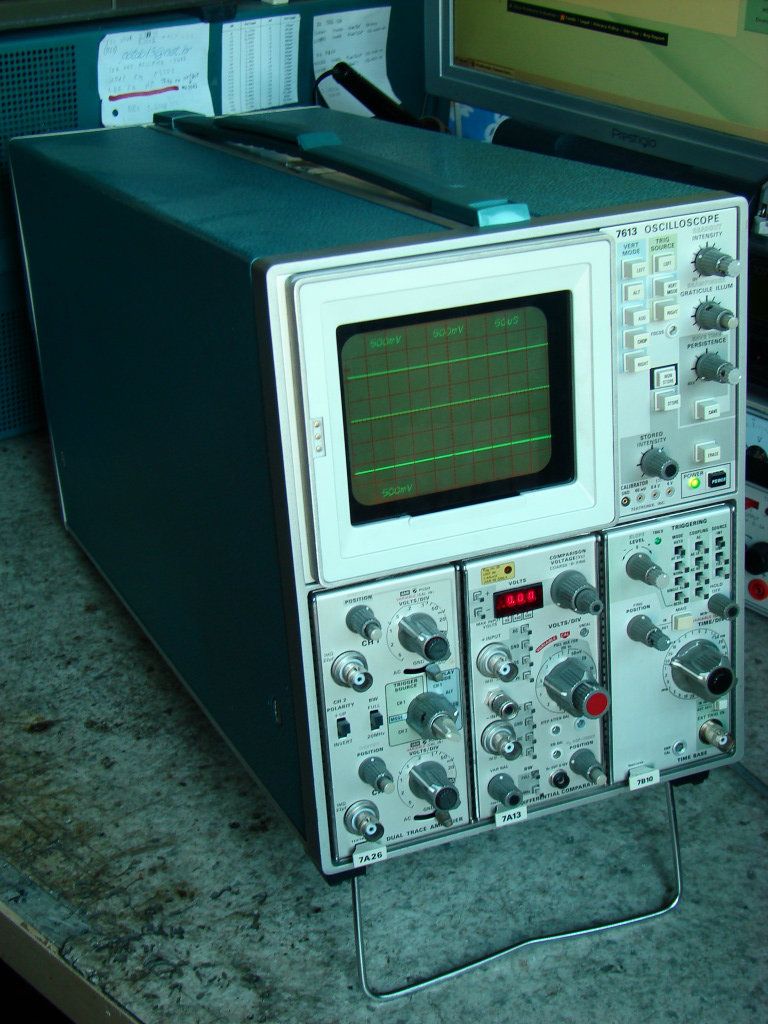

Tektronix 7613 storage oscilloscope mainframe
I got this mainframe off German ebay several years ago. It was advertised as defective, but when I got it there seemed to be nothing wrong with it. This scope is from around 1983. It is an analog storage scope meaning that it can retain the image on the screen untill you hit the erase button. There is also a variable persistance function that will slowly fade away the traces. This is a very nice scope for low frequency measurments, The bandwidth is 100MHz, has room for 3 plugins (2 vertical amps + 1 timebase).
Front panel of the scope
Typical display for the Tek 7000 series. Readouts display vertical sensitivity and sweep speed.

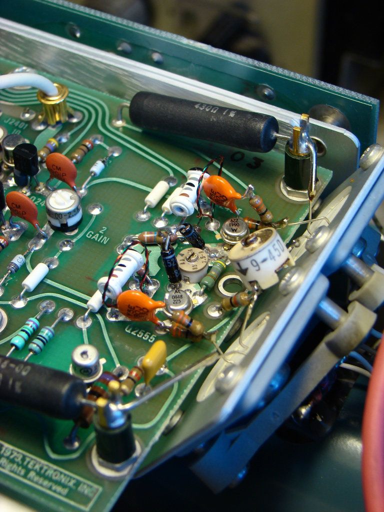

Closeup of the driver stage. It's really hard to get a picture that shows all the free standing components.

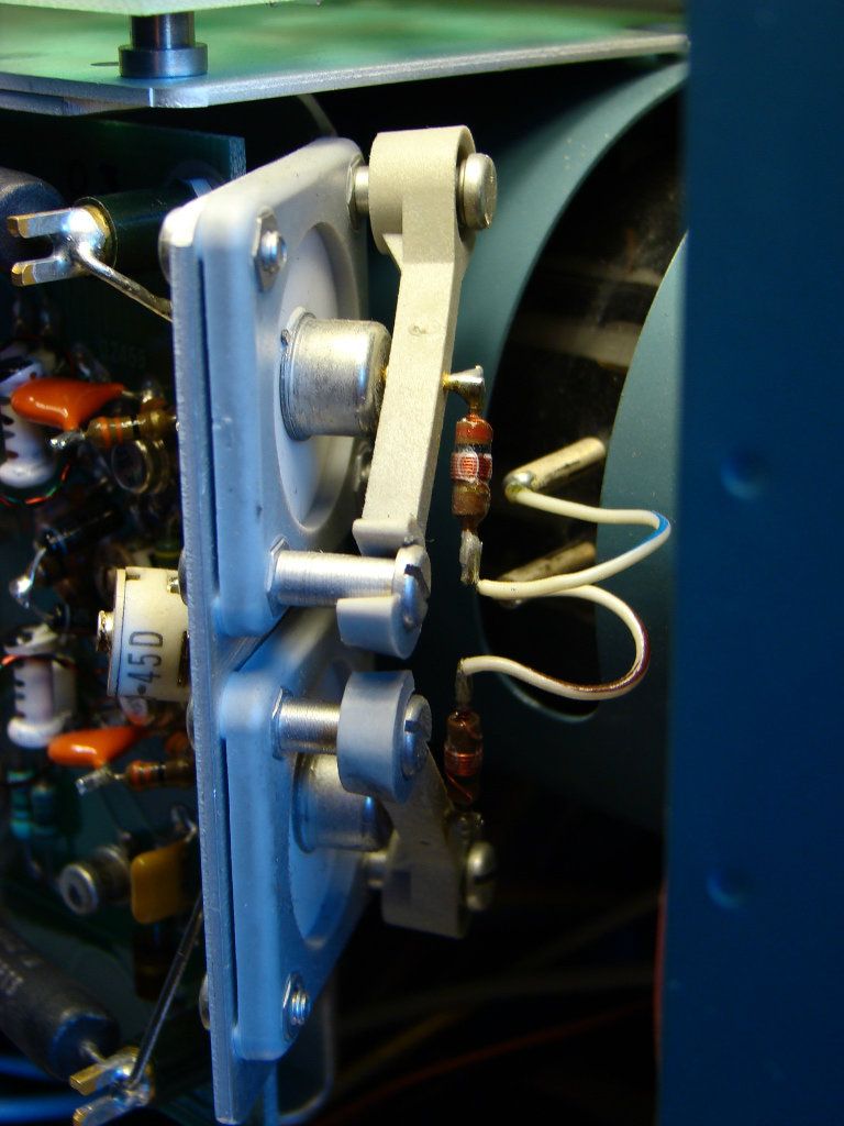

Vertical output transistors. These are connected directly to the vertical deflection plates of the CRT.
They are mounted on a ceramic substrate that dissipates the heat and reduces capacitive coupling which would decrease the bandwidth.

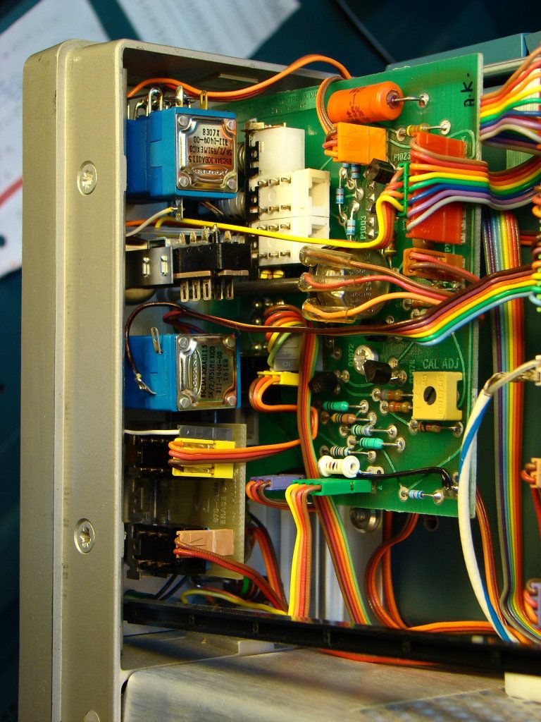

Front panel controls and calibrator board. Very high quality Bourns potentiometers were used.
Now that's a real mains switch. None of that standby nonsense.
