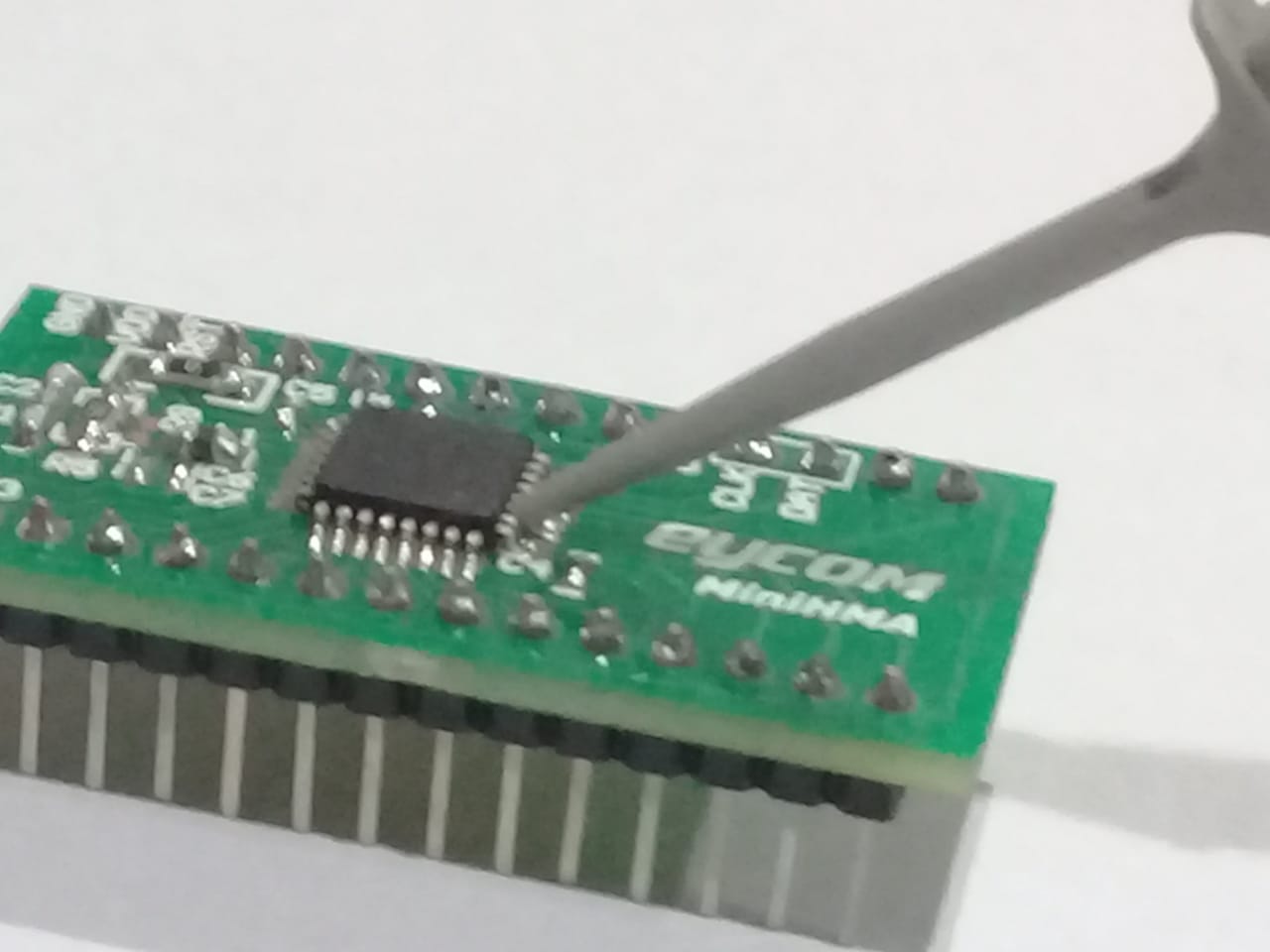

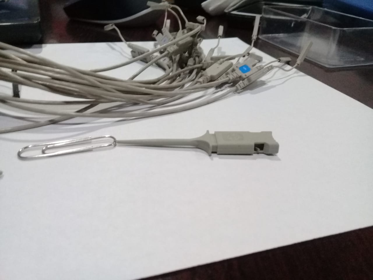

I have this:
I can use it in small soic or even in some low pitch tqfp like this
Sorry for the quality of the pictures
