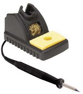

My metcal handpiece and base developed stickiness since I got them new last year from Amazon (they were perfect when new). The problem occured each time I picked the handpiece and it felt as if it is stuck with some friction into the base. I tried to clean it but it did not help so I gently dremmeled the base's hole to have better clearance on the side of the handpiece and now it is awesome again. I wonder if anybody else had similar problem.
I've never heard of that occurring, were they genuine parts?
I think so. It was from Techni-Tool via Amazon and the base and the hand piece cost $160.

The base on all of mine have been metal. What bit is sticky in particular?
I got this base from Amazon. It is made from hard plastic, similar to the hand piece. The base has hole with a few narrowing steps and the hand piece get all the way in until it is stopped by the last step. In this position, the wide round end of the hand pieces had friction with the wall of the base hole. I gently dremeled gently the inside wall of the base hole to increase the clearance.
http://amzn.com/B001BY4848
