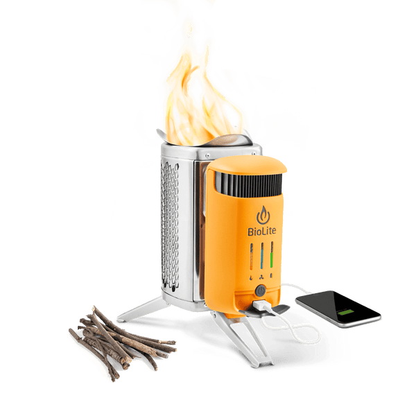

Just ran across this thing I had first noticed several years ago which still intrigues me.
It's a small wood-fired camp stove that, in addition to letting you cook with the fire, generates electricity through a USB port.
I like the idea of the wood-fired stove part of the product alone; you can use twigs and whatnot to fuel it. What I'm not sure about is just how much electricity this thing can generate. What do y'all think about that? How much juice could you expect to get out of this, assuming it uses a thermocouple for generation? I guess if it's enough to recharge a cell phone then that could be worth the price ($200, not cheap).
https://www.bioliteenergy.com/products/campstove-2-plus

I have one.  I think it would take between 5 and 10 hours to recharge a modern phone.
It is useful as a fan assisted fire that recharges its own battery.

I'm still interested in this device, the wood-fired camp stove, but really only for its use as a camp stove, not as a source of power for charging stuff. For that, solar might be much better.
I'm wondering what it would take to DIY such a thing: the stove itself shouldn't be that hard, maybe using stainless steel sheet for the body and wire for the grill parts.
The electrical side would consist of
1) a thermocouple or Peltier junction or whatever to generate the electricity,
2) a simple battery w/charge controller and
3) a small fan
The stove might be able to operate without the fan, so that might just be icing on the cake.
Anyone care to suggest what it might take to build such a thing? This would just be for my own amusement and use, not for production.
I'm guessing it might involve some welding, although if it could be done instead by riveting, so much the better. (Might not last as long but would be far simpler to build.)

Analog Kid,  I have pulled mine apart to look at it a long time ago. The only thing that was not obvious (peltier, hot heatsink cold heatsink) was the SHAPE of the hot heatsink that goes into the flame.
It was a copper round that had a slot cut in it.  This slot was out of the flame area and the whole copper part was slopped up.
This looks to me like it was engineered to limit the rate of heat going into the peltier.

That is the hot end that pokes into he flame.
The cold end is a normal ally heatsink that is in the path the fan draws cold air past to blow into the fire.
I can't find a long enough screwdriver right now to pull the main body apart.
