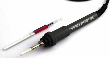

Hello, i receive my "YIHUA 908+"
there is no temperature sensor, no transformers
i can't use it imediately, because it's a china plug, and i receive a us/euro adapter! >:(

« Reply #6 on: September 08, 2015, 02:07:14 pm »
It looks like there's at least 3 wires going to the heater, so it does have a sensor, but it's a mains-powered heater which could be difficult to find. I suppose that's why it's so light... although this ideas has been done before:
