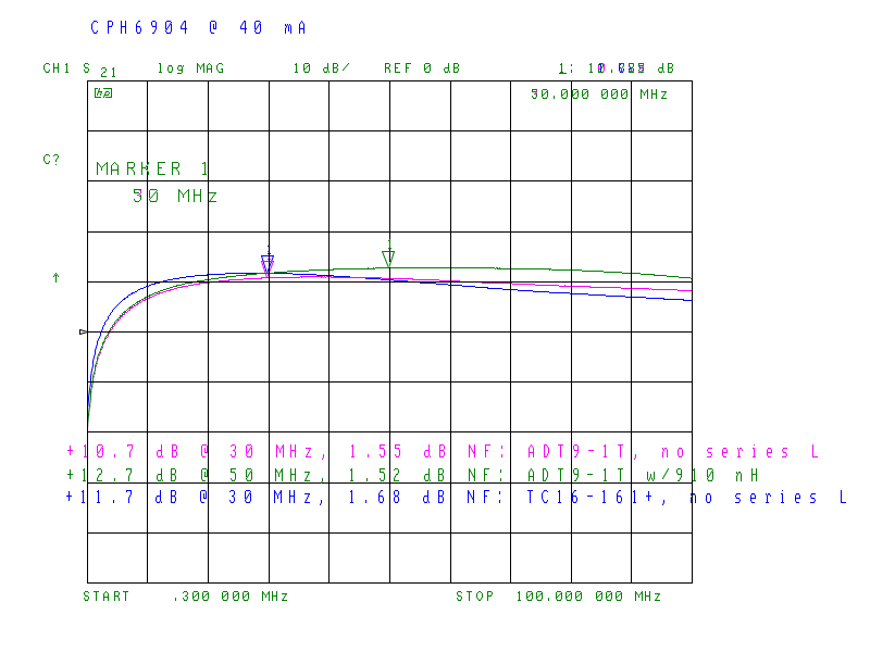

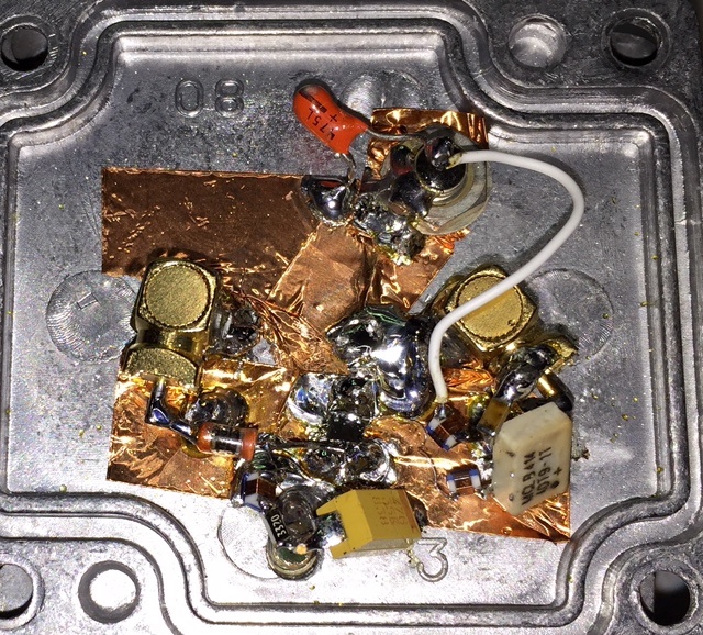

The inductor can be dispensed with if you are interested in HF.  It has no effect on NF or anything else besides VHF gain (and I suppose S22.)
I tried the figure-5 amp just now with a CPH6904 (dual CPH3910) at its max Id of 40 mA in place of the E430.  It worked fine.  Best performance I saw was 12.7 dB of gain at 50 MHz with NF in the 1.5 dB range.  At currents less than 40 mA, the VHF gain fell off, the HF gain came up, and the NF was largely unaffected.  The input impedance varied quite a bit with Id.
I didn't see any peaking, but I also didn't try any inductors other than the 910 nH / ADT9-1T combination in green.
Reverse isolation is more like 30 dB rather than 36 dB predicted by the article, but I didn't characterize it versus Id.  I also didn't check IP1dB but it was +6 dBm with a single CPH3910 configured for 10 dB of gain at 10 mA, so likely better now.
Of course 40 mA at +/- 12V is almost a watt, so you wouldn't normally run the part this hard.  (Edit: there is also some saturation in the Mini-Circuits transformer at this current level, so AC-coupling the transformer buys another dB or so of gain.  NF is unaffected as is the oddly-poor LF performance.)
Good part.  Everybody buy lots of them, so they keep making them.

Nice.  That's a tight match!
Thanks! I'm lucky to have some nice test gear here so I'll try and measure the noise figure tomorrow. My noise figure setup is about as good as it gets for hot/cold Y factor hardware and I think the overall uncertainty is very low. I think the noise figure will be a bit worse when tested at 50R. I'll also try measuring the NF with a simple L match to step up the source to 75R. I'm expecting to see about a 2dB noise figure with the L match.
I did quickly measure the OIP3 and it was a fairly consistent +20dBm across the whole band. Increasing the supply voltage slightly improved it to just over +20dBm.
