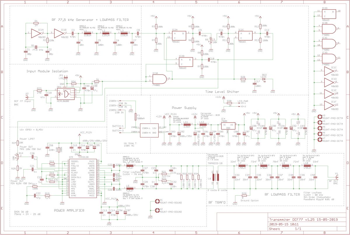

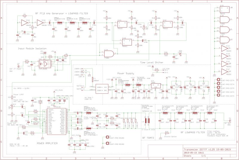

Some time ago I built such a transmitter with a power of 0,5 - 10 W (adjustable)
The transmitter was steered from the "second" DCF77 signal generator
The amplifier has its own 77.5 kHz carrier generator and a modulation circuit.
The amplifier is based on the Audio amplifier working in class D and it is the TPA3128 system, then there is a 50 Ohm impedance matching system.
This is connected to an antenna made of a loop of wire along with a matching capacitor
It is a antenna (loop) system of a coil with an inductance of 420 uH and a capacitor of 10 nF
With a power of 5W, you can easily get a range of 20 - 50m (a lot depends on the building (types of walls) EMI interference (from other devices, power supplies, etc.)
Here is the diagram (If they are interested, more will be provided....)
The following users thanked this post: Miti, croma641, edavid, pardo-bsso, ledtester

« Reply #19 on: October 14, 2025, 08:00:35 am »
I don't know, no idea how it is supposed to work.
Found that project some time ago, by accident, when I was looking for DCF77 transmitters.  In my case, the clock eventually synchronized without any help (after a few days of letting it hanging untouched).  The need for a DCF77 transmitter disappeared, and didn't investigate how that speaker-transmitter works, or if it works.
I had a thought. They do not work, at least they do not work as they are supposed to. I read somewhere that the biggest issue with this DCF77 receivers is the phase noise. They are very sensitive to it. Could it be that only those clicks from ASK are received and perceived as signal because of the high sensitivity to phase noise ?
