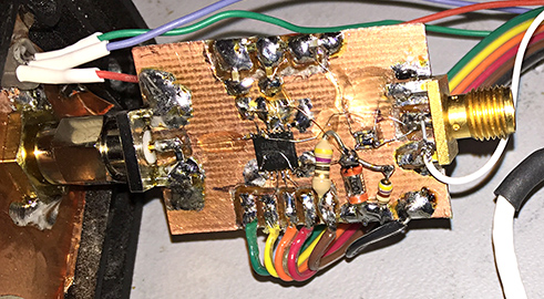

I cannot read that code very well. I have a simple Arduino register loading sketch.
John: please refer to the picture attached. Do you expect any problems from this setup?

Looks like the connections are OK, although the grounding is questionable in my experience with these chips.  (Haven't used the ADF4001 myself but I've used plenty of ADF4002s.)   I'd recommend mounting the chip directly to copper, either live-bug or dead-bug style.  Even then, you want to keep the VCO and reference paths away from each other.
For example, here's an ADF4002 with a small 38.4 MHz VCXO just to the right of it (click for much larger version):
Also, you might try a wider loop BW to begin with, say 1000 Hz.  Is R1 in series with the charge pump output?  If R1 is 60K and Vp is +5, your charge pump current can't exceed about 80 microamps, regardless of the Rset resistor or Icp register values.  So the loop may be OK in theory but not in practice.  Post your ADISimPLL file if you like.
Edit: Another pitfall that's not in the book is that those ceramic SMT capacitors like the 0603 (or 0402?) part you have between pins 4 and 5 are hard to hand-solder reliably.  The end terminations like to detach without leaving any visual evidence.  If the cap survives soldering, it may also open up due to differential thermal expansion during normal operation if a small length of wire isn't used as a strain relief.  Not too likely here, but if (e.g.) one end of the cap were soldered to a ground plane and the other connected directly to an IC pin, thermal stress would be a concern.
So you might unsolder the capacitor to make sure it's actually OK.  Afterward, use a new capacitor, rather than reinstalling the old one.

There isn't a link to a Web page, just the photo at http://www.ke5fx.com/4002lg.jpg .  Is it not showing up?
The photo is a 10 MHz reflock circuit for the original bladeRF SDR which replaces the onboard 38.4 MHz clock.  Basically the same thing you're doing at 100 MHz.  Ground integrity was important in both the analog and digital areas of that circuit.  I had a lot of trouble with trashed registers when connecting and disconnecting external cables, until I went back and bonded the bladeRF board, AVR controller board, and the PLL board itself securely to the metal enclosure.

To establish lock the CP cap is quite indifferent. I get lock from 100 nF to 100 uF. Of course loop dynamics is completely different....
Thanks to you for your comments. Highly appreciated.

For phase noise measurements at oscillators I have built a Phase Noise Testset by an article from DG4RBF, UKW-Berichte 4/2015. Not particularly easy to construct but it works good. Normal spectrum analyzers can not be used for serious phase spectrale analyses, as you know.
But this is another story....
