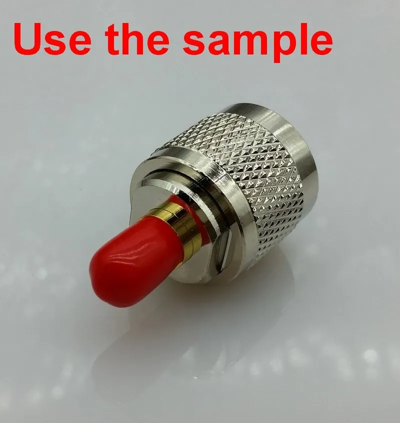

Hi!
I'm looking for somewhere I could buy a few hundred of silicon cover for SMA connectors like these:
A bit longer is better, and as this is for a company, I need a faster and bit more reputable supplier than an AliExpress seller.
I found theseat McMaster-Carr, can anyone check if they will do the trick? Specially if this material material wil really get snug in the hexagonal SMA nut. The hardness should tell me this, but I'm not used to this scale and not so confident.

Hey folks,
I generally agree that the metal ones are better for using in equipment. But this is not my intent - I want to cover tens of SMA cables that will be loose in the installation for further expansion (it is a big and complicated machine and passing the cables and installing them at the racks all at once will be much better). Using the metal threaded protection is cost prohibitive and an overkill.
I'm not worried about the threads because it will cover the nut on a male SMA connector, not the thread on the female. In my experience, however, the rubber works better for cables and loose adapters, as it will protect the thread from impact up to the bottom of the thread, while the metal cover will only cover the beginning. I reserve the metal one for equipment-mounted connector, with the small chain attaching it to the chassis.
The exception is off-the-shelf instruments, which usually do not have the anchor for the chain. In this case, I try to use a saver connector instead of connecting the cables directly to the equipment connector. Rarely used connectors are covered by either hard plastic caps or metal caps.

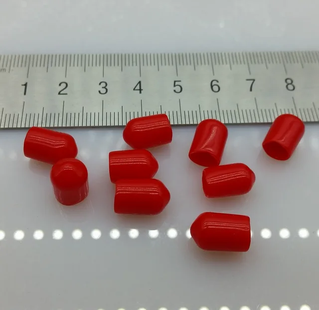

Any good? I weighed them out at 400+ units. I usually throw them away, they're a PITA to remove when you're testing hundreds of units at a time. :scared:
You can have them for nothing other than a virtual beer.

« Reply #11 on: September 10, 2018, 07:30:23 pm »
Well, I can't pass such generosity, but I insist on paying shipping and a real beer. I'll DM you.
