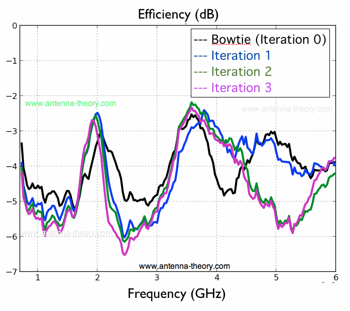

This is an interesting topic. Basically this guy made a fractal antenna and compared it to see which is better. Do you think that his results were right? I wonder if his fractals didn't perform as well because they are sensitive to small details like asymmetry having a huge effect on performance. What I'm trying to figure out is what makes it work at which frequency? Is it the angles the length the length of each segment? I have one of my own I'm making but I don't have access to a SWR meter or much else besides plugging it in and seeing if it works. The wikipedia page is lacking.

Next, we look at the antenna efficiency. This is shown in Figure 9:
fractal antenna efficiency
Figure 9. Antenna Efficiency for the Bowtie and Iterations 1-3 of the fractal Antenna.
Figure 9 is very interesting. At the low frequencies (700MHz-1.5 GHz), the baseline case performs better than the fractals. In fact - as each iteration occurs on the bowtie geometry, the low frequency antenna efficiency gets worse. This is very interesting. One of the reasons fractal antennas are touted as valuable is that they are able to shrink the size of the antenna - if this were the case, the lowband efficiencies should get better with each iteration.
There are some regions where fractals appear to have better performance - 2 GHz and 3.5 GHz (for instance) - but it is not significantly better. In fact, there are wide bandwidths where performing the iteration to make the fractal actually degrades the antenna efficiency. Hence, this data shows that implementing a triangle fractal (of Figure 2) as an antenna adds little to no value, and can often degrade performance.
This is very interesting. It implies that a lot of the talk around fractal antennas is in fact hype. If you have a volume available to you for antenna design, it is best to use a large conducting area (as in Figure 5 - no cut outs or meandering). It is not advantageous to increase manufacturing and design complexity by creating fractals. This may explain why fractals are not widely used.

Fractal antennas appear to be hype, as the article demonstrates. Check with antenna simulation software if you are unsure. There are plenty of free and non-free packages available.

There are lots of fractals, but only a subset of them are useful for radio frequency purposes.
Fractals that have a linear aspect (like a fern fractal with no twist), and geometric self-similarity (i.e., each element is an equal ratio bigger or smaller than the adjacent elements), have wide bandwidth, linear polarization, and directivity along the axis (prime example: log periodic).
Fractals with a radial aspect have directivity along the symmetry (i.e., radially), linear polarization, and wide bandwidth.  Prime example: conical dipole.  (Note that a cone is continuous, not discrete.  At any rate, any conical sub-unit (i.e., not a frustrum) of a cone, is still a cone, so it's geometrically self-similar, without using discrete elements or stages!)
Fractals with a tangential aspect have directivity along the symmetry (i.e., axially), circular polarization, and wide bandwidth.  Prime example: spiral antenna.  (A logarithmic spiral is geometrically self-similar, but an Archimedean spiral also has a similarly useful property of being self-dual, when dimensioned correctly.)
You can mix and match to get other interesting shapes, like the conical spiral, which has circular polarization and linear directivity.
Self-dual antennas have the useful property that their feedpoint impedance is constant and equals Zo/2, i.e., around 188 ohms.  Well, it may not be particularly useful compared to traditional 50 or 300 ohm feedlines, but that's just a balun away.
Fractals that don't have these E&M-friendly characteristics should not be expected to exhibit useful performance compared to simpler designs.  In the above plots, the simple bowtie seems to perform better in some properties!
Curve fractals, like the Koch snowflake, lie on the dubious border between fractals that are practical, and those that are useless.  The property that every sub-segment is at a different angle, length and distance from every other part, means that the radiation pattern won't be much of anything: just lumpy.  If you wanted directivity, you won't get it (and the pattern will vary with frequency); if you didn't want directivity (to get closer to an isotropic antenna), you'll end up with holes.
And if you're going for small antennas and narrow bandwidths, the fractal structure matters absolutely none -- the sharp corners of your intricately cut fractal, can only be "felt" by waves of a comparable wavelength.  For such an application, you can't spare the space for an antenna ten times (or more) longer than your operating wavelength!  For "short" antennas, the shape matters very little indeed; practical designs are usually a whip, or tab, or patch, with some tuning / matching circuitry at the bottom (which may be part of the antenna geometry itself, like the "gamma match" connection).
So the only applications where fractal antennas make sense, are those with very high bandwidth demands (more than an octave), and low to modest directivity.

AFAIK, fractal antennas are just snake oil. I had a run in with a nut case on antenna newsgroups, fractenna?, who made all kinds of claims and just did the insult and run tactic when pushed for real information. Fractals can't change the laws of physics.

Can't beat physics. Your incoming power/area is fixed on a rx antenna, so your gain can only be so high with a certain effective aperture.  So a "perfect" 10mm x 10mm 2.4 ghz antenna may perform the same as a 30x30mm patch with a  lame 11.1% radiation efficiency.   Like others said, wideband and low gain is where they are applicable.

Fractal antennas do actually have some use, they aren't "snake oil." I have fabricated a few myself (both Koch loops and Hilbert dipoles) and tested them with a VNA. There are also lots of papers covering cases where people have designed and optimized them in software like CST and the fabricated them in the real world. Properly designed and matched, they do enable you to squeeze a tiny bit more performance out of a physically small antenna.
Of course, you can't escape the Chu limit, which is where a lot of the confusion with small antennas lies. There is a hard, physical limit, end of story.

They're not really applicable to a lot of HAM work because the amateur bands are very narrow.  It's if you want many bands without touching anything, and don't have the space for a big one like a log periodic, conical dipole or log spiral.
