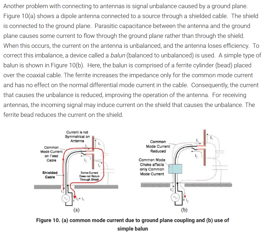

Antenna impedance is a complex value. A dipole in free space at resonance have a typical impedance of 73+j42.5 Ohm.
Reactive part is due to nearfield coupling between dipole element parts and non ideal element.
A dipole can be impedance loaded by its nearfield in different ways such as placed near passive radiators and reflectors in a Yagi-Uda structure. This will affect measured impedance.
One effect of mismatch relative coaxial cable is that cable braid becomes a part of the radiating element. This is not necessary causing a lot of losses but will reduce directivity of antenna as a part of radiating element not is "in focus".
Antenna reactive part of impedance must also be handled for best antenna performance. If it is a narrow band antenna can reactive losses be compensated with discrete single component (capacitor/inductor). To further reduce antenna current along outside of coaxial braid can a 1:1 balun be used
and/or a quarter wave sleeve to create a reflect braid current to antenna dipole element
and/or ferrite material around coaxial cable with function to act as a RF resistor, burning effect else traveling outside coaxial braid. It is not optimal for antenna efficiency to burn neither TX or RX power but it will reduce negative impact on antenna radiation pattern and will make microphone less tingeling against lips, if HAM.
Also can it reduce received noise as coaxial cable will more easily pick up local noise along its way to ground then actual antenna, placed longer away from local noise sources.

Transformer exist for any power level. More then 100 kW is no problem but we keep the biggest coils in steel cages so that they not tries to knock down the house due to fast changes in power or antenna load. Such wild thing have actually happen.
Simplest is to design a dipole such that it is a perfect conjugate match relative radio impedance+antenna cable.
Then is no additional balancing element needed. Different kind of baluns can ensure better dipole balance and ferrite tubes can absorb power that is reflected.
A balun can improve impedance matching by transforming an impedance for better fit of antenna relative radio and it can make it harder for reflektions to reach cable braid at cost that it also affect antenn impedance.

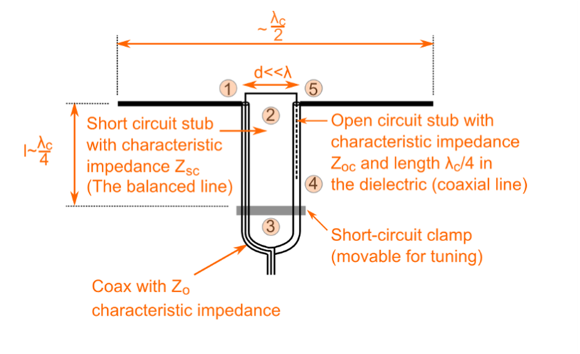

An optimal effective antenna is conjugate matched but various baluns can be added to for example allow wider frequency range.
A Yagi antenna, what kind of balun to select is much a question about frequency, needed frequency range and type of dipole.

This is a kind of balun very common in many kinds of Yagi-Uda antennas: https://encrypted-tbn0.gstatic.com/images?q=tbn:ANd9GcSmRjQyXCOF7QoPZSoxkaSDjUiuHHIOTOgrudU558EXZrwim9hM
Size differs with frequency. It is a cheap and simple design that is "good enough" and easy to design for conjugate match.
Also professional antennas us quarter wave transformer in several ways. This one is popular as it can be designed for very precise performance with aid of a simple tuning and because of that used as reference when measuring other antennas.: http://www.antennamagus.com/images/Newsletter2-1/Roberts-balun-large.png

A such balun can be seen here: [url]http://www.gtemcell.com/wp-content/uploads/2012/02/DSC02335.jpg[/url]
This is a kind of balun very common in many kinds of Yagi-Uda antennas: [url]https://encrypted-tbn0.gstatic.com/images?q=tbn:ANd9GcSmRjQyXCOF7QoPZSoxkaSDjUiuHHIOTOgrudU558EXZrwim9hM[/url]
Also professional antennas us quarter wave transformer in several ways. This one is popular as it can be designed for very precise performance with aid of a simple tuning and because of that used as reference when measuring other antennas.: [url]http://www.antennamagus.com/images/Newsletter2-1/Roberts-balun-large.png[/url]

Excuse me sir,
The differential impedance may be matched, you are quite correct.  (We can assume a dipole cut and loaded for 50 ohms resistive at resonance, for sake of argument.)
But what of the impedance from the element to ground (or to space at infinity, if nothing else)?  It is not infinite, is it?
If it be finite, then is there not some impedance from ground to each terminal of the antenna?  And if the antenna and its surroundings are symmetrical, then would those impedances not be equal?
Therefore, you would have an equivalent circuit of a Thevenin voltage source (the transmitter via coax), connected to the antenna, to ground?
And, you would have a nonzero voltage on that voltage source's common terminal, no?
So if the voltage source is not a balanced line (twisted pair, twin lead, etc.), if it is unbalanced such as coax, there would be a common mode wave (shield currents), no?
Tim

Situation is a bit different for many radio-amateurs placing horizontal or vertical dipole antennas in a garden with its height at a fraction of actual wavelength above ground.
That reminds me a bit about situation in picture below.
It shows a dipole feed by an unbalanced coaxial cable.
If height above ground been high had it been perfectly fine to feed this balanced dipole with an unbalanced coaxial cable.
Due to near and uneven distance from ground is dipole in picture not any longer in balance. Common mode current will flow outside of cable shield.
It is shown in right picture that a common mode choke will reduce the problem.
I have borrowed below picture and some text from: https://interferencetechnology.com/antenna-fundamentals/
I have a bit of similar problem for some of my antennas, that a temporary measurement coaxial cable must leave antenna/PCB plane perpendicular to antenna orientation in a "cold" location of PCB to not affect existing antennas and and its internal feed.
This is an example of how a measurement cable is routed in an early stage of development of an cellphone antenna:
Did these picture somewhat address what you was thinking about?
« Last Edit: September 29, 2019, 01:29:04 am by E Kafeman »
