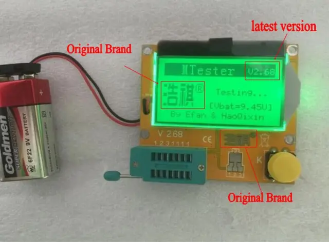

Hi everybody,
Does anyone know why I can't download flash from working Chinese LCR-T4 tester using Arduino together with avrdude as ISP programmer ?
I have this version :
I programmed my Arduino to act as ISP programmer, connected everything, run Avrdude from command prompt :
avrdude -c avrisp -p m328p -P COM3 -b 19200 -U flash:r:"MtesterFlash.bin":r -U eeprom:r:"MtesterEeprom.bin":r -U lfuse:r:"lfuse":r -U hfuse:r:"hfuse":r -U efuse:r:"efuse":r
At first it seemd OK, but later on I saw that flash file is empty while eeprom is OK but only 1KB in size :--:
C:\tester\noovi>avrdude -c avrisp -p m328p -P COM3 -b 19200 -U flash:r:"MtesterFlash.bin":r -U eeprom:r:"MtesterEeprom.bin":r -U lfuse:r:"lfuse":r -U hfuse:r:"hfuse":r -U efuse:r:"efuse":r
avrdude: AVR device initialized and ready to accept instructions
Reading | ################################################## | 100% 0.03s
avrdude: Device signature = 0x1e950f (probably m328p)
avrdude: reading flash memory:
Reading | ################################################## | 100% 20.13s
avrdude: Flash is empty, resulting file has no contents.
avrdude: writing output file "Mtester207Flash.bin"
avrdude: reading eeprom memory:
Reading | ################################################## | 100% 3.33s
avrdude: writing output file "Mtester207Eeprom.bin"
avrdude: reading lfuse memory:
Reading | ################################################## | 100% 0.01s
avrdude: writing output file "lfuse"
avrdude: reading hfuse memory:
avrdude: writing output file "hfuse"
avrdude: reading efuse memory:
avrdude: writing output file "efuse"
avrdude: safemode: Fuses OK (E:FF, H:D7, L:FF)
avrdude done.  Thank you.
Having in mind that fuses are set like this : "E:FF, H:D7, L:FF" - Avrdude should be able to read flash
Does anyone have any idea?

Reading the ATmega is disabled. But you can reset the fuses and program a new firmware. And the "original brand" is laughable. They've taken the orginal open source firmware and changed the display output. And the circuit is also open source.

« Reply #2524 on: September 02, 2016, 10:22:58 pm »
@Pukker,
I tried both the clean boot and the magic lights versions I posted on my unit and they work.
Can you post pictures of your tester?
Is it 8MHz or 16MHz?
What fuses are you using?
@stj,
I also tried your svn684 v2 8MHz it worked fine.  I don't know really know why the 1.24m I compiled works on my AY-AT but not Pukker's.
I've have exact the same unit as the picture in post 2506 from flywheelz
8Mhz crystal
Fuse used:
lfuse:w:0xF7
hfuse:w:0xD9
efuse:w:0x04
Thanks for reply.
