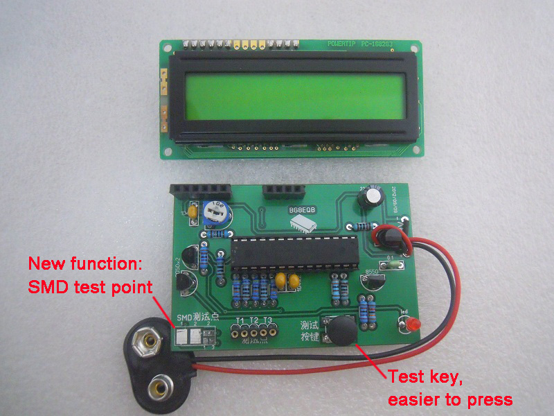

I would like to know if it is possible to reflash/update the firmware on the chip with Arduino board. They seem to use ATmega chip as well. Is it same procedure as with normal Arduino code ?
The old one uses removable chip , while the new one has a tiny chip soldered. So I am sure the new one is not update able.  ???
Old one: /ebay
New one: /ebay

@hunter
See the 10 holes (5x2) on the left side of the new board?
High probability these are for a programming header :)

« Reply #79 on: April 22, 2013, 09:46:14 am »
That's the one I have. I believe the 10 unpopulated holes on the left side are the ISP programming header. I'm going to try upgrading to V1.07 with this Usbasp programmer: http://www.ebay.com/itm/300695243866. It specifically mentions it is compatible with the avrdude software as recommended by madires.
I'll let you know if it works once the programmer arrives and I have time to figure this out.

Here is my early version of the new Tester with some modifications.
The 10-pin ISP header is soldered, but one side of the frame must be cut out
to match the room left for the header.
The original potentiometer has been replaced to a exemplar with higher resistance
(10k) to save power.
Two blocking capacitors of 100nF each are additionally mounted near the ATmega.
The D1 zener diode is replaced by a precision voltage reference like LM4040AIZ2.5 .
If you don't have a precision voltage reference, you should remove the zener diode at least.
I had also replaced the original 78L05 regulator by my preferred MCP1702-5002 regulator,
because this regulator can also save quiescent current.
Regards, Karl-Heinz
