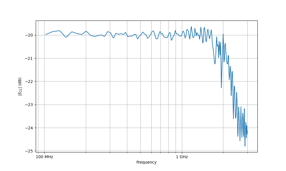

After a bit of radio silence, I have a large update with big improvements to the probe:
I have worked through another two iterations of the probe as there were various specifications that I thought could be improved upon. We're at V10 now.
I also was in contact with Picotech, who generously offered to lend me a fast oscilloscope (Picoscope 9404-16, 16GHz sampling scope) for proper time-domain measurements of the probe. This has been a huge pleasure to use, and I am very grateful to them for lending me such a high specification oscilloscope. I unfortunately have to ship the scope back this week. So yes, big thanks to them! Buy their oscilloscopes!
I now no longer use the optional resistive ground lead to reduce the DUT loading, instead the signal pin is now always resistive. As such there's no longer a trade-off between probe bandwidth and reduced DUT loading. You get both high bandwidth and reduced loading :)
So the main new specifications are:
Bandwidth: 2.7GHz
Rise time: 130ps
DUT loading: 120Ohms worst case (at 1.6GHz).
Tip capacitance: 0.7pF
Return loss on a 50 ohm transmission line -15.4db max
Noise: 350uV RMS output, or 7mV RMS referred to input (20x probe)
Now for the performance plots.
Showing -3db at just over 2.8GHz. Linearity is still very good.
Tip loading is now minimum 120Ohms, and stable out to 4GHz at 200 ohms. My VNA is unstable beyond this.
Step response test from signal generator with 350ps rise time. Probe response is very close to the signal generator, and probe loading has not modified the signal at all. Note red and green lines are almost perfectly overlapping. Note that red and green traces are saved waveforms so they can be overlaid with the probe signal. The probe has a 5.4ns latency.
Rise time measurement using fast edge (70ps) from fast signal generator. This edge has a bit of ringing, so I'm uncertain how much of the probe ringing is because of the source signal ringing vs ringing because the source rise time is so much faster than the probe rise time. Probe rise time around 130ps which corresponds to a 2.7GHz bandwidth. Note probe has only a minor loading on this very fast signal. The rise time is slowed by around 6ps and there is some reduction to the peaking.
Nice flat-topped low-frequency square waves (1khz).
Test setup for oscilloscope measurements. Signal generator routed into oscilloscope (channel 4) via intermediate coplanar waveguide board. Active probe measures signal on coplanar waveguide and is read by oscilloscope channel 2.
I'm pretty sure I've said this before, but hopefully for real this time. I am looking at starting production of these. If anyone wants one, send me a PM to get yourself to the front of the queue :)
The cost will be between £180 and £200, depending on how much of my time I end up spending on each probe. Hopefully more on the lower end of that. The probe tips are hand-made, and there may need to be some tuning on each probe if the frequency response isn't as good as it should be when I test them.
« Last Edit: October 17, 2023, 06:25:11 am by lasmux »

I've been slowly working on a probe based on the BUF802, with some similar specs: 10x attenuation, input impedance of 1 MΩ || 1 pF, Zmin ≅ 100 Ω. I've been simulating and testing one piece at at a time, and put together the first complete prototype this weekend.
It's hitting about 2.3 GHz, and there's no big resonant peak in the frequency response, so I'm probably even leaving some bandwidth on the table. I used a test jig PCB that fits against the front of the probe, but had to "cheat" a little by making another ground connection to lower the ground lead inductance. When held by hand as pictured, the bandwidth is closer to 1.6 GHz.
I'm trying to think of practical ways of keeping the right ergonomics and pushing inductance lower. Unlike the input capacitance that is more or less fixed by the probe design, ground inductance is mostly determined by the user's probing setup. A handheld probe needs to have a pointy shape to get into tight spaces, so there's always going to be a little bit of a loop. Most commercial probes have similar input impedance, so they must have some way to get super low inductance to hit their bandwidth number. And even Keysight mentioned their probe bandwidth numbers are measured using jigs that are not representative of most real world use.  ::)
I suppose more attenuation makes it easier to get lower input capacitance; is this the reason you went with 26 dB attenuation?

Hey, nice probe! Nice flat response :)
I've found that dealing with stray inductances and capacitances is quite difficult, and quite design/layout specific. Some designs were more sensitive to it than others. It's madeningly easy to set up some LC resonance somewhere which causes a big dip or peak in the response at some frequency. Maybe you have something similar at 1.6GHz and 1.9GHz? Those dips are just single data points however so it could just be noise?
Dealing with ground lead inductance is difficult as a lot of things you can try either make the probe more difficult to use, or damage the response linearity/bandwidth. I stuck with using a spring pin probe for the ground lead because it makes probing real circuits much much easier if one of the connections is sprung, even though this ground lead has quite a bit of inductance. You don't have to get the probe angle perfect to get a good connection.
I chose a 20x attenuation for a number of reasons. As you say, it makes it easier to reduce the input capacitance, also, the slew rate on the op amp I'm using is a bit slower so by increasing the attenuation it increases the bandwidth at which the probe becomes slew-rate limited for very large AC-amplitude input signals.
