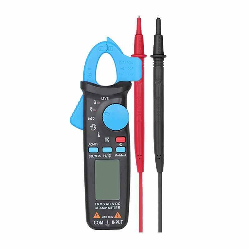

  • Posts: 1170
  • Country: aq
Re: A look at the Uni-T UT210E
« Reply #672 on: July 30, 2019, 03:45:15 pm »
Thanx a lot
and what about ACM91 instead UT210E?
