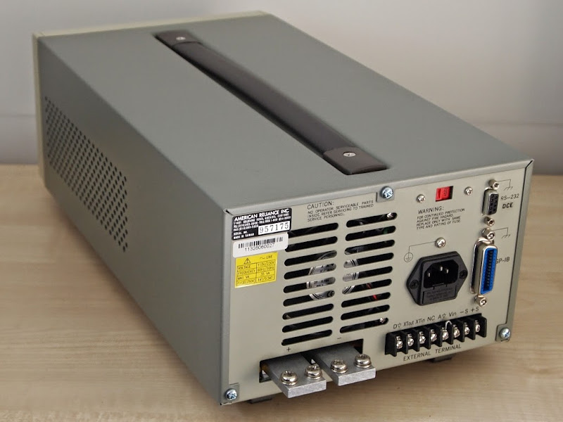

I'm surprised I haven't seen a thread on this already.  I bought one of the notorious $89 loads from eBay, and was one of the people who were lucky and got one.  Mine seems to have been manufactured in 1997, so it's weird that it sat around in its box until 2014 before being resold by a surplus outlet.
My one works nicely, apart from having a small (~-45mA) fixed current offset.  I might try and recalibrate it at some stage, but it will be a bit of a hassle to get together everything required.  It's a good instrument with a lot of features.  The stand out feature for me is the ability to set the slew rate on programmed transients.  So not only can you tell the supply to switch between a load of 1 and 2A at 10Hz, but you can tell it to change between those two currents at a rate of 500mA/us.  Lots of loads don't have that.
It's constructed of folded steel sheet, with a mainboard taking up most of the base of the chassis.  The power is dissipated into an aluminium tunnel heatsink with fans at both ends (fairly loud when on, not temperature controlled).  Two riser boards plug into the mainboard, a DAC board and a CPU board.  The power transformer is chassis mounted at the front of the unit.
Each IRFP250 MOSFET seems to be part of a local loop, each has its own AD712 dual opamp and shunt.   The shunt is made up of a large loop of enameled wire about 2.9mm in diameter, possibly copper, but possibly something with a better temperature coefficient.

This image shows the area where I found a really bad assembly defect with my unit.  The GPIB ribbon cable (wide, grey, far left in image) was folded wrong and pressed hard into the back of the IEC connector.  Nothing was punctured, but the insulation on the GPIB cable isn't mains rated, and could have worn through over time.  A short between the GPIB interface and mains could be an injury hazard, and well as being catastrophic for the unit and a connected GPIB controller.  Easy to fix though.
The front of the mainboard has the power supply.  It's pretty simple, a couple of rectifiers, smoothing capacitors and linear regulators.  Despite the huge heatsink, this unit doesn't actually need much power of its own to run.  There will be two isolated supplies in this unit, an earthed outguard supply for the CPU and GPIB sections, and a floating inguard supply for the actual load.  There's no electrical connection between the two.
