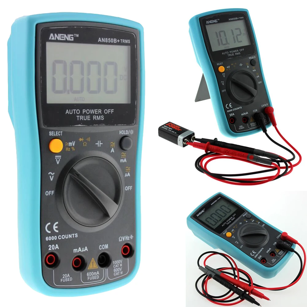

I received one of these meters about a week ago and feel rather indifferent about it. The first thing that hits you is that it is tiny. If you are used to holding a chunky Fluke in your hand, this thing feels minuscule .Dave's video on this meter is bang on.
Take a look at the ANENG DT850B+. It's as big as a Fluke and has all the features that are missing on the AN8008 for only $20.
(but not real input protection...)
