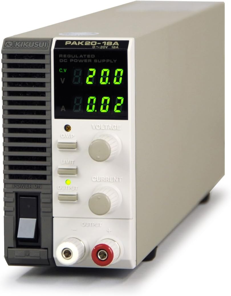

Take a look at KIKUSUI PAK power supplies, they're very very powerful in a very small package. I've a 20V 18A and is the size of a "pound cake"
The following users thanked this post: lots o tots
They do look quite appealing.  I just need to wait for a good deal.
