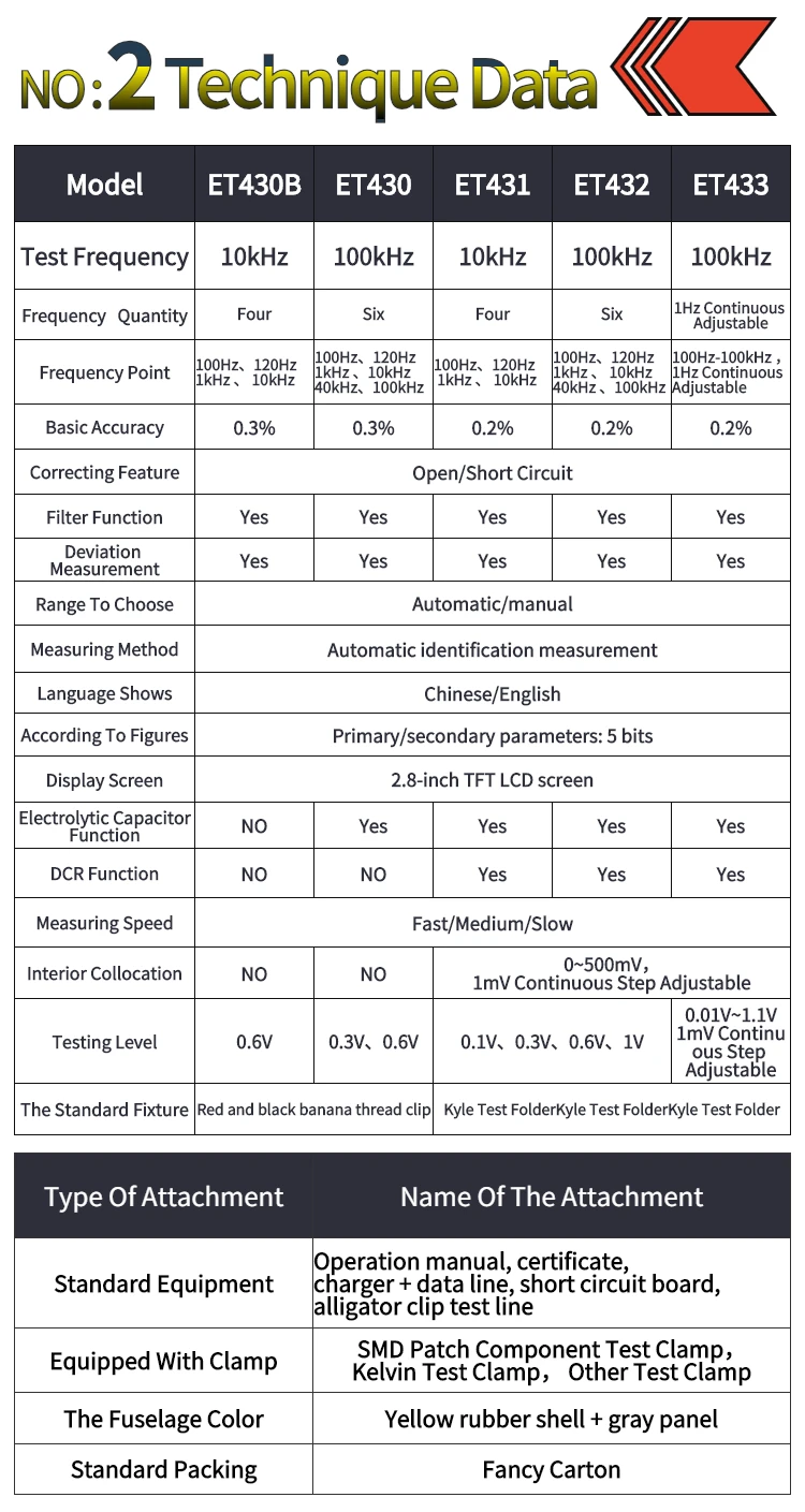

My Hantek 1833C supports 0.3V and 0.6V test voltages. As I recall the highest-end Uni-T 622 and EastTester (don't remember model#) handhelds support any test voltage in 1mV increments up to I believe 1V.

My bad, apparently my recollection was wrong. However the East Tester ET433 does support 10mV-1.1V in 1mV increments.

At USD prices the Hantek 1833C and DE-5000 cost around the same ~$140. I chose the 1833C over the DE-5000 not so much for functionality improvements (I don't think I'll ever use ALL of those extra frequencies) though I do use the different test voltages, and do wish it had an even-lower 100mv test range to avoid issues with in-circuit Schottkies. My main concern with the DE-5000 was the poor UX that many people described. The UI+UX of the Hantek is quite good IMO and I'm happy with it.
If I were buying another handheld in the <$300 range I'd probably go with the Uni-T 622E or ET433 to get the additional test voltage capability. But likely my next LCR meter will be a bench model.

for the voltages, you need less than 0.3V not to activate any schottky component on your board. if you don't have any, a voltage less than 0.6V is ok, again not to activate any semiconductor on the board. so the in-circuit test is more accurate.
for the frequency, 100Hz 1Khz and 100Khz are enough. I don't see the interest in other frequencies for esr testing.
